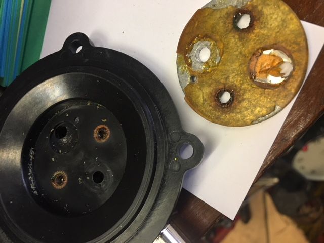

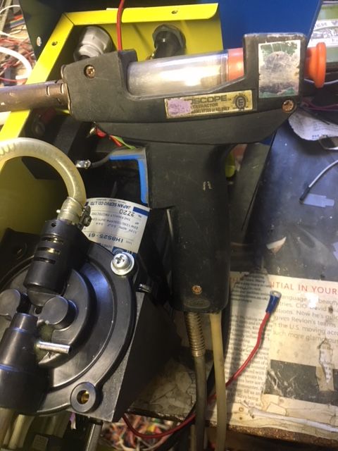

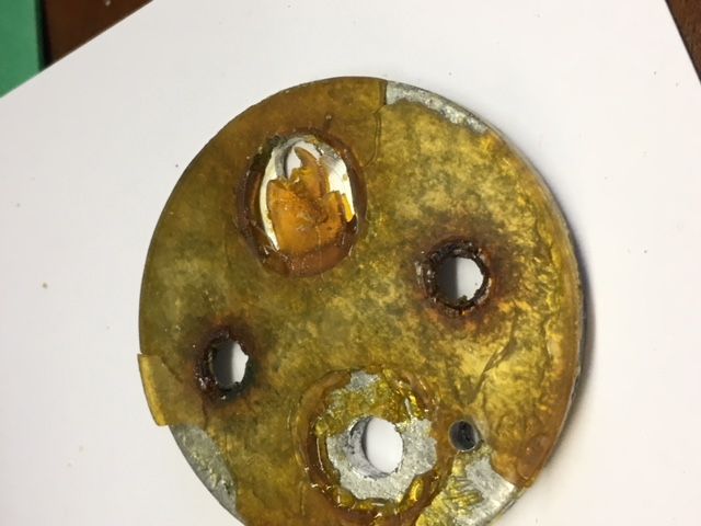

        I have a de soldering station which uses an inbuilt diaphragm vacuum pump. Unfortunately the valve material has perished so its just crumbled away.
        Can anyone suggest a suitable material to make a valve from? Its about 2mm thick.

          Silicone rubber sheet 1.6 mm thick will likely work very well. The link below is to one US supplier that offers it. Note that you will need smooth finish sheet for good sealing – there is one kind of silicone sheet with a fabric- like finish, and the smooth kind.
          https://www.mcmaster.com/5787t31
          There are UK suppliers – look under gasket and seal suppliers. Good luck.

              EPDM rubber sheet will work good upto -1000mb – we use it on some plant I work on with no noticeable problems

                    It looks rather as though the backing metal plate is coated with solder. This won't have helped keep the soft valve sheet in good condition. Is it possible to add eg a sheet of stainless mesh between the inlet and this valve? This might intercept some at least of the solder (and it wont usually stick to stainless).
                    In fact it would be a sound plan to renew the metal plate (with polished stainless) so the new sheet of silicone has a flat surface to close against.

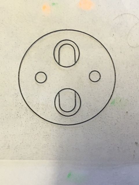

                          Yes I got it going after I remembered that I had some 1mm roofing grade rubber in stock so made a valve out of that. Experimented unsuccessfully with different style valves before copying the original.
                          I drew the shape then printed the image onto film, selotaped together and then cut it out with a scalpel. I found it difficult to get the shape neat and shown is a practice valve with larger holes for the clamping screws to adjust the position.
                          There are a couple of felt filters in line to stop solder ingress also a glass tube to collect it. Works quite well, hope it continues! To get one I had to buy 2 so got a spare I dont need and intend disposing of it soon.
                          Quite well made (and heavy) apart from the valve material!
