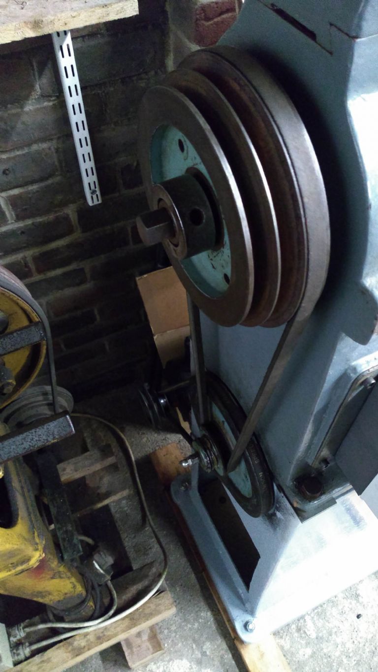

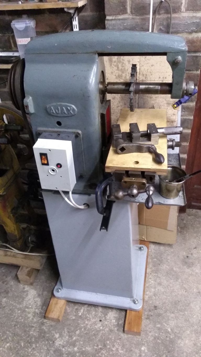

      I recently purchased an old Ajax AJ8 horizontal milling machine in remarkably good condition for not a lot of money. I have since fitted a replacement motor and used the machine with good effect but there is a niggle with belt vibration. There is no vertical head, so everything is done on the horizontal spindle.
      The machine has two v-belts, one from the motor to a 2-step pulley and the second belt to the main cutter spindle. Both belts are in my opinion correctly tensioned. All bearings are good, lubricated and tooling sharp.
      When using a moderate size cutter (e.g. 5" x 1/2&quot I have noticed some vibration developing in the "slack" side of the final drive belt and this significantly adds to workshop noise. The whole machine is sufficiently heavy that the cut quality appears unaffected. I am mostly milling mild steel, with some cast iron.
      I have considered adding an idler pulley to the problem belt, thus shortening the distance between centres as I think this should eliminate the problem. However, before I attempt this fix I would welcome any other suggestions.

                I could consider doing that, but would like to know whether the vibration (using v-belts) is typical with similar machines. My gut feeling is to shorten the "slack" side with an idler pulley would significantly cut down on vibrations and could be a quick fix.

                  Currently a 3/4 HP single phase motor but I do have a spare VFD and had originally planned to install a larger 3 phase motor. It's easy to swap the motor as it is now mounted on an adjustable mounting rail. However, the 3/4 HP appears perfectly adequate so far.
                  The belt moves approximately 10mm under a force of 10N.
                  The two pulleys measure 70mm / 200mm with a distance between centres of around 430mm.

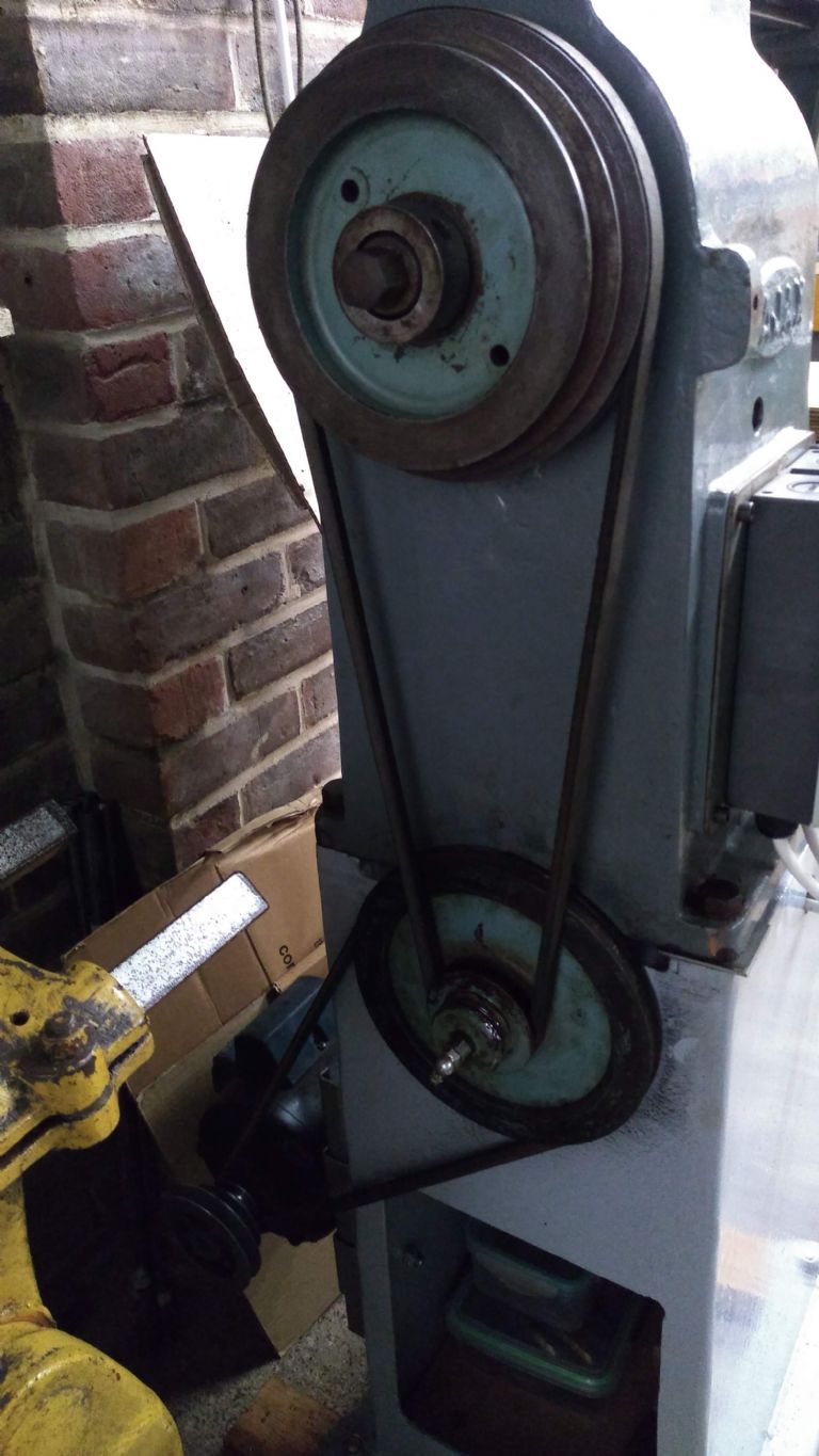

                    There is no significant vibration in the motor drive belt. Incidentally, the motor drive belt is easy to adjust as the motor is on a sliding mount.
                    The second belt (driving the spindle) runs between two fixed pulleys with no adjustment and that is an additional reason for adding an idler pulley. This belt is long and relatively low speed, whereas the oscillations are relatively high frequency and relate to the cutter being used (6" 18 tooth) and not a "hump" or two in the belt. However, I did try changing the belts with no improvement. I also considered changing to a link belt (as used on my Denford lathe) but doubt it would offer any improvement unless able to absorb the "shock" of the cutting action.

                          I have just created an album for those not familiar with this machine.

                                      The intermediate jackshaft is a fixed stub welded to the milling machine base. It appears to be original and offers no form of adjustment for belt tension. The belts are currently set up for best alignment giving a driven speed of approximately 120 RPM. With a 6" cutter that equates to a cutting speed of 57.5 ms-1 which does not seem excessive.
                                      I agree that the coarseness of the cutter is contributing to the vibration, but should point out that when several teeth are engaged with the cut the machine handles the task very well.

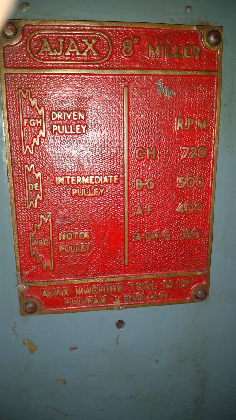

                                        Edit: except to claim the prize for spotting the typo on that belt-settings plate angel

                                          On the assumption that the machine didn't vibrate when new the question is why is it doing so now? Poly V-belts may be better, but they're a red herring while the source of the vibration is unknown. A few ideas are:
                                          A 10mm deflection for 10N (1kgf) force seems pretty slack to me, especially on a long unsupported belt. None of my V-belt driven machine tools have a vibration issue, and none of them have idler pulleys.
                                          The second belt looks a bit odd; is the top pulley in line with the intermediate pulley or should the belt be one pulley further out at the top?

                                          What rpm is the cutter running? Looking at the speed chart the lowest value of 150rpm is on the fast side for a 5" cutter in steel.

                                            “except to claim the prize for spotting the typo on that belt-settings plate”
                                            And, according to the plate, the top belt should be aligned with the “E” pulley? So someone has moved the top pulley outwards, to achieve the lowest speed possible? Or is the top belt mis-aligned? Plot thickens.

                                              At the traditional cutting speed for average mild steel of 100 feet/min, a 5 inch HSS cutter should run at 80rpm. And a 6 inch cutter should run at 66rpm.
                                              So the machine's lowest speed of 120rpm is way too fast for that oversized cutter if cutting steel
                                              120rpm would suit a 3" cutter.
                                              If you want to use that large cutter on that small machine I think you are going to have to live with the vibration.

                                                That cutter has a hell of a bite looking at the width.
                                                The load can vary between one and two edges cutting at any one time, I suspect the chip load is quite high and so the belt flaps as the load changes. My Centec on a 3"dia 3/8" wide cutter has the same issue on steel but much less on Alu.

                                                      Now there is a picture,the mill small and not up to 5 by 1/2 cutters, where the arbour enters the arbour the diameter appears reduced so to myr eckoning ,the taper is probably 2 MT,too small for a large cutter ,now when milling the golden rule is support the arbour, unless the work or the vice gets fouls the arbour or the column , get the cutter as close to the column is possible and then amount arbour support as close to the cutter as possible. on big mills and heavy work,more than one arbour support is used either side of the cutter, and then there is usually a tie bar from the top arbour support down to the knee,.Just think,that mill is about eqvivalent to a 5 inch lathe say a Boxford, would any one try using a parting tool a half inch wide !! because that is what is being tried on this small mill.with the wide cutter. This is not a belt problem ,apart from requiring a means of tensioning, its just hammering a small machine to death,plus the speed range is far too high,4 inch dia cutters about 3/16 or a 1/4 wide should be its maximum, capacity,in ally or non ferrous and a bit less in steel.
