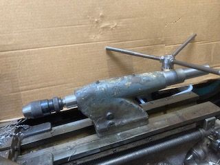

        Just to pass the time between wishing the in-laws bah-humbug, I've been converting the tailstock of my S7 to be rack operated. Thus:
        Excuse the paint job (lack thereof) – it is 70 years old.

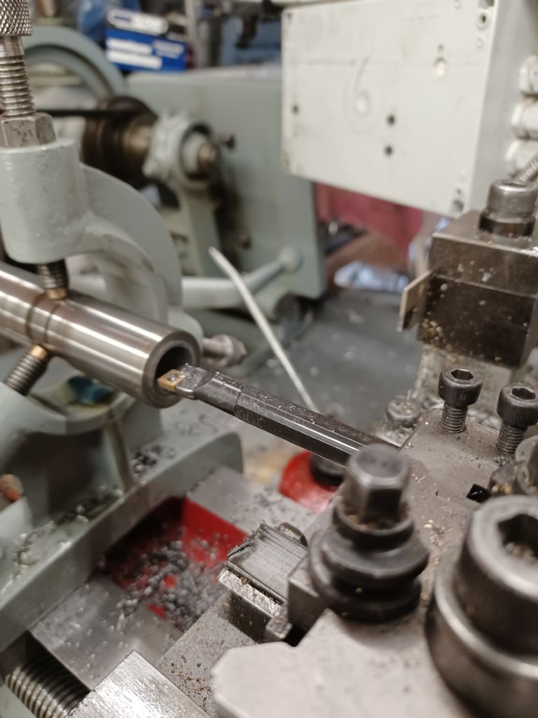

        Almost the last operation was to cut a no 2 morse taper socket in the inboard end of the new tailstock barrel. I drilled a 14 mm hole to clear out most of the material, then bored an undersize taper of very nearly the correct angle to make sure the socket would be true to the OD of the barrel. So far so good.

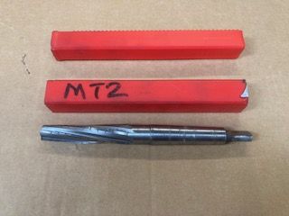

        I then introduced my one and only MT2 reamer into the mix. I've tried to bore MT2 sockets before using the compound slide, but found it is very difficult to get a truly linearly tapered surface.
        Here's a picture of the reamer. It's far from new, but I thought I'd give it a try.
        As you can hopefully see it's the type with a solid MT2 shank, and with serrated flutes. I'd assumed this is to make it cut more freely.
        I was surprised how quickly the gullets filled up with swarf. Am I expecting too much to use this as a metal removal tool rather than a shaping/smoothing/trimming tool? By the way the barrel material is EN32, so mild steel but with no free cutting properties worthy of the name.

          When i make them i just drill to the small end diameter and then slowly let the reamer cut the whole taper.
          lots of cutting oil and very small increments of travel < 1mm the flutes fill rapidly and withdraw and a toothbrush to clean the flutes rinse and repeat

            The reamer shown is a 'roughing' reamer and yes it can be sharpened as you describe, I personally would just leave the minimum amount of metal for the reamer to bring the socket to size. I will try to find my MT2 finishing reamer last used for the one and only time 40 years ago. Ah looks like there is conflicting advice already.

              I would aim to bore this taper, with TTA if one is a available, but it can be done with the topslide set round.

                I have only made a male MT2 and even with the taper turning attachment on the Smart & Brown model A, the exact taper was found by trial and error using a MT2 socket as a gauge. You have to be within a second of arc or so to get a properly matching taper. To get the best female taper, I would rough out the bore as best I can and use the reamer for final perfection. I know that there are roughing and finishing reamers for Morse tapers, but have not ever bought one. The tailstock quill was not very good on the S & B and I found somebody selling them on ebay cheaply NOS and took a chance with one of the same OD. It was not for a model A, but the backlash nuts were the same. There was no extraction slot as this quill was intended for self extraction, a slot was milled to save strain on the nuts and new engraving was done tp suit the lathe. I have kept the original quill and might ream it if a reamer gets bought for another purpose.

                    I recently made a new tailstock quill and the only way to guarantee it to run true was to bore it with the top slide set at the correct angle, supported by the fixed steady and then finnishing it with a Morse taper ream.

                      To assure parallelism and centre height and I would put the drill in the chuck to "roughly" step bore the taper using different drill sizes and feed by using the tail stock. If you don't have the right drills, you could use a boring head. Then use the reamer to finish the job.

                        A serrated reamer is a roughing reamer, used mostly for production work. You need a plain finishing reamer to finish the job. I would bore the taper to within a couple of thou to ensure concentricity then finish with a finishing reamer. Try it out on a test piece first and see how it goes before doing the real job.

                            Usually the serrations are offset to each other, so that when the reamer is held at a set position and the reamer has done more than 1 turn at that depth, there will be no serrations or grooves in the finished work piece. Any material taken out before the reamer goes in, is a bonus. It really needs to be all concentric as possible. You can always bore it close and then use the reamer for the last bit to get the taper into the correct MT2 range.
                            Yes those flutes will fill very fast. If you already have a through hole, use a wetvac on the end to draw away the swarf being generated, and it also will draw any coolant through as well.

                                  Many thanks to all the replies, we seem to have established that my reamer is a roughing one and it's no surprise that the chip clearance needs a whole lot more care. Good stuff and thank you.

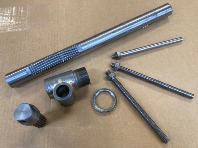

                                  Here are the individual components:
                                  The body "casting" is two tubes bronze welded together, so the "bite" out of the side of the bigger one sets the centre distance of the pinion against the rack. Otherwise the bits are fairly simple. I chose the pinion to be 15 teeth and DP20 as this makes a full turn very nearly 60 mm travel.
                                  #631208
                                  David Davies 8
                                    @daviddavies8
                                    Simon
                                    Thanks for showing the component parts, you have made yourself a very useful bit of kit!
                                    Cheers
                                    #631217
                                    Hopper
                                      @hopper
                                      Very nice bit of work there. And a very handy attachment.
