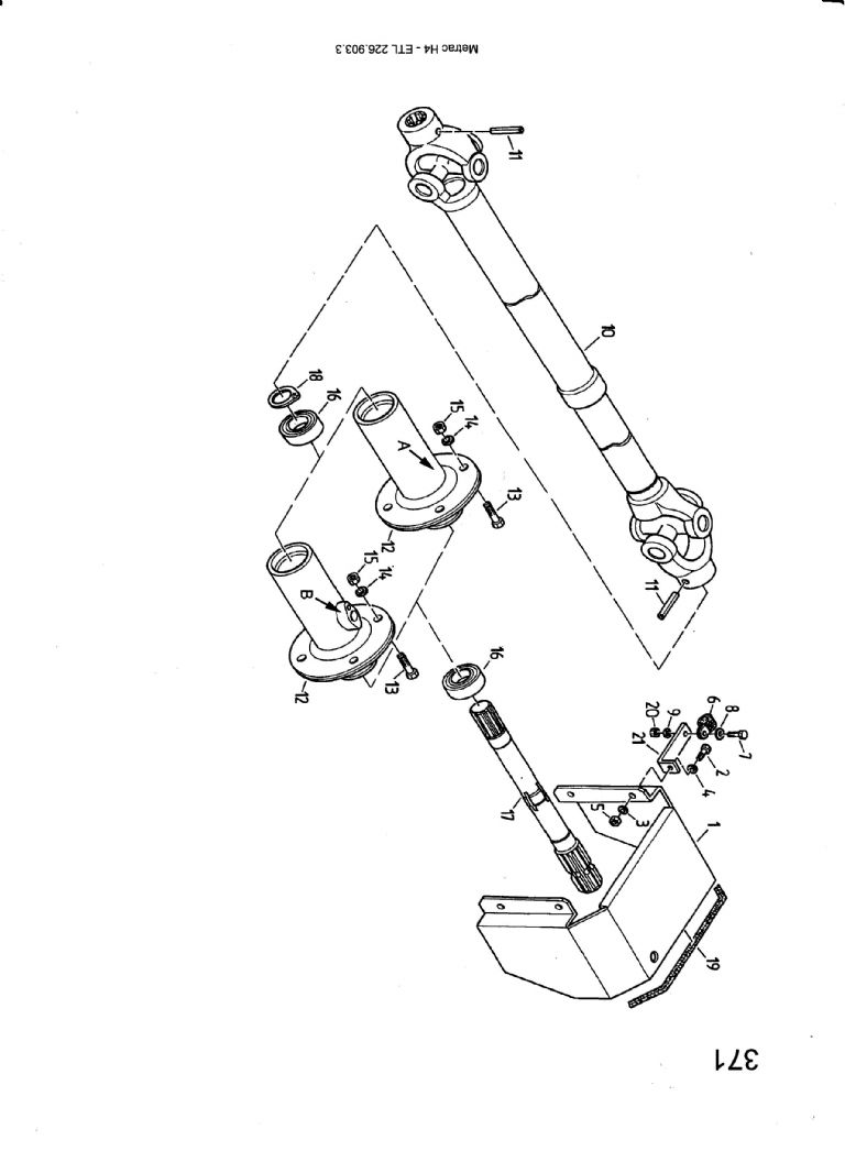

                  I've sort of got the answer I was expecting – I haven't done the maths but I would expect aligning the yoke parallel would give the best cancellation of the angular velocity variations. However here is a re-print lifted straight out of the parts list for the machine in question.
                  Which clearly shows the yokes at right angles. Don't know why.
                  I've had this shaft out on a previous go-round, and I'm pretty sure its got a master spline so it will only assemble as shown. I think I'm going to have to just accept that I don't understand.

                    According to Wikipedia and Robert Hooke, you are all wrong and the drawing is correct:
                    " The universal joint, one of the earliest means of transmitting power between two angled shafts, was invented by Gerolamo Cardano in the 16th century. The fact that it failed to maintain constant velocity during rotation was recognized by Robert Hooke in the 17th century, who proposed the first constant velocity joint, consisting of two Cardan joints offset by 90 degrees, so as to cancel out the velocity variations. This is the "double Cardan". Many different types of constant-velocity joints have been invented since then. "
                    en.wikipedia.org/wiki/Universal_joint#Double_Cardan_shaft
                    My bold…

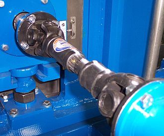

                      I'm more than somewhat confused by this now – Neil you are right in quoting the link you have used, and it says what you say it says, but…
                      Along side the text is this picture, which kinda speaks for itself.
                      There is also another paragraph later which says :
                      A double Cardan joint consists of two universal joints mounted back to back with a center yoke; the center yoke replaces the intermediate shaft. Provided that the angle between the input shaft and center yoke is equal to the angle between the center yoke and the output shaft, the second Cardan joint will cancel the velocity errors introduced by the first Cardan joint and the aligned double Cardan joint will act as a CV joint.
                      (My italics)
                      Duh!
                      x

                        In-line is the common automotive practice, or was when cars were rear wheel drive and you could see the U joints clearly. A google image search will confirm this.
                        You can't rely on parts drawings. They are illustrative only. And if you look at the drawing above, it has in two places the squiggly lines that indicate the the shaft has been "cut" and shortened to fit in the space available so one end could have been deliberately rotated 90 degrees for the sake of illustrating the other side of the U joint in one view.
                        And Wikipedia is written/edited by the same kind of people who post on internet forums ( laugh )so must be taken with a grain of salt.
                        This https://vibralign.com/shaft-alignment/understanding-offset-shaft-alignment/
                        from industry experts Vibralign is more athoritative and calls for phasing to be inline.
                        Edited By Hopper on 02/10/2019 23:56:04
