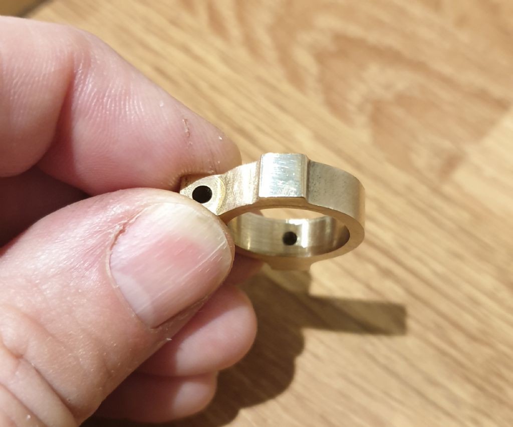

        One for beginners maybe…. may have already been discussed mind…
        I drilled a hole in the wrong side of my S50 eccentric strap (No idea how!!), and rather than scrap it, and replace (I'd already ruined the first one – this was what was left!), I repaired it. I made a 7BA brass grub screw to fill the hole, and silver soldered this in place. It's not fully cleaned up yet of course, but the repair is 98% invisible
        This is my first build, and still learning lots of course. Re-machining another cylinder casting is next… I could probably get away with the one I have made, but I'm undersized on the flanges after trying to clean them up.
        Anyway – Might be useful to someone?

        old mart
          @oldmart
          Good repair, if you hadn't described what you did, no one would know as it is invisible.

                Lainchy
                  @lainchy
                  Thanks chaps
                  I did wonder about just fitting a short 7BA bolt, but I'm sure it would have annoyed me. Lesson learnt though!

                  Neil Lickfold
                    @neillickfold44316
                    Another option would have been to have made a rivot. Made from the same material is almost impossible to see as well after being peened in place.

                      not done it yet
                        @notdoneityet
                        If you want to see how it can be made completely invisible check out ‘clickspring’ on youtube. He does it often – not as a repair but as part of the build – although maybe not on anything particularly load-bearing.
                        All the same, your repair looks good and it may not be noticeable unless searched for. Might even disappear more when you get it really polished up.
                        You can always come back to it at some later point in time – and even replace it if you must – but carry on and get the first build done dusted and operational would be my mantra.

                            Tim Stevens
                              @timstevens64731
                              If you are likely to get into this sort of repair in a regular fashion, you might look at the range of silver-solder colours. CUP would be a start, perhaps. The lower silver content (which brings the price down) tend to be more brass coloured. But that said, they don't always mellow the same as brass as the patina takes hold – so you might rediscover your repairs in 30 years time …
