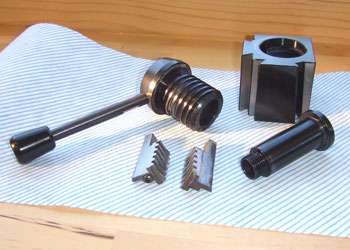

                              Thanks Jason but neither are options for me. The lathe was delivered brand new on Wednesday so I want to keep all original parts as is for the warranty period just in case. Thus machining down the boats at this stage is not an option. The QCTP has a centre boss that screws in between the securing stud and the taper jaw release screw. Boring out the bottom of the QCTP would move the thread that boss screws into would destroy the QCTP.
                              Not my photo but it’s the same QCTP. The boss is seen bottom right.
                              tpinbits
                              #810740
                                In that case I would say live with the lathe for a couple of months and see how it performs.
                                If something is going to rotate the lost likely is the QCTP as it is just the one central fixing and a small contact area. The topslide has two fixings a lot further apart and a good area of contact. At least that is what moves on teh 280 if I do soemthing silly.

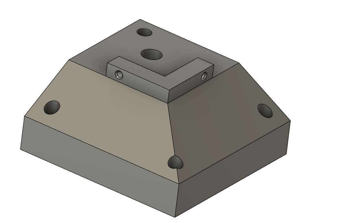

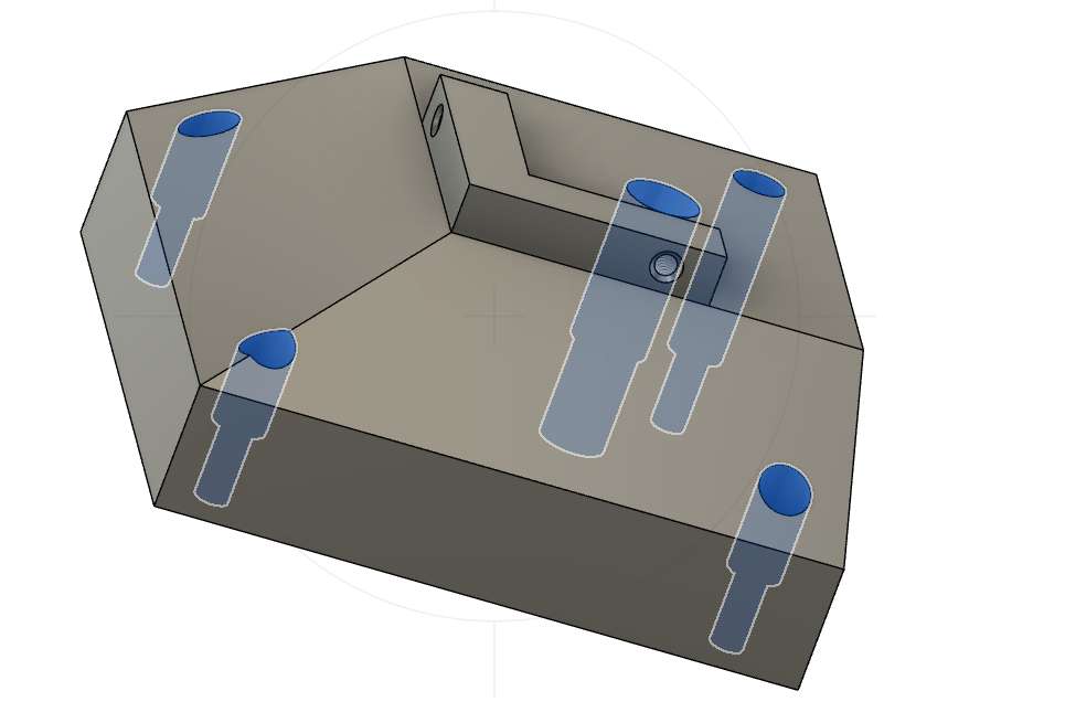

                                          I am planning much the same, as per the attached sketches.
                                          ToolPostBlock2ToolPostBlock1

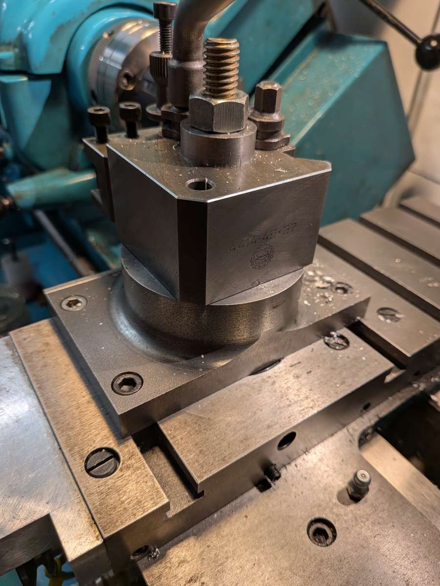

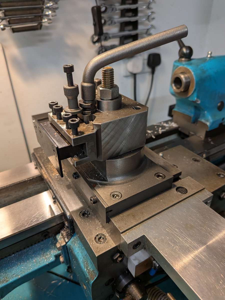

                                                <p style=”text-align: left;”>Good idea to eliminate the top slide except when you need it. I made an adapter for my Super 7 CNC conversion from a lathe backplate casting from RDG IIRC. Especially useful if you have a DRO and want reliable tool offsets.  I also added an anti rotation dowel.</p>
                                                PXL_20250804_211347878PXL_20250804_211400831
                                                #810869
                                                Bazyle
                                                  @bazyle
                                                  John’s pictures rather point to just fabricating something from plates reducing cost and weight. Even “mixed mode” with a baseplate of alloy.
                                                  #810895
                                                    Having those two pieces to take horizontal screws to lock the toolpost into position is likely to result in a greater need to swap to the top slide as at least in my case the need to set the QCTP at an angle cones up quite a bit to get a tool to clear the work or chuck.
                                                    If you do feel the need them maybe have a “L” shaped piece of steel that can be screwed down into the top of the block so at least it could be quickly removed, will also make machining that tight internal corner easy as a bonus.
                                                    If you are putting so much force into the cut to rotate the QCTP then you are pushing the lathe and also if you do have a crash what will give if the tool simply can’t move away from the chuck or work?
                                                    There was a thread a month or two back about making a similar block, your design which puts the tool towards the headstock side of the cross slide will result in needing to extend the tailstock barrel ecsessively when using tailstock support if the gib screws are not to hit the tailstock base. So less rigid wher eit counts more. maling that “L” separate you could then rotate the block 90deg which would put the toolpost further to the right.
                                                    Design Advice!- Warco GH600 Solid Topslide
                                                    Do you have a DRO fitted? if not how will you put on a small cut, eg if you measuer a part in the chuck to be 0.1mm longer than needed how will you put on a 0.1mm cut. The carriage handwheel dial is useless for this having very large divisions. If you do have a DRO then even more likely to need excessive tailstock projection.
                                                      An excellent point I had not considered, thanks Jason. I will redesign it without the L shape and see how it goes. If I do find it is required I re-machine the block to add a bolt on version.
                                                      Re the offset, I have deliberately spaced the 4 mounting holes at 100mm centres to allow the block to me rotated with QCTP offset to right front, right rear, left front, left rear as required.
