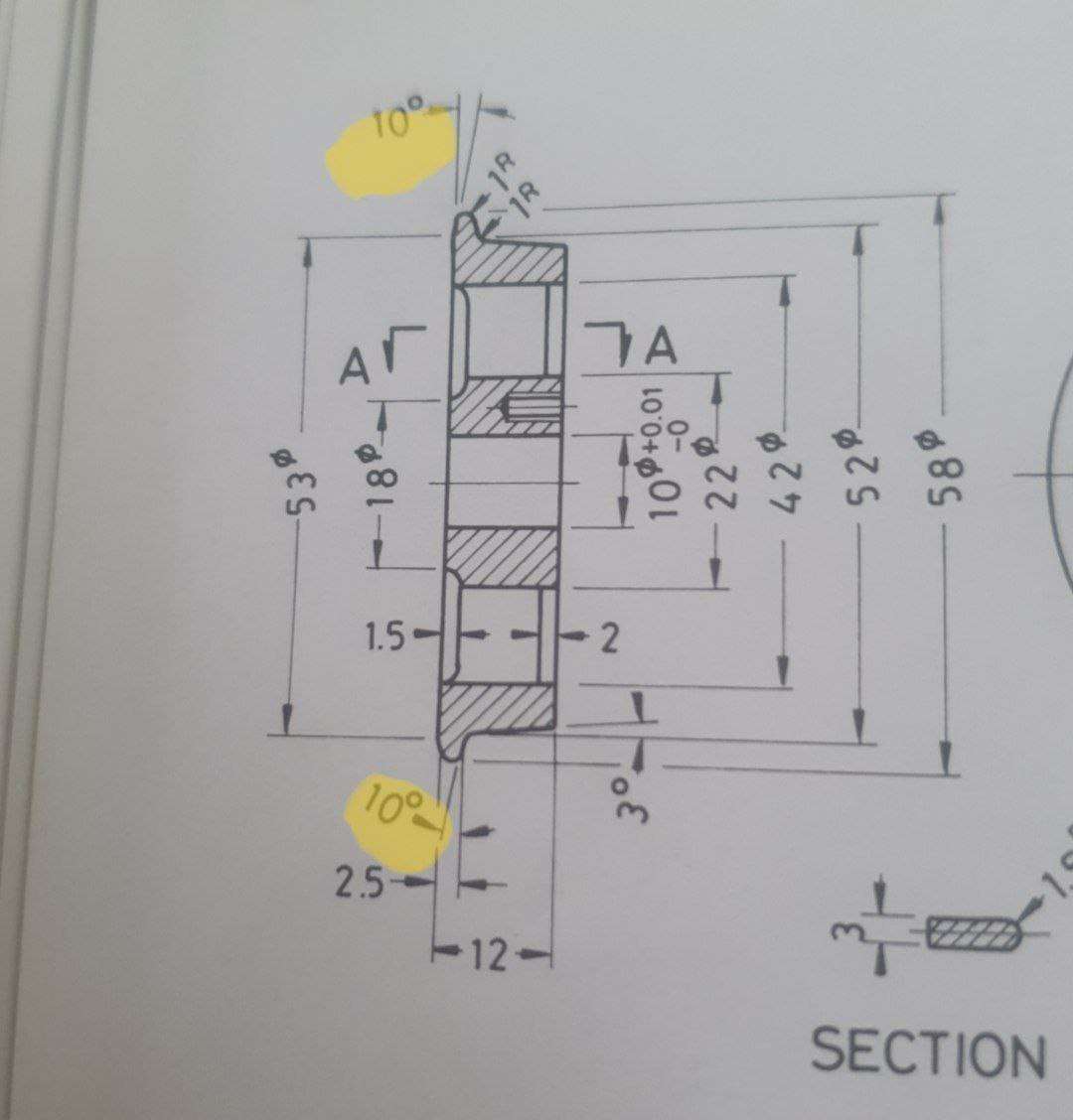

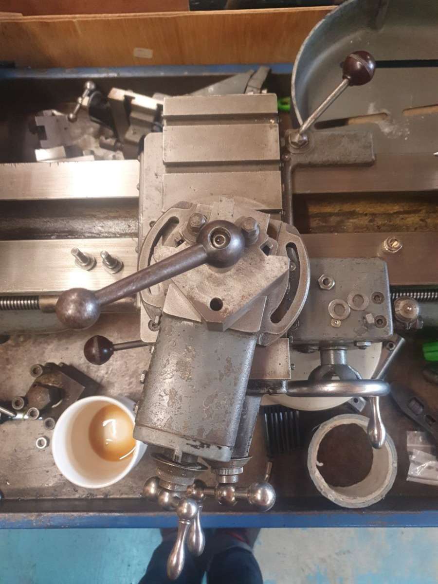

      It’s a year later and I’m finally getting around to completing the wheels for my Shay project, but I appear to have run into an issue.
      I’ve completed every feature other than the taper on the flanges – the drawing says these should be 10*. However, I don’t appear to be able to arrange the compound to actually cut such an angle. Anything past ~45 degrees or so and the clamping slots “fall off” and there’s no way to secure it.
      I’m sure I’m missing something obvious as i’m not the first person to make locomotive wheels on a myford, maybe I need to make a forming tool with the correct angle built in?
      Any advice would be greatly appreciated.

        The chamfer is only 2.5mm wide, for the inside I would use a flat faced tool set at 10 degrees. Make sure your gibs are set tight to prevent chatter. Similar for the inside taper but have a 1R radius on the nose.

          Tool with the correct nose radius and the flank set at 10 degrees. I know it works for cast iron wheels on an ML7 because that’s how I did mine, and they had a bigger nose radius. Lock the saddle and make a note of the dial readings so they all come out the same. Not easy to measure the diameter on a taper.

              The 10 degrees on the inside is not important.

              I’ve just experimented with my ML7 to verify what it can and can’t do.
              Th tread angle is the important one, and consistency of taper and diameter is much more important than the angle value (within reason). The top-slide will handle that.
              For the flange, as others point out, simply use a form-tool.

                  Ah – my lathe does not have those but I have seen them elsewhere.
                  Do they allow the T-bolts to engage the slots in the cross-slide when the compound slide is turned through 90º?
                  If so I think they are for use with the Taper-turning Attachment, allowing the compound slide to be used directly for the depth of cut while the cross-slide is being driven by the attachment.
                  The cross-slide screw and nut are removed for taper-turning, with the secondary effect of allowing the top-slide to swing round without obstruction, but putting its quadrant slots off the edges of the cross-slide.
                  So those two branch-slots then allow the T-bolts to move inboard and enter the slide slots.
                  For lathes without those branch-slots the compound-slide is set at a steep angle but you may need account for the axial movement of the tool as well as its radial movement being less than what the dial reads.

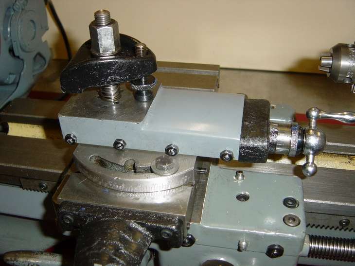

                      Im not sure those cutouts on the curved slots on the late model topslides will allow you to rotate the topslide any further than the earlier plain curved slots. They might still be hanging out in mid air either side of the cross slide table? And there is no T slot in that central location in line with the pivot hole that those cutouts would align with?. I think those cutouts may be just so you put the T bolts in them when the topslide is in the standard 0 degree position (ie parallel to the lathe bed axis) to get them out of the way of some jobs and tooling. I’ll have to check it out next tiem I am in the shed.
                      There have been articles over the years in ME/W and some of the old boys’ books about making two little outriggers that attach to the sides of the cross slide with studs that stick up so you can rotate the topslide and clamp it down at either the 90 degree position for taper turning attachment use, or even to the 60 degrees (from lathe bed axis) position for screwcutting. Some of those “outriggers” attach via clamps in the cross slide T slots. Others may require some drilling and tapping of the sides of the cross slide. It’s one of those “worthwhile little projects” I have thought about making for years but never got around to it, as I leave the topslide where is for screwcutting and use the advance-it-by-half-of-cut-depth method.

                        Can you make an intermediate plate of say 6mm/¼” steel to put between the compound and cross slide and lower the tool to suit? Alternatively can you clamp the compound to the T slot with machine tool style clamps?

                          A good point. When I replied previously I did not think to test if there are T-slots in line with the pivot.
                          The standard top-slide will rotate sufficiently for angled feeds in screw-cutting because you rotate it by half the thread’s included angle, and it would be a very odd thread indeed whose half-angle is >30º.
                          At 45º you are looking at the Buttress Thread, as that is the longer flank’s angle to the axis. Though it would not be easy, and cutting high-lead threads of any form is unkind to a Myford-sized lathe.
                          Martin –
                          You could make an adaptor-plate as you suggest, though 1/4″ is a significant loss of tool-setting height on a small lathe, and loses most of the pivot engagement. You also need consider if the slide will still rotate enough without its own hand-wheel and dial striking those of the cross-slide.
                          If the Tee-bolts need be outside of the cross-slide edges, or are replaced by studs, the plate could be reduced to 1/8″ but obviously still needs be flat on both faces. Gauge-plate may be a candidate. Another option is to machine a thicker mild-steel – or even aluminium-alloy – plate all over and bore a 1/8″ deep nest for the slide’s underside, including the flanges. This will also tend to stiffen it slightly.
                          Clamps? No. For a start there is nothing for the lower jaw to engage safely anyway.
                          Much more seriously, it would risk breaking the slide or Tee-slot flanges. They are castings designed to be compressed over their full areas to a machined surface, not loaded in cantilever form.

                            I usually do mine with a triangular carbide insert – using it as a form tool.  Odd, isn’t it?  I usually do the other two tapers as a “properly turned” taper and do the rear taper with a form tool – the opposite of what others have told you (and which ignore the fact that you have to have the ability to grind the correct from tool for doing the flange and rim tapers in one go – perhaps they haven’t done railway wheels before)!
                            The carbide tools I use have one angle set at 25 degrees, so I only have to set the topside to 15 degrees to do the job – obviously, it depends on the geometry of your own tooling.

                              I think I’ll look at setting a flat tool to the right angle first and see how I get on, at the very least they’ll all be the same if not quite to the plans – at least the treads are correct.

                                For angled in feed you rotate the top slide to (90-half thread angle), and ML7 won’t do it.
                                Without a tool post, the distance from top of topslide to centre is plenty to allow a 6mm plate twixt topslide and cross slide, although I never felt the need.
                                If you look at SMEE wheel standards they don’t have the taper on the inside, I think this must be a Kozo special. I’d stick to SMEE.
                                Trying to make a form tool to do the whole profile in one go is not going to work on ML7. As I said before, you want a tool with the correct root radius and the leading flank at the correct angle.

                                  thanks duncan – yes that’s what I was going to look at doing. I haven’t the skill or tools to make a form tool so small to do it all in one go anyway, even if the lathe could handle it. I have a box of HSS tools of various shapes and sizes, i’m sure one of them will be suitable.

                                  Hopper
                                    @hopper
                                    On Nigel Graham 2 Said:
                                    Hopper –
                                    No,the standard top slide needs to rotate 60 degrees from its normal position to get the 30-degree-from-perpendicular position needed for screwcutting. Cant be done on a standard Myford 7. (But the ancient mighty Drummond M-type will do it!)
