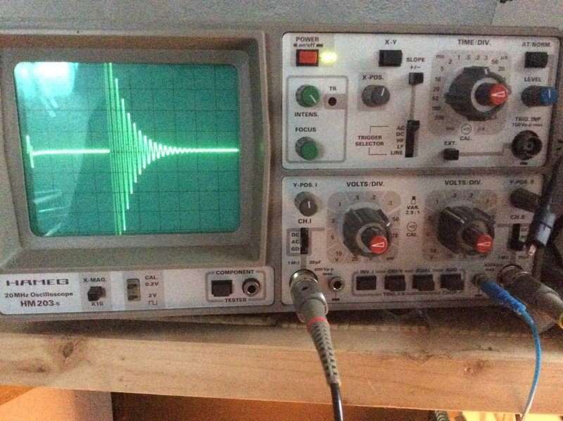

                          I have a home built set up using my oscilloscope to do what is termed a “ringing test” to check for shorted turns. So I at last dug this out and checked the motor windings. Result, no shorted turns.
                          Andrew.

                                  That sounds good, can you describe how it works please?
                                  If it’s like a TDR, it should be able to distinguish visually between: an open circuit; short circuit, and intermittent connection.  What does the scope display?
                                  The resistance readings and motor not heating up both suggest an intermittent connection rather than shorted turns.   Could be corrosion, damaged wire, faulty thermal cut-out, or a dirty start/run switch.    Probably more!
                                  As a good spare exists, and it’s certain the motor is defective, I suggest a post-mortem.  Open it up and have a thorough look inside.  Lots of gory pictures please!

                                    I built a simple one that pulses the windings and uses a shift register to count the rings, displaying the result on LEDs. It’s better at comparing two windings, since you may not know how many rings to expect.
                                    You can also scope the output. I think this is an SMPS transformer primary.
                                    IMG_0799
