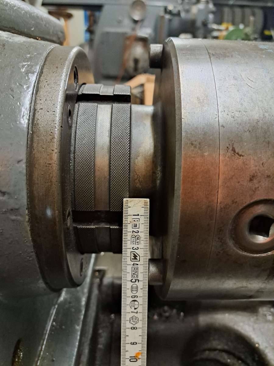

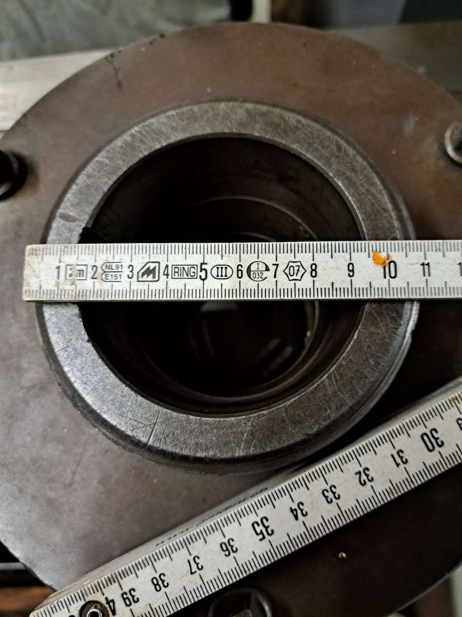

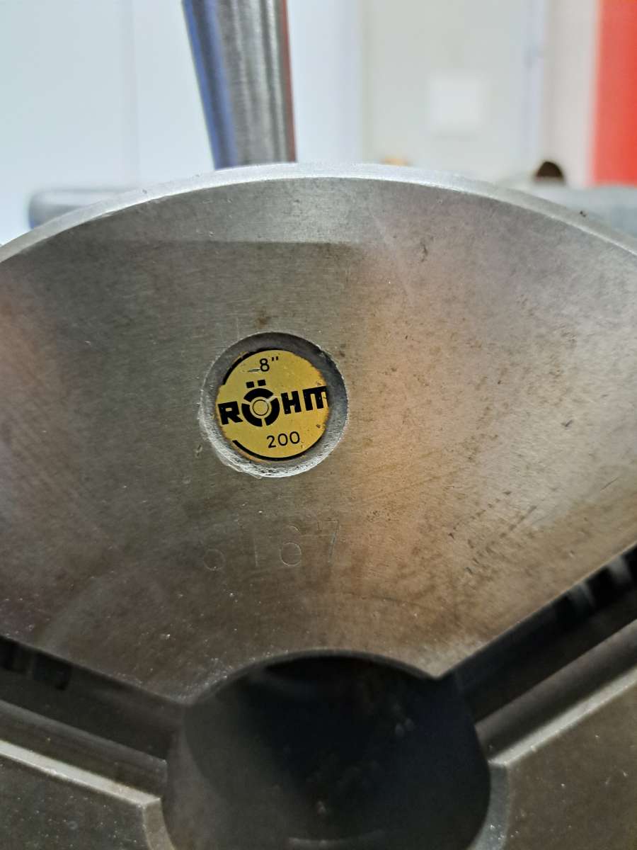

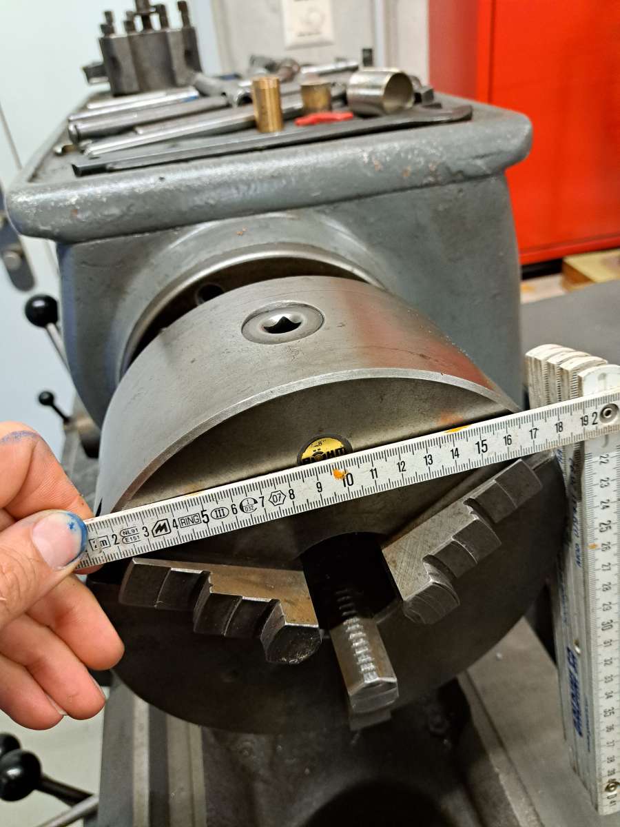

      Sorry for taking up folks time with what’s maybe a basic question. A friend and I are looking for a replacement for this worn chuck – it’s threaded fitting that neither of us have seen before and neither of us know what this fitting is called.
      Sorry I didn’t get a clear photo of the thread that attaches the chuck to the lathe – I can take precise measurements of the thread if that would help.
      The company who made it does still seem to exist and is still making chucks https://www.roehm.biz/en/products/power-chucks/

          Looks like an L00.
          the backplate has a large diameter female cone and a threaded outside. The spindle has a male cone and captive ‘nut’.
          But if you just want a new chuck you can reuse the existing backplate. If it has an L00 nose it is a reasonable quality lathe therefore you might want to go for a quality chuck but you don’t have to use one as big as the current diameter. Perfectly reasonable to fit a small chuck on the bigger backplate if you are not planning to make parts for the Titanic. Looks odd but don’t cut down a good backplate.

            Here’s a video of it in action – I think it’s a German maker and fairly old – I’ll have a look and see if I can find the maker:

                There is no such thing as a metric version of L00 taper. Do not ‘guess’. Measure and confirm.
                L-taper dimensions here: http://www.lathes.co.uk/latheparts/page9.html
                There is only one Standard for L-tapers, ASME B5.9
                https://www.asme.org/codes-standards/find-codes-standards/b5-9-spindle-noses-tool-room-lathes-engine-lathes-turret-lathes-automatic-lathes
                The D1- taper is also in ASME B5.9. That has made it into an ISO standard (ISO 702) but the L-taper did not.
                Measure the diameter (and pitch) of the thread on the backplate and that will tell you which taper it is.

                  Would you agree that one of his pictures is showing the OD of the male thread?
                  Would you agree that the measurement shown is roughly 110mm?
                  Please remind me what thread is on an L00 chuck.

                                3 Does the photograph showing the measuring stick on the male thread of the backplate, the one showing roughly 110mm, not give enough information for a positive identification? Look at the page you cite. There is only one L-taper that would measure near to 110mm.

                                        The first picture shows the left side of the backplate and it is somewhere in the region of 110mm. L00 threads are 3 3/4 x 6 which is about 95mm, and L0 threads are 4 1/2 x 6 which is about 114mm. Therefore I think it is L0 size, not L00. The ruler is obscuring most of the keyway which is a shame, but it would be very shallow at that end of the taper.
                                        Pretty much any 160 or 200mm rear mounting chucks would be easy to fit to the existing backplate. Bison and Pratt Burnerd are very expensive, but Vertex made in Taiwan are good and much cheaper. I have been very lucky with even cheaper Chinese chucks, but it is a lottery with them.

                                          I wonder what the wear is? If it is just the faces of the jaws, which is what it looks like in the picture, I would clean them up with a sturdy carbide insert boring bar. Just jam some suitable steel in the gaps between the jaws to hold them steady and tickle the gripping faces until all surfaces are cleaned up.

                                            I had wondered about the wear on the jaws, the body of the chuck looks very nice. If the chuck was mine, I would drill the flat outer faces of each jaw with a solid carbide drill and then use a ring with pegs to tension the jaws and either grind them, or as M C mentions, a indexable boring bar. The chuck should be throughly cleaned before and after any reworking.
