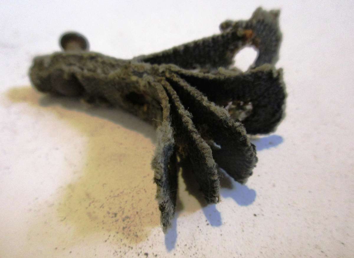

              I can’t ever remember seeing a leather link belt, but that doesn’t mean they don’t exist, all the ones I’ve had anything to do with in my day jobs, were made from layers of impregnated and bonded together canvas with a rubber type material.
              Belt Link
              The link above is an old one that was on my Myford M type lathe, which is one size to big and has five canvas layers.

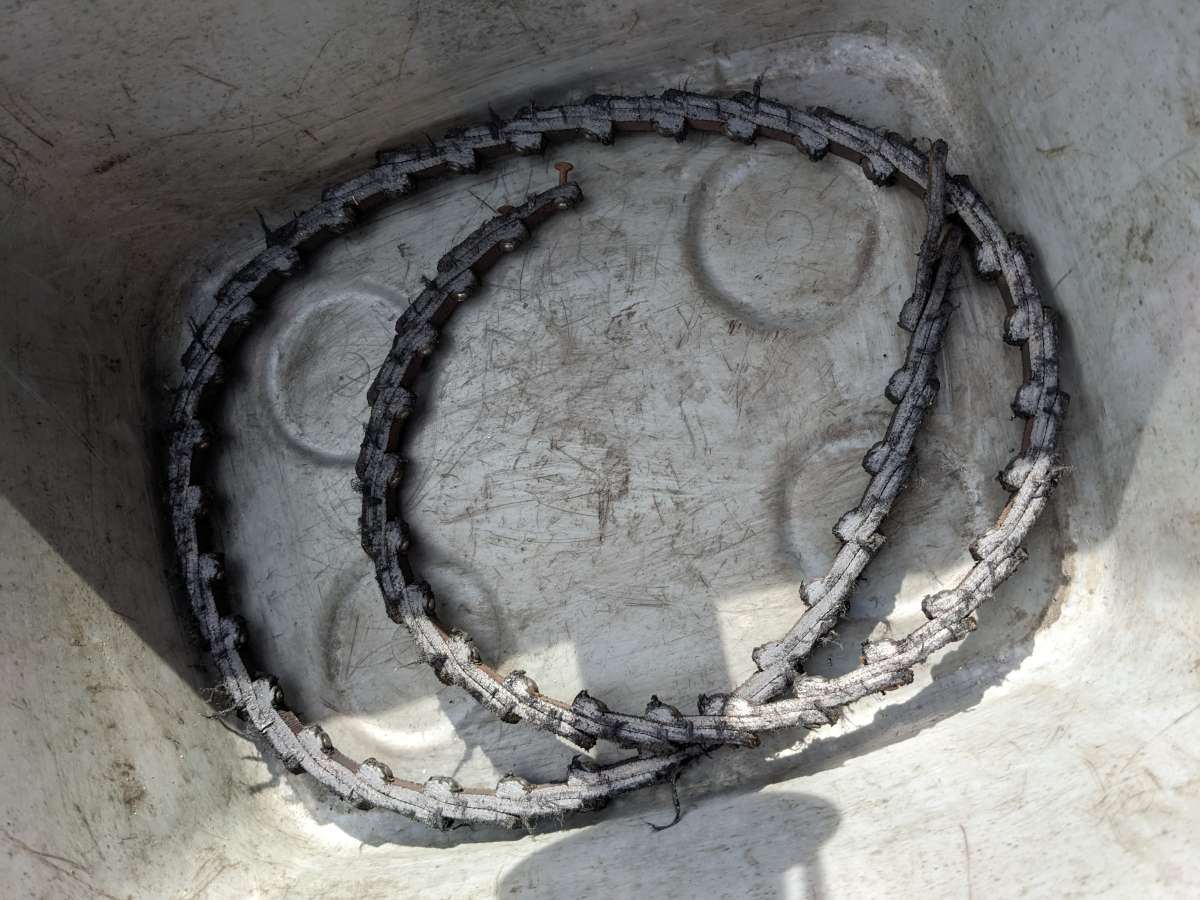

                        This is the state of the linked belt. Not worth saving I don’t think. The good news is that the pulleys look ok. However upon inspection I found the motor belt is also in need of swapping. Anyone know what size it is? It just reads “Fenner 3280”.

                          My motor drive belt is “A” section. Take your belt off. Put adjustment  in the middle and wrap a piece of 6mm rope around the motor and lathe pulleys. Cut to exact length and measure. That will give you the belt length in inches or metric whatever you work with.

                            Hi Hollowpoint, I measured my Fenner 3280 vee belt today, around the outside, and it came to 28-3/4″, apparently you then deduct 2″ from this measurement for A section belts, to give you the belt length, which comes to 26-3/4″. In my Fenner book, imperial belt length designations are measured on the inside in inch’s, whereas metric belt designations are at pitch length in millimetres. When you calculate the diameter from the outside length above, and then deduct two belt depths and recalculate the length, it comes very close to the 26-3/4″,  The belt depth for an imperial A section belt being 5/16″. A27 is the closest one that is in Fenner’s list. Maybe the Fenner 3280 is just a part number for Boxford’s

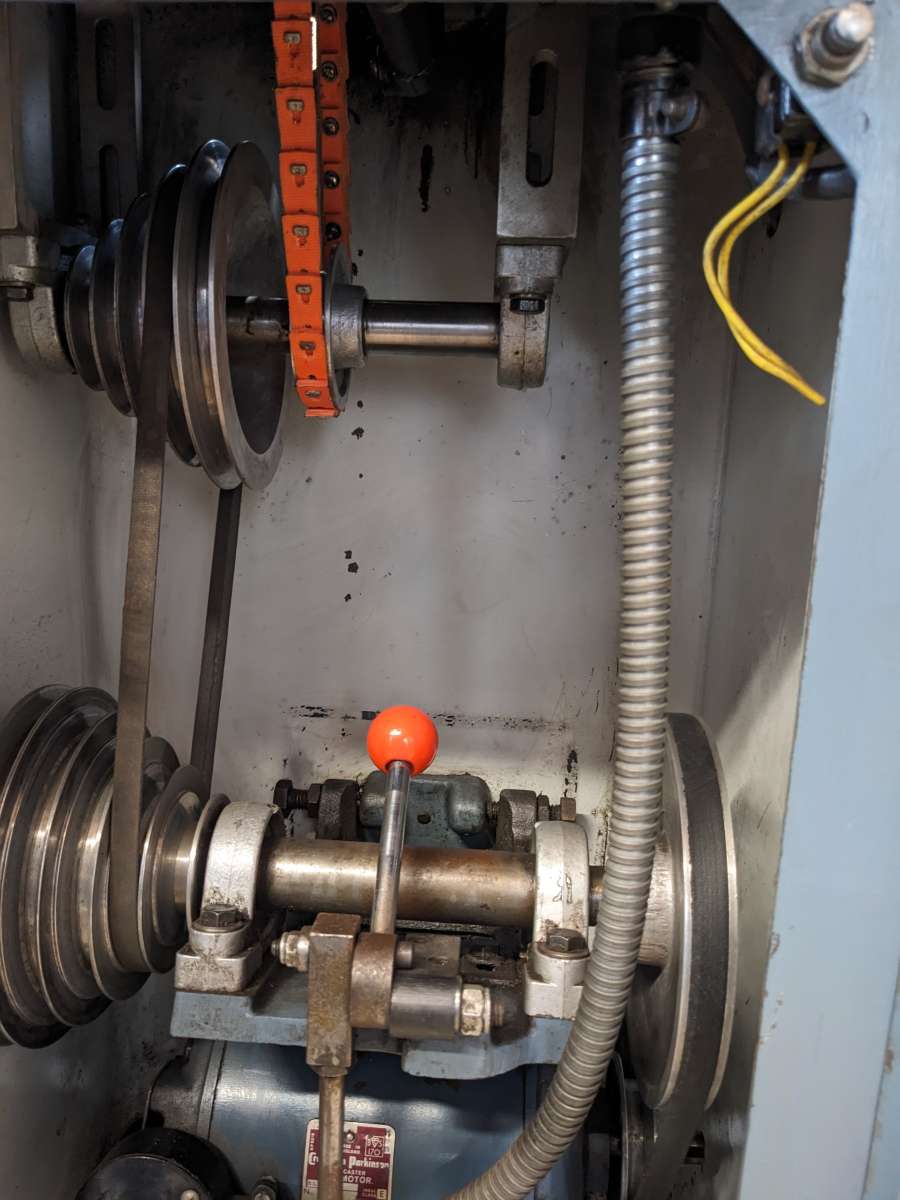

                                      <p style=”text-align: left;”>Finally got around to fitting the belts. I decided not to cheap out and went for the Fenner nutlink belt recommended and an optibelt A26.5 for the motor.</p>
                                      I am pleased to say everything fits perfectly and it seems to have solved my slippage problems. 👍 And as a bonus, it’s a bit quieter now as well.
