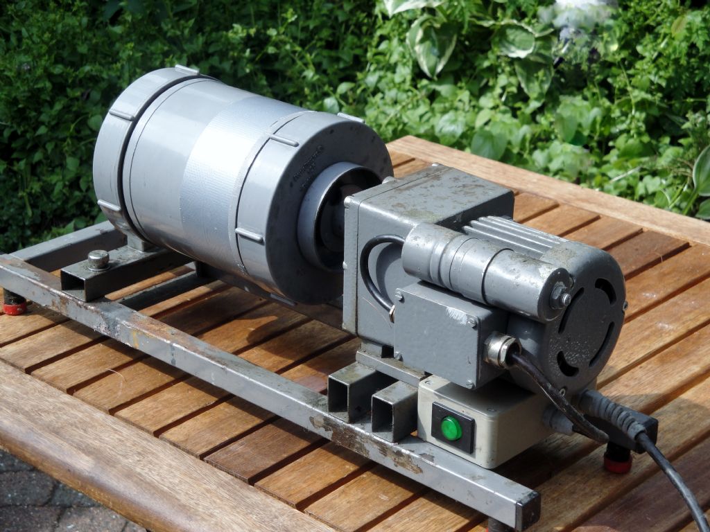

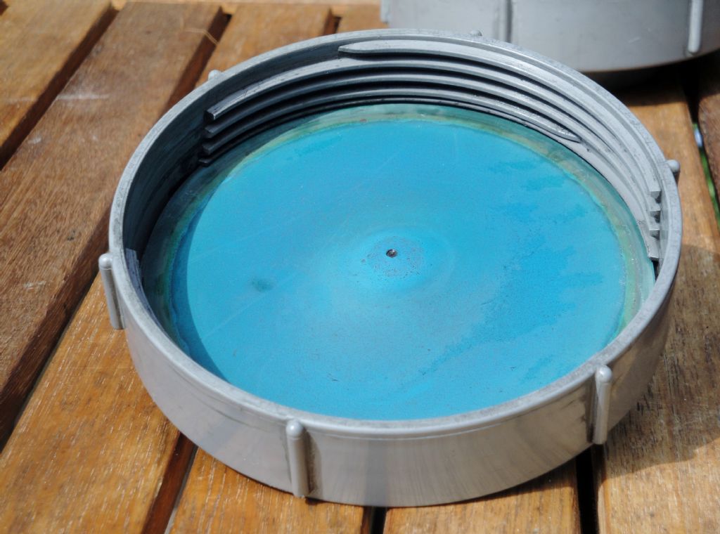

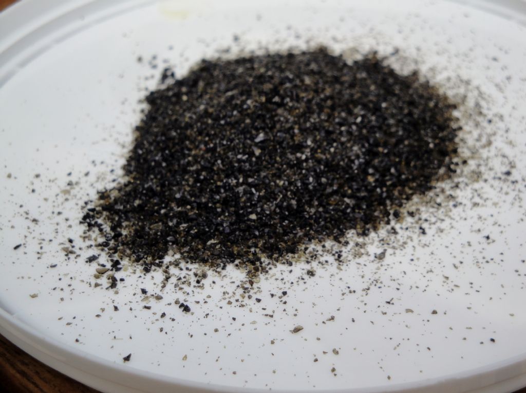

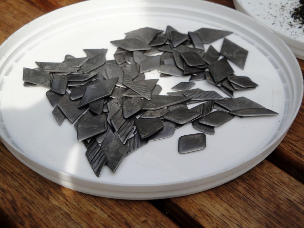

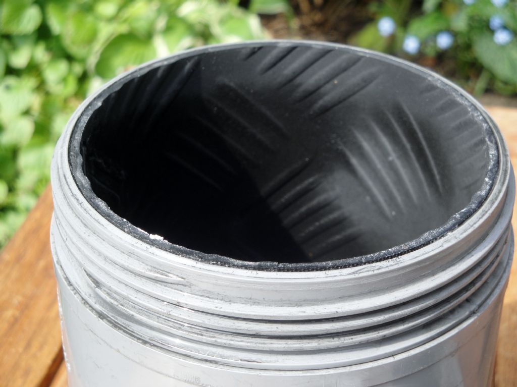

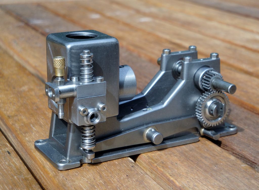

                                      #239657
                                      Johan van Zanten
                                        @johanvanzanten
                                        Hi all,
                                        I follow the tumbler discussion on this forum for some time but I think it is not that easy to get good results. I made my tumbler 20 years ago and use it very frequent with good results. The driving unit is a geared fractional horsepower motor with a speed of about 100 rpm.dsc03856.jpg
                                        My drums are made from sewage tubes with a diameter of 120 mm, carefully covered with rubber sheet.
                                        They are half way filled with medium made from offcuts stainless steel . The sharp edges are essential to reach the corners of the workpiece. I use one spoon of siliciumcarbide grit as abrasive.
                                        To lubricate the process I use a cup of water with a spoon of washing soda. The tumbling time varies depending on the workpiece between 12 and 20 hours. For a brass or bronze workpieces I use brass medium. Tumbling is ideal for (silver)soldered workpieces. The parts of my latest engine are tumbled for 15 hours direct from the mill. I am looking for a reasonable priced bowl for a vibratory tumbler. This shortens the operation time.
                                        As you see there are happy tumblers in the model engineering world.
                                        Best regards,
                                        Johan.

                                                #239764
                                                Johan van Zanten
                                                  @johanvanzanten
                                                  Hi Martin,
                                                  When you tumble brass parts with stainless steel medium (as on the picture) you get a grey haze on the surface of your workpiece caused by the rubbing of the s.s. When you use commercial available hard steel needles or satellite’s there is no noticeable discolouration. When you tumble steel parts with brass medium the steel workpieces comes out light yellow. Ceramic medium causes no discolouration but due the dimensions of the stones it is difficult to reach the corners of your workpiece. I hope this answers your question.
                                                  Best regards, Johan.
