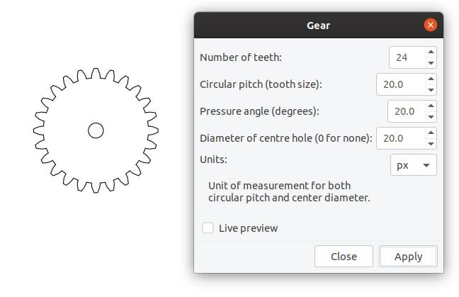

                  Inkscape can draw Involute gears and racks by following the menu Extensions->Render->Gear.
                  The dialogue and gear it drew is shown below:
                  The teeth are sized and shaped to engage with another gear of the same specification, this boiling down to the numbers entered in the dialogue.

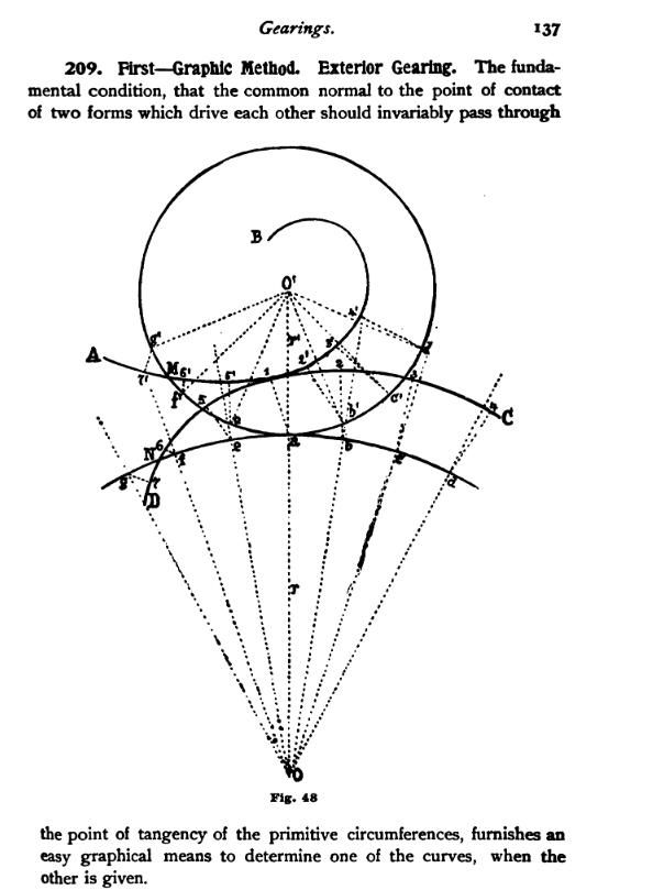

                                                Bazyle's view is also at odds with more than one Horology Textbook. Grossman's much esteemed 'Lessons in Horology' (1905) can be downloaded from – shock horror – the internet! (My dad was convinced computers would never catch on!)
                                                Chapter IV describes various ways of deriving gear profiles, for example graphically:

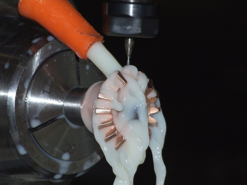

                                                  Posted by Bazyle on 23/12/2019 00:25:56:
                                                  An engineer would draw such teeth because they are more interested in playing with the toy than making a clock.
                                                  There are those that talk about it and those that do it. smile
                                                  CAD:
                                                  CAM:
                                                  CNC:
                                                  Real gears:

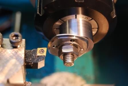

                                                  I thought that the involute tooth form gave primarily a rolling contact, with a little sliding. It would seem strange to use a tooth form for power transmission that has inherent losses due to friction over another tooth form.
                                                  Andrew
