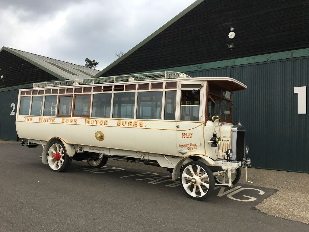

                        @drdave
                        Strange how you don’t “see” details until they have been a topic of conversation. I have seen this bus at Shuttleworth many times (one of our neighbours drives it on occasion), but had not noticed the ventilators on the roof until today.
