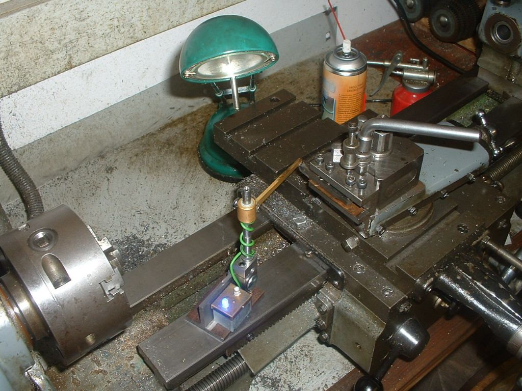

                                      My eyes are not as good as they were. So I made this little Gizmo.  It works you get a coconut every time   I have written it up and posted it to the editor as a contribution.

                                        When I was a lad in’t toolroom (c1950), there was one toolmaker who did most of the intricate turning. However, his eyesight was so poor that he wore glasses so thick they were like the proverbial beer-bottle bottoms.
                                        For really intricate work, especially when there was a need to locate a `tight’ spot, he used a simple flash-lamp battery and bulb arrangement. The cutting tool was electrically insulated from the body of the machine, which thus became the `earth’ return.
                                        Richard, I hope this doesn’t read like a “Me Too!”.
                                        Your photograph appears to show a Super 7 with a Bernard `Grip-True’ three-jaw chuck.
                                        Fond memories for me!

                                          It is but it uses two LEDS culled from broken lighters. The cheapo light is insulated (with masking tape. A Super 7 bought in 1975 with a body threaded Griptrue.
                                          Thanks for the tip about insulating the tool The next lighter I find with a torch I will look at that idea.
                                          Must go as I have to repair a shower bath, Hungarians seem to be able to break anything
