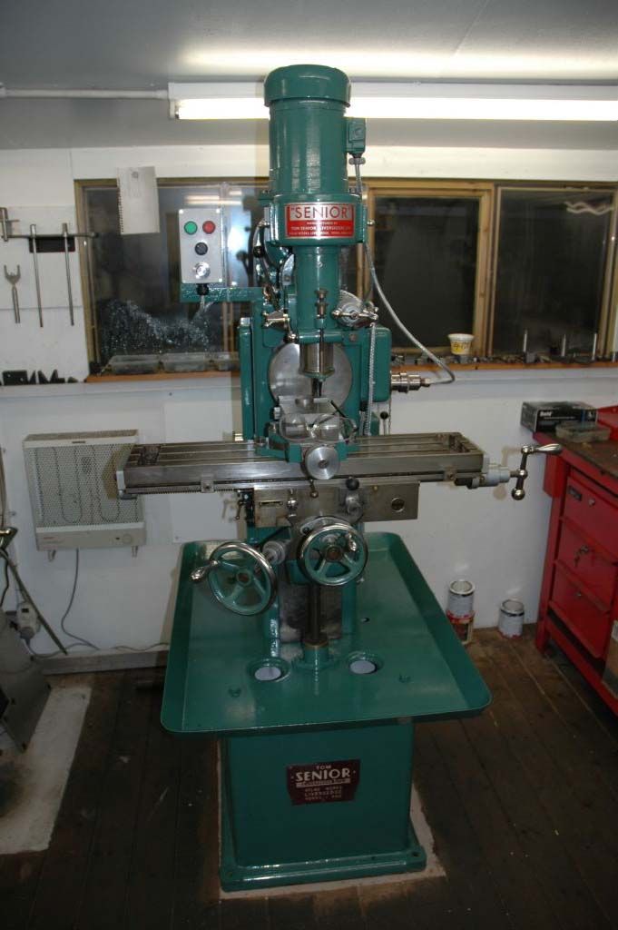

      Overhaul completed, Really enjoyed the last couple of months on the M1 Stripped, cleaned, painted, one motor stripped and rewired for Delta wiring, Two new inverters wired, programmed and tested this afternoon.

          Machine looks very good, are all ways nice and smooth ?

            Yes they feel really nice, Powering the table both ways with the main motor via an inverter feels smooth and quiet, Minimal back lash on all leadscrews.

                Looks gorgeous Peter, well done!

                  Thanks Mark, I used Paragon's Tom Senior paint. Brush paints very well, although it is expensive.

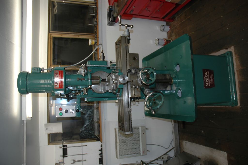

                    Looks brill
                    Pitty it fell over
                    There, now the right way up
