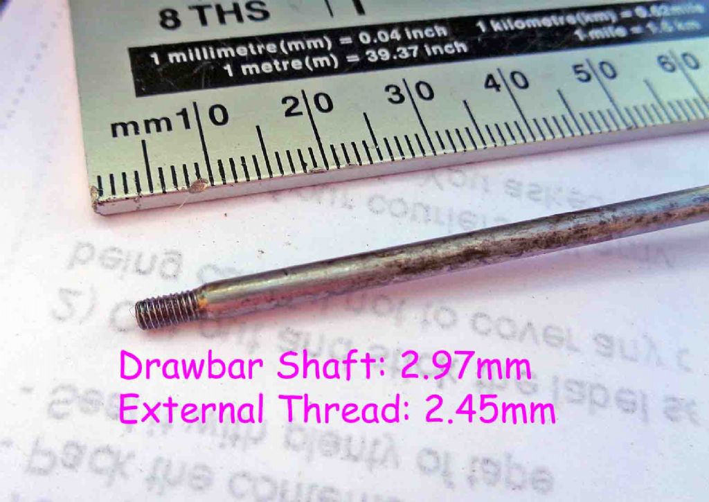

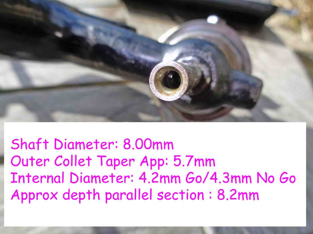

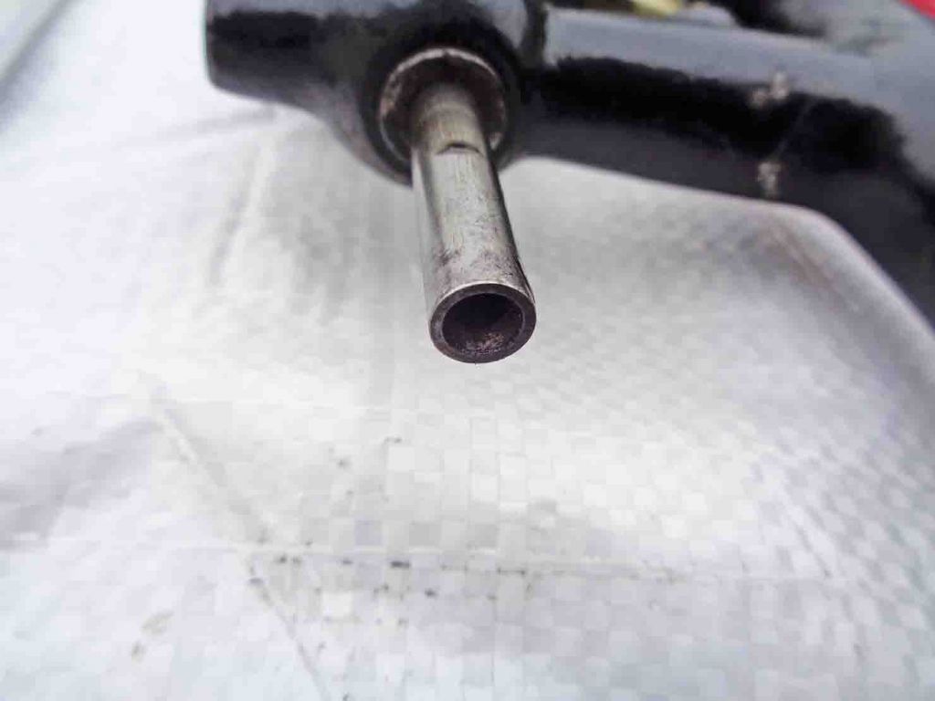

        Hi All,
        Having established that this is a reversible tapping machine I am still struggling to define the exact collets that will fit. Standard 6mm watchmakers collets are way too large. Here are some close up pics with dimensions if anyone can shged any light please:
        I have never seen any this small?
        Cheers,
        Martin

          Martin,
          I wrongly assumed that they might be Schaublin P4.5
          **LINK**
          http://www.schaublin.ch/app/webroot/pdf/cat/8.pdf
          … but even that is bigger diameter than your measurement sad
          P.S. … I'm rather puzzled by your question (a) because your correspondent mentioned P6 and P5 collets, and (b) because you said it had gone to a new home.
          Edited to remove some superfluous speculation
          Edited By Michael Gilligan on 21/03/2017 23:18:59

            Hi Michael,
            The correspondent whose remarks I quoted was clearly partially in error regarding the collets. Seems only to have muddied the waters slightly.
            The unit was sold to a very high quality professional watchmaker. Wisely, he contacted me after paying for but before shipping to clarify the collet size and kindly sent me a 6mm collet which was way too large.
            This has at least avoided the anxiety of sending a cast iron item through the post not once but twice!
            I have since refunded him and continue to try and find out exactly what this machine takes in order to describe it more accurately when I list it for sale next time. He too has some 4.5mm collets with a female thread for the drawbar which according to my measurements will also be too large
            It is difficult for me to measure this small opening accurately but have done my best.
            Any help on this would be really welcome!
            Regards,
            Martin.

              Martin,
              Can you take an impression of the female taper with something like polymorph, or the stuff dentists take impressions of teeth with? Possibly use a smear of grease as a release agent. In my experience it's far easier to get accurate dimensions from the resulting impression than from the original.
              George
