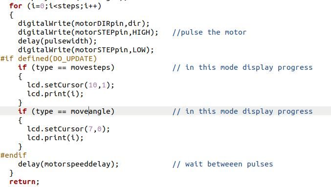

                Gary updates the display after every step in moveangle and movesteps modes, which slows the motor down. Try disabling the display by altering the movemotor() function at about line 546, to cut out a section of code with an #if defined(DO_UPDATE) and #endif block thus:
                The code between #if and #endif will be ignored when the sketch is recompiled, and not having to wait while the display is altered should speed the motor up. Noticeable improvement rather than gee whizz, and of course the display is disabled.
                And/or try setting Line 73 to #define pulsewidth 1

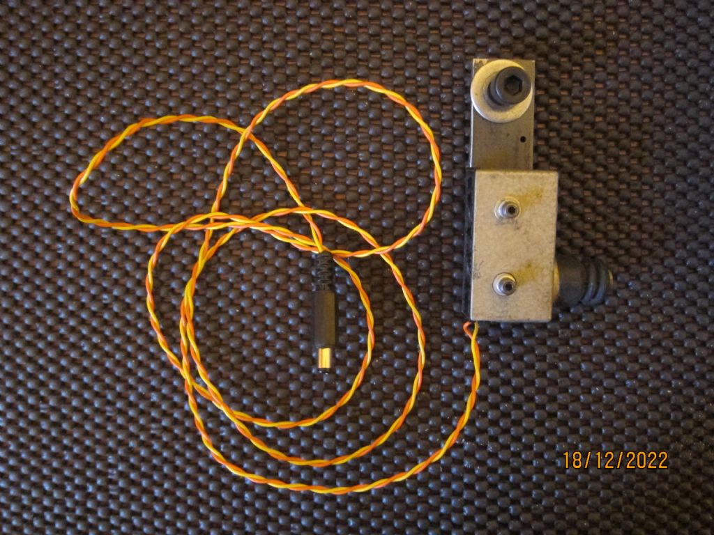

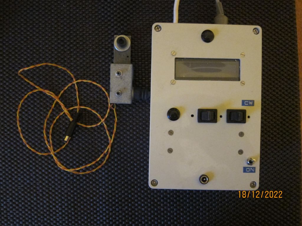

                  I have been experimenting with the original circuit by adding a microswitch connected via a 2 pin plug and socket brought out to the bottom of the front panel as seen in the attached photo. The microswitch is wired in the NO state and connected across the centre tab and outer tab of the rocker switch shown mounted on the RH side of the panel as illustrated in Carl Wilson’s article in MEW No.249, Page64.
                  The object of the exercise is to activate the Indexer unit by a momentary closing/opening of the microswitch generated by movement of the milling machine table in place of normal hand operation of the rocker. However in practice simply plugging the microswitch into the socket results in read-out instability and the circuit fails to operate in its anticipated way. Unplugging the microswitch followed by switching the unit Off/On does however restore normal working and so I am somewhat confused as to what is going on.
                  I just wonder if this can be the result of some sort of capacitive loading due to the length/type of wiring used for connecting the microswitch into the circuit. I do hope there is an answer to this problem.

                    It is possible that the wiring is picking up electrical noise giving spurious inputs. Assuming that the switch function is "switch pulls down", i.e. puts a short to ground on the relevant Arduino pin, quite likely the pin is set for "pinmode_pullup" which activates a relatively weak internal pullup (~20k ohms) – this means the pin is a rather high impedance and more prone to picking up noise. An easy fix, IF the switch does short to ground, is to wire an external resistor the input with a lower value, 4k7 would be a good choice.
                    However, you may still have problems with "bouncing" of the microswitch contacts – this ought to have been fixed in the software anyway. It might cause occasional spurious increment of the indexer.
                    #625342
                      The long wires are picking up mains hum and other electrical noise. Microcontroller inputs being high impedance makes them sensitive, so best to keep wiring short and shielded.
                      There's a good chance putting a decoupling capacitor across the wires at the arduino end will fix it. 0.1uf is popular, but any value between 0.01 and 0.22uf. Use a ceramic type because they're fast acting and good for decoupling.

                        Perhaps the next thing to try would be to replace the twin flex cabling with a length of screened cable which does needs to be of a certain length to provide for a practical set-up. If the problem still exists will then consider fitting a suitable resistor/capacitor as suggested above.
