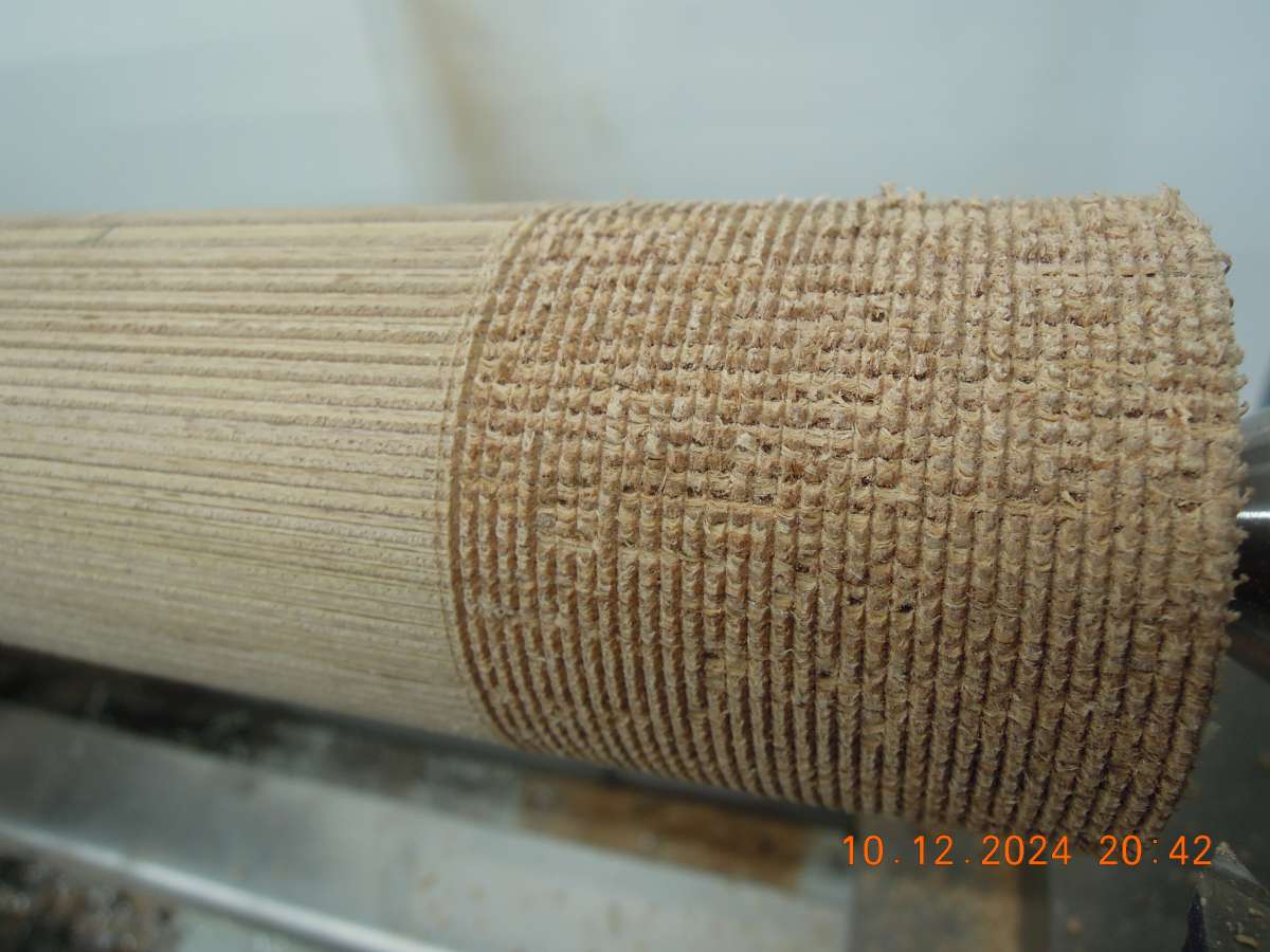

      I’m trying to put a 1.5mm metric form thread on a piece of laminated beech. Using conventional tools, there is too much tearing for my liking.
      I “think” what I need is some kind of high-speed cutter mounted on the tool post.
      Does anyone know of a device that I could buy to do this, or suggest ways to improve the quality of the cut surfaces using conventional techniques?
      (I’m not looking for engineering perfection by the way, just something that most reasonable people would recognise as a thread… if you know what I mean!)
      Gerry

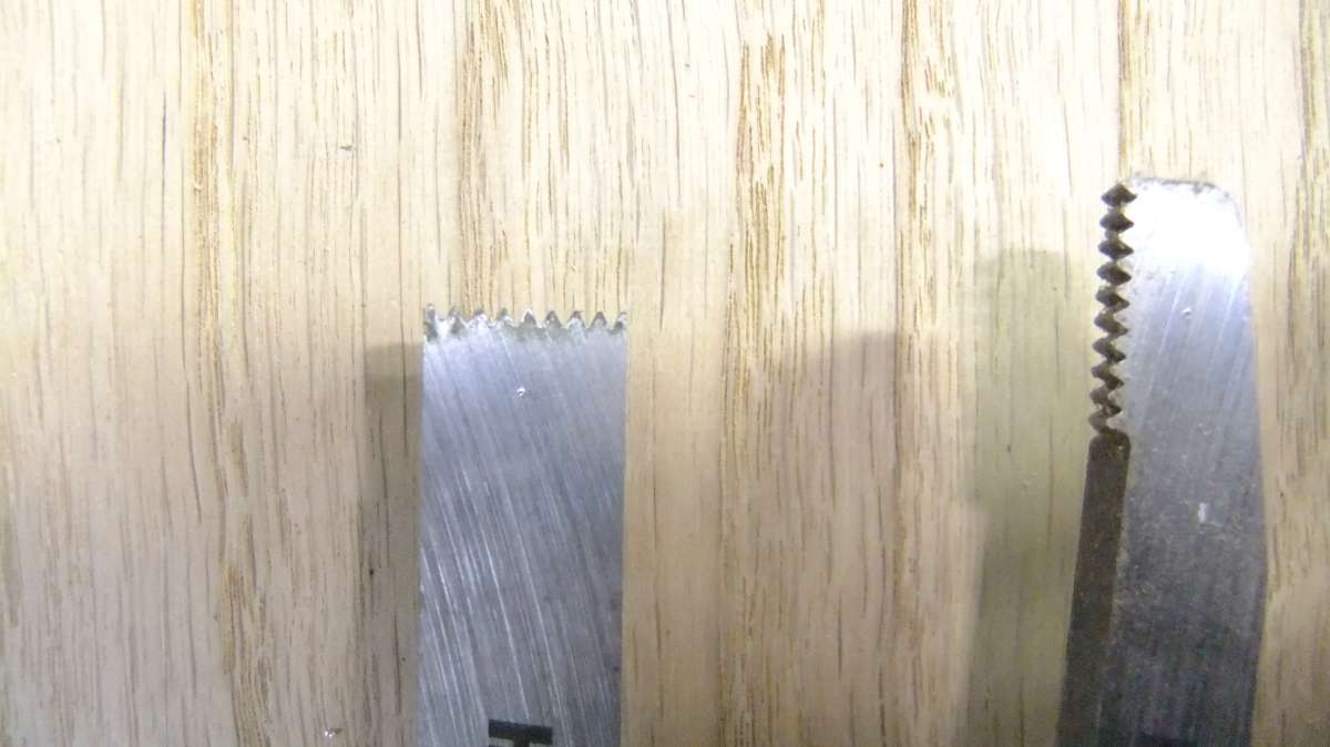

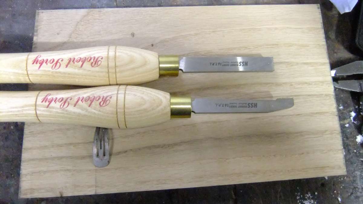

                      I also forgot about what I have and that is these which are for thread cutting in wood. They do need some good eye-hand coordination and best run at 450RPM or a little lower if possible.
                      The top one is for external threads and the bottom internal threads
                      thread cutters (1)thread cutters (2)

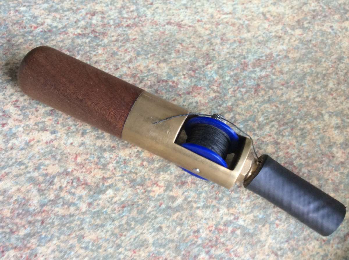

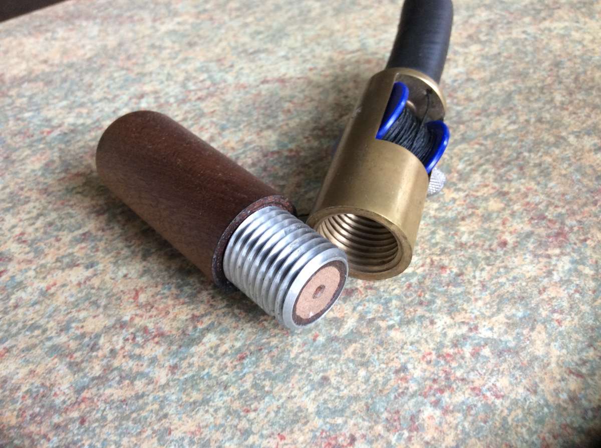

                                                    How about turning a metal collar to fit over the end of the beech rod, and threading the collar?  A metal that’s easy to thread, perhaps Brass if looks matter.   The inside of the collar can be bored to require a force fit onto the beech, lightly splined to resist turning if felt necessary, and glued.   There is no difficulty threading a machinable metal and the thread will be robust.
                                                    The collar suggestion is just a guess – I have no idea what Gerry’s requirement is.

                                                      You could do this or something similarIMG_3766IMG_3767
