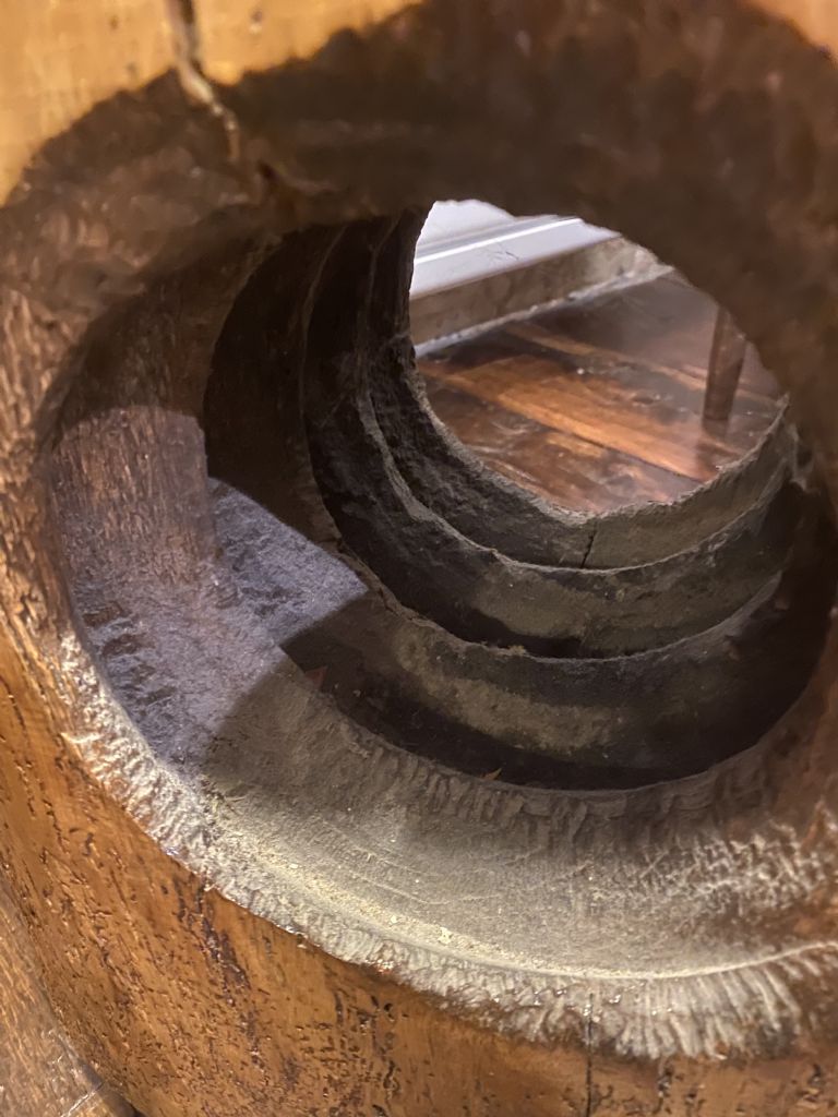

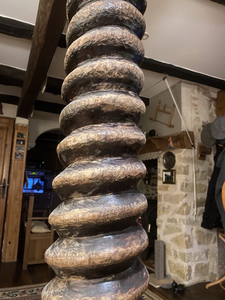

                      We have the screw of a walnut oil press (circa 1860). It's about 1.5m long and 170mm diameter, pitch 60mm. They were hand carved from a log of lime wood.
                      First a suitable log was sawn, square, then made octagonal by planing off the corners by 45 degrees, then made 16 sided and eventually round (Similar to sailing mast making).
                      It was then mounted on a couple of stands, one end with a stub and the other with a handle.
                      As one operator turned the handle, the other walked from one end to the other, scribing a pencil line along the length thus marking a spiral. These guys were real artisans !
                      Once they had the spiral line, they would cut a saw cut to the depth of the thread along the spiral. Once that was done, they used a chisel to form the thread profile – thread angle approx 90 degrees!
                      The final cleaning up was with a wooden moulding plane with a 90degree dagger blade.
                      I have yet to find out how they made the nut !

                                Posted by Speedy Builder5 on 23/02/2023 16:15:23:
                                Bob
                                The answer may be in "One Good Turn: a Natural History of the Screwdriver and the Screw" by Witold Rybcznski. He describes how the Romans cut male threads in a similar way to your description, but the nuts didn't have a thread, instead wooden pegs were inserted radially to bear against the flank of the thread. This was much weaker than a proper female thread and could only be used for light loads.
                                The book states that the female thread was invented (or at least first described) by Vitruvius, who used it to replace the weighted lever of earlier olive presses with a screw. He temporarily fitted one of these nuts to the crossbeam of his press (in which a tapping diameter had been bored) and attached a metal cutter to an extension of of the screw, so that by repeatedly turning the screw and advancing the cutter, a helical thread was cut in the beam.
                                Brian G

                                  Speedy Builder5
                                    @speedybuilder5
                                    Brian G,
                                    The nut looks like it had some sort of tap to make the thread. I bet it would have taken a very big wrench to turn it.
                                    Looking at the top of the screw, you can see thread rounding where it has worn away and where the rats used to chew at the animal fat that was used to lubricate the thread.
                                    Bob
