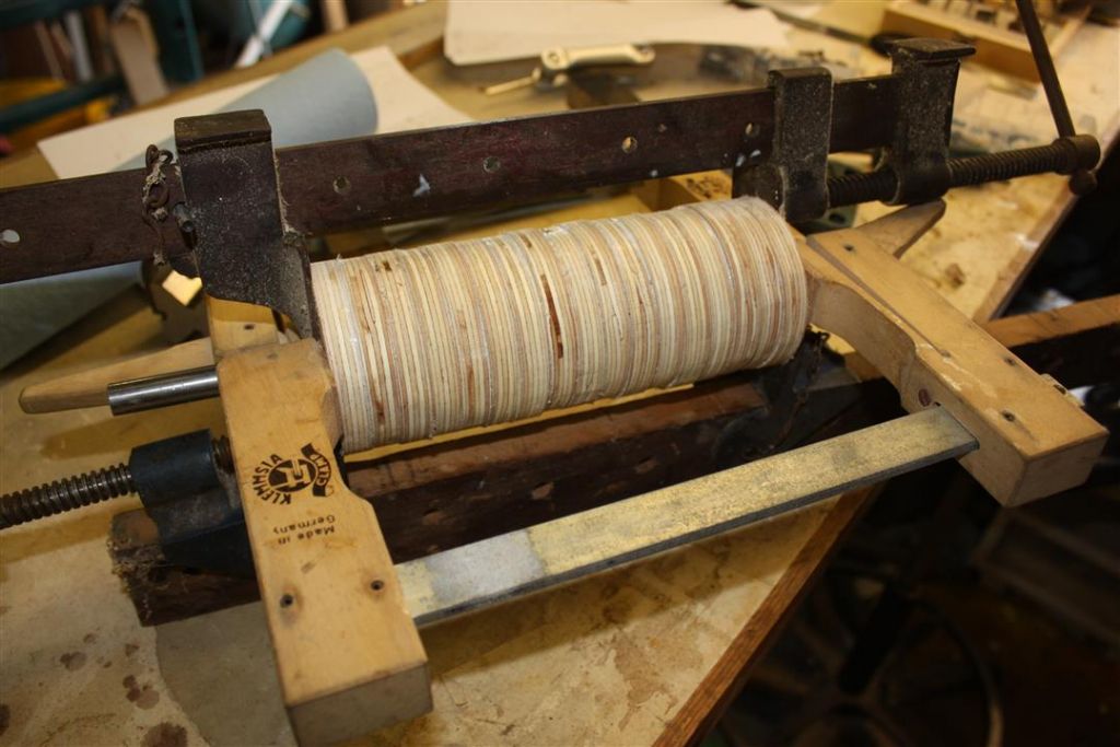

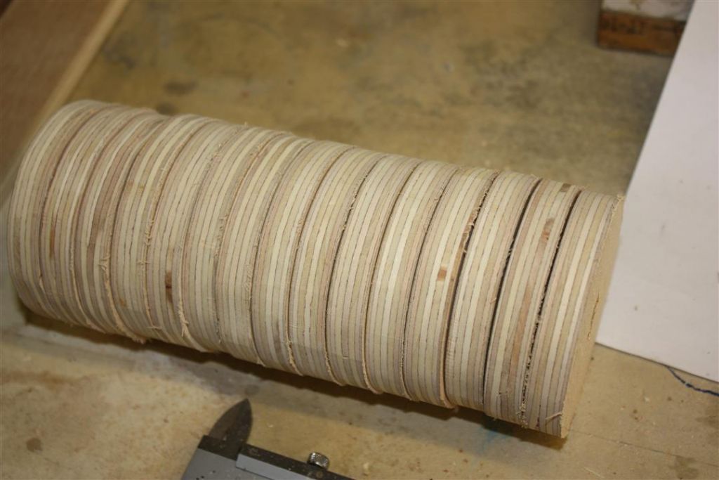

12mm ply discs cut and sanded approximately round:-

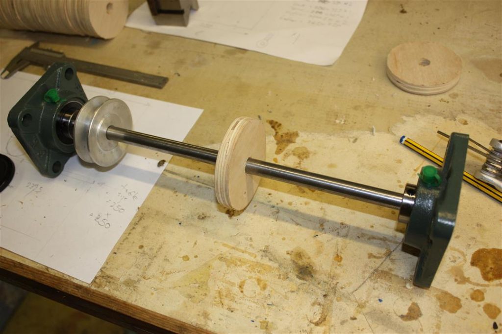

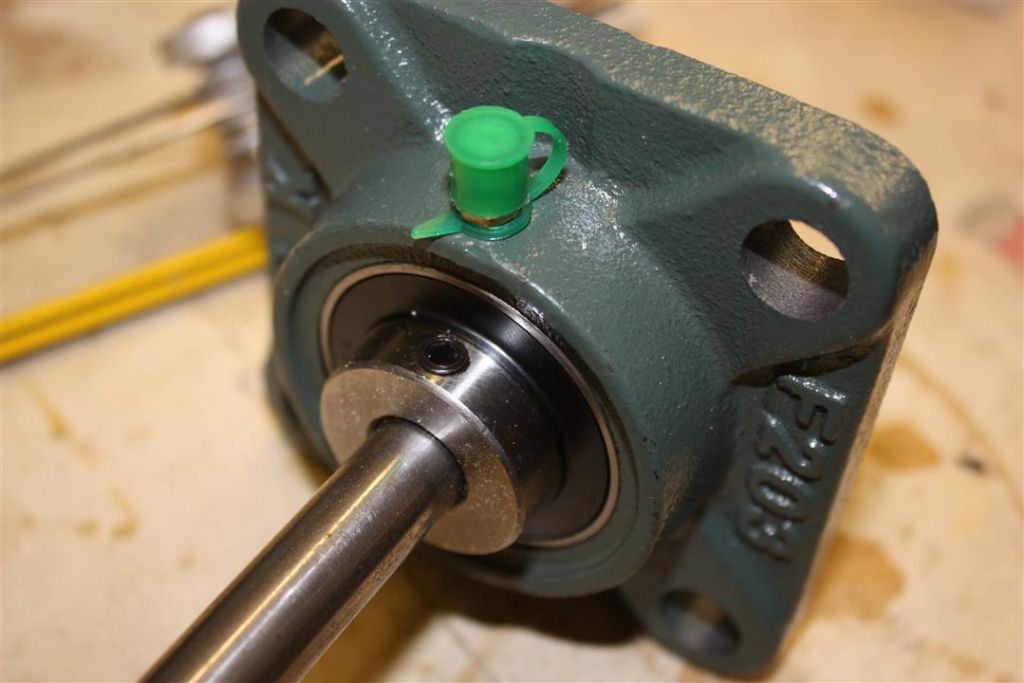

Shaft bearings:-
All clamped up!

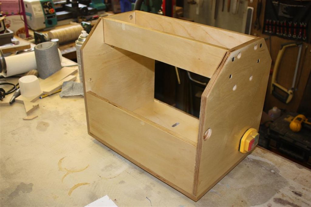

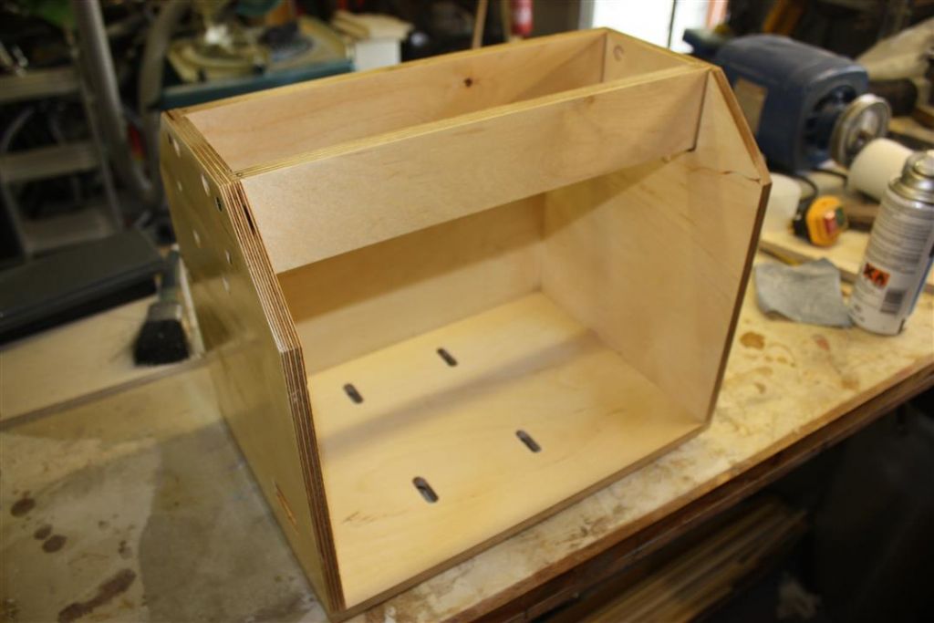

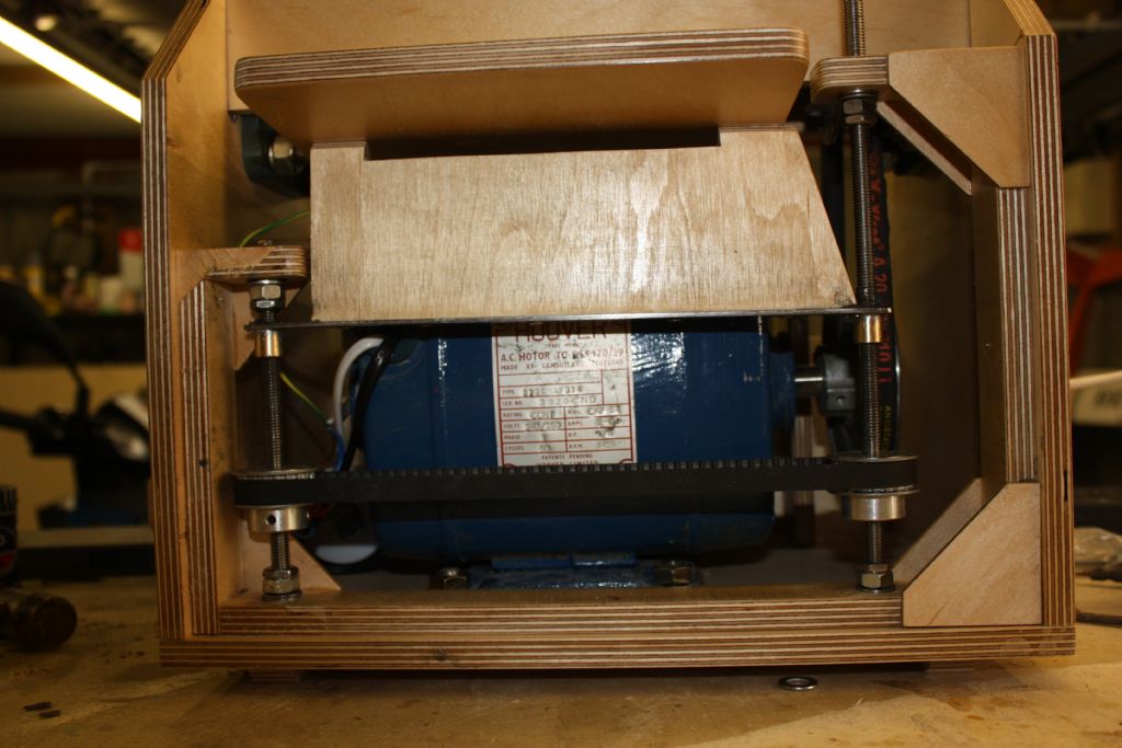

Main box, lacquered:-

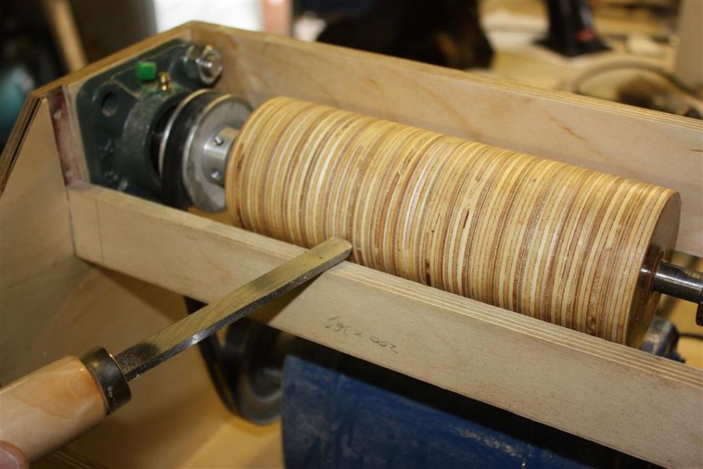

Turning the drum round: –

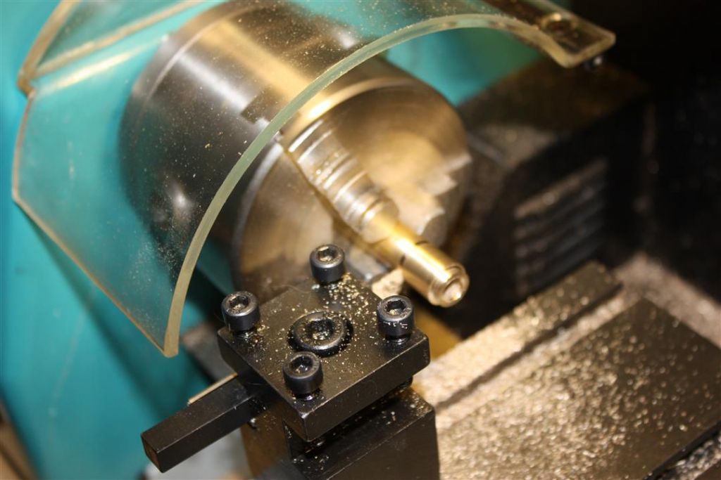

Machining up some brass bushes: –

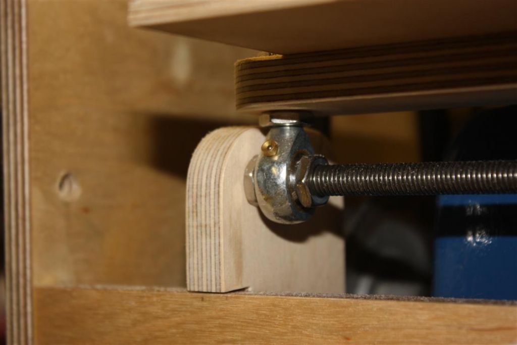

Table pivots, fully adjustable:-

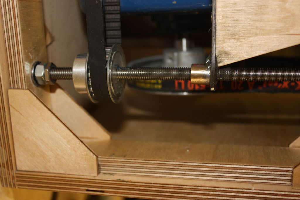

This shot is sideways, but shows the main leadscrew of 8mm stainless, tothed pully and brass bush, soldered to a strip of 3mm mild steel. There are locknuts either end, adjustable for backlash, of which there isn't any !
The threaded rod on the right is turns via a handwheel. A toothed belt arrangement turns the rod on the left and the table rises and falls uniformly. All rods are 8mm ball raced:-

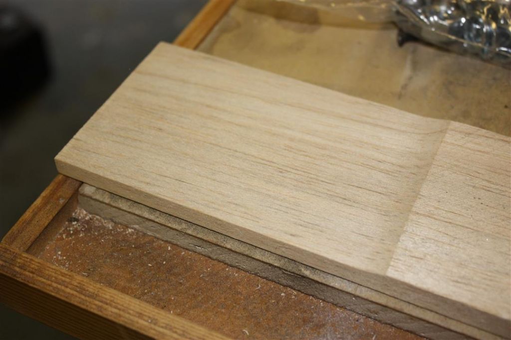

Here's the test pass…baby's bum smooth! The top does have a dust extraction point, too.
One thing – I've wound the sanding strip (25mm wide) on and secured it either end via screws – not ideal – anyone have any recommendations?
