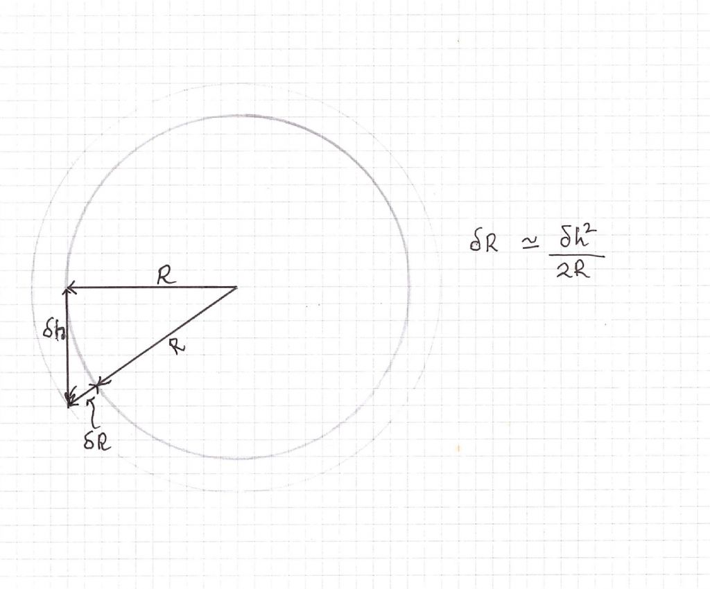

      This doesn't seem to be a problem for me, but I came across discussions of the influence of lathe tailstock height misalignment on turning parallel between centres whilst looking for other related info. The discussions were initiated by people who had bought a lathe and, by one method or another, had found the tailstock centre to be high with respect to the headstock. The advice from seasoned hands was not to worry – provided the tailstock is OK in the horizontal plane, vertical alignment (unless grossly out) would be insignificant, but no explanation was given. I wanted to understand this better and tried to work it out.
      I'm very bad at 3-D visualisation so tried to approximate the problem by imagining that the tool was cutting dead on centre at the headstock and low by delta_h at the tailstock:
      After a bit of algebra it came out that the radius at the tailstock end would be the radius at the headstock plus the square of the distance of the tool under centre at the tailstock divided by the diameter of the work at the headstock.
      If this is so, it would explain to me why vertical alignment is relatively unimportant – on a nominal 10mm diameter workpiece, even if the tailstock were 0.1mm high it would lead to a discrepancy of 0.1×0.1/10 = 0.001mm on radius.
      I'm not sure that I've set the problem up correctly though – I've a sneaky feeling that I've over simplified, and conic sections or something come into it. The intersection of a plane with a cylinder can be an ellipse, so maybe turning with the tailstock off-height gives a barrel shape – I just can't visualise it!
      I realise that this may have little practical importance at home workshop levels of accuracy, but I'd like to understand it better.
      Robin

                  I'm not sure I understand why vertical misalignment (up or down) should be any different to horizontal misalignment. Off-centre is surely off-centre, irrespective of what plane it's in, or have I missed something obvious.
                  #548249
                  Alan Jackson
                    @alanjackson47790
                    Vertical misalignment will make a small error, but horizontal misalignment will make much more error simply because the cutting tool moves in a horizontal plane.

                        If the tailstock is offset horizontally the distance from the tool tip (at the tailstock) to the work axis changes by the offset value. However, if the work is offset vertically the distance from the tool tip to the work axis is the hypotenuse of the triangle where the other two sides are the radius of the work and the vertical offset, as in the OPs diagram. The increase in distance from tool tip to work axis is much smaller in the latter case.
                        Andrew

                            Robins take on the height of the tailstock is correct, fortunately, as the same applies to worn lathe beds where the tool height varies as the saddle is moved. The error would be relatively greater the smaller the workpiece diameter is, and would also be subject to the distance between the spindle and the tailstock.
                            It is best to have the tailstock at or less than 0.002", 0.050mm high, as it can make centre drilling easier.

                                    Thanks for replies – it seems that my analysis is right. I confess that, like Bo'sun, I thought off-centre was off-centre whatever the direction until I put pen to paper and tried to work it out.
                                    I think that if the formula I derived [I arrived there by discarding terms O(delta_h^4/R^2) and above] is correct I have the answer to my question about the profile of the taper which results from vertical misalignment. The deviation delta_h of the tool path from the rotational axis of the work is linear in Z, the distance the tool has traveled, so delta_R is quadratic in Z, ie the taper is parabolic, in contrast to the linear taper from horizontal misalignment. I think!

                                        Seems to me that it all depends on where the tool is held. If it is held vertically, 90 degrees to a normal toolpost, such as in a vertical milling attachment on the cross slide, and the tail stock is too high, it will produce a taper just like a tool held normally in the tool post would if the tail stock is skewed left or right.
                                        IanJ
                                        #548367
                                          Posted by Ian Johnson 1 on 04/06/2021 23:40:43:
                                          IanJ
                                          That seems a very reasonable interpretation, Ian
                                          [Assuming that the effects of gravity are trival in the matter] : The ‘concept’ of Vertical is meaningless, and we should be thinking about XYZ axes … where Z is the axis of the lathe spindle.
                                          X and Y are perpendicular, and both are perpendicular to Z, but are free to rotate as a pair around it.

                                                  When turning between centers vertical misalignment of the tailstock will result in a part that is fat in the middle.
                                                  #548636
                                                  Robin Graham
                                                    @robingraham42208
                                                    Posted by John Reese on 06/06/2021 23:22:05:
                                                    Hmm. Can you explain that further John? If it's right I'm back to square one in trying to understand this. Assuming the tool is dead centre at the headstock end and travels parallel to the spindle's rotational axis I can't see how it gets closer to the rotational axis at the vertically displaced tailstock end than it was at the middle of its travel.
