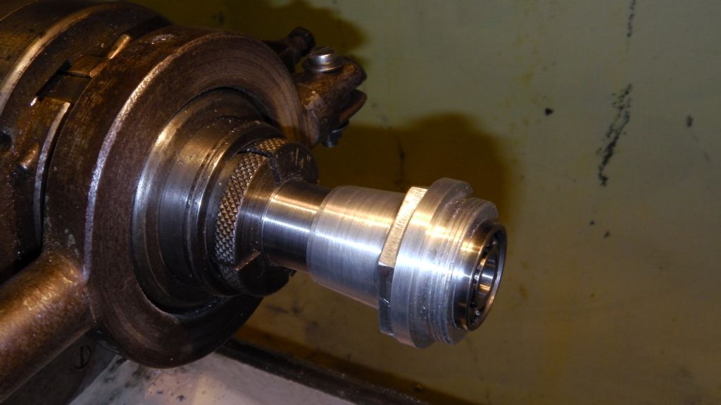

                Having made a part for a sleeve valve engine, and very pleased with completed part, was brought down to earth today with a bump by realising I had make a basic mistake in not ensuring a bearing – that fits in one end of the part – would actually fit.
                So today had to make a tapered mandrel to hold the part so I could machine out the end so the bearing would fit. Mandrel completed today – in between tending to coolant problems (and low oil) in my daughters car – and part fits on it beautifully, to be 'technically adjusted' tomorrow so that the bearing will be a nice push fit!

                  Following on from yesterday's post, here is the part in question mounted on the mandrel with the bearing half in being just a push fit into the part. First part complete!
                  Front Bearing Extension

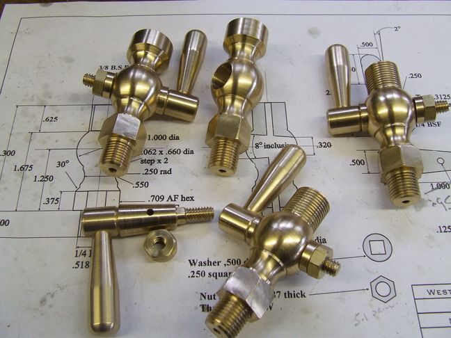

                    I have made these over the last three days. 2 lubricating cocks and 2 drain cocks for full size Westinghouse air compressors as fitted to the engines on the Isle of Wight Steam Railway

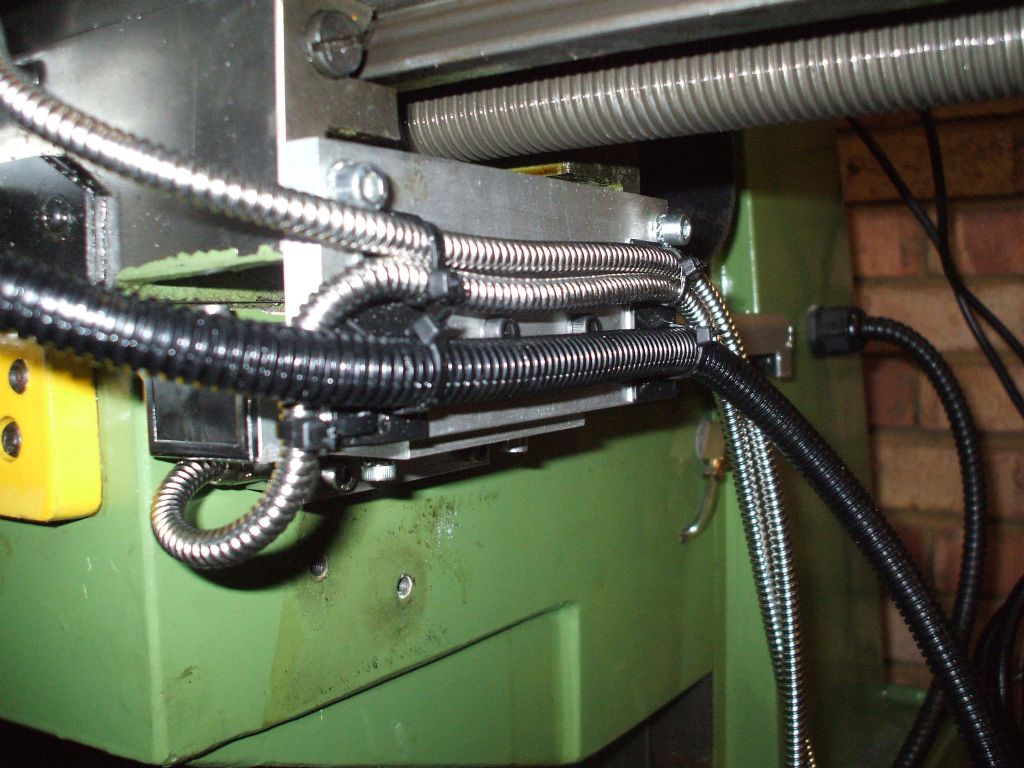

                      Today, I made more progress on fitting the DRO scales to my mill. This time it's the Y-axis' turn for the treatment. Now that I've two axes fitted, I feel confident that the Z-axis will be a breeze!
                      y-axis mounting 1
                      A bit out of focus, but it was dark when I took the photo and the flash rather made me jump! Anyhow, I think you get the gist. The cabling from the X-axis read head and the power feed motor are strapped to the mounting plate to keep them out of the way and to try to neaten that arrangement.

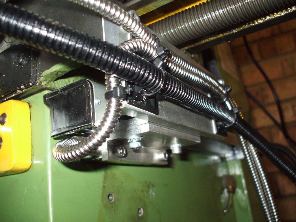

                      y-axis mounting 2
                      A view from slightly below to show the general arrangement of the brackets supporting the read head. Travel limit device has yet to be refitted as has the mill motor control box (a bit lower than originally).
                      Maybe tomorrow.
                      Then on to the Z-axis. I've measured the slope of the main casting and I reckon it's as near as makes no difference 3°. I've milled that angle on the end of a piece of 25mm square bar by clamping it in the mill vice with 5mm drills at 100mm between centre distance on either side of the bar. Just got to drill through for mounting bolts and find the best place to fit them. More to come . . . . . .

                          Nice work John Thorne.

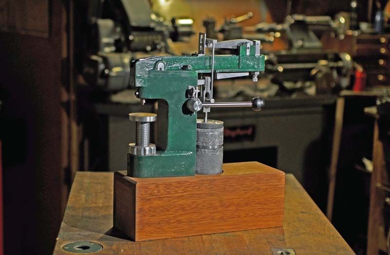

                            Finished my Lammas Hardness tester:
                            Not sure why the paintwork looks quite so awful in the photo!

                              John Thorne, lovely work there. Worth an article in MEW .

                                Congratulationss to all on their handiwork, thanks for posting.
                                Dave Lammas had some very nice ideas for tools and models.

                                  Rod,
                                  Where is the design for the hardness tester published.

                                    Mike,
                                    Model Engineer 1989. Blackgates sell the castings, drawings and reprints of the articles.

                                      John Thorne,
                                      Nice job, I assume you make stuff for Isle of Wight steam railway so full size and you are also like me an Islander or at least now live here.

                                        Hi Everyone
                                        Thanks for the nice coments I was very please with the way they turned out. The material used was SAE 660 and the machines used were a Myford ML7R and a mill I bought from Amadeal several years ago. Bob yes I am a Islander and volunteer at Havenstreet although the cocks were made in my own workshop at home
