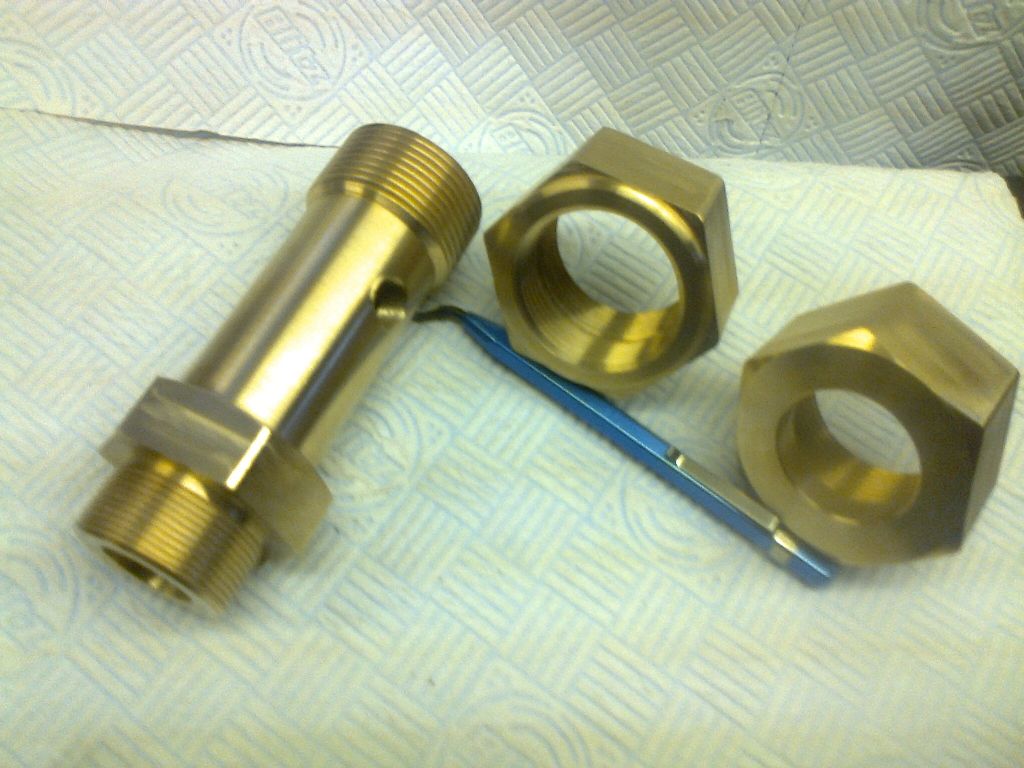

                  Anonymous
                    This part is in the 'progress' thread because it represents progress, unlike the previous attempt. Here's the part with undamaged screw threads, 32tpi on the larger (1" ) diameter and 19tpi Whitworth (aka 3/8" BSP) on the smaller:
                    Through the radial holes the inner valve seat can be seen, with undercut made using the homemade cutter previously shown.
                    Two more to go!

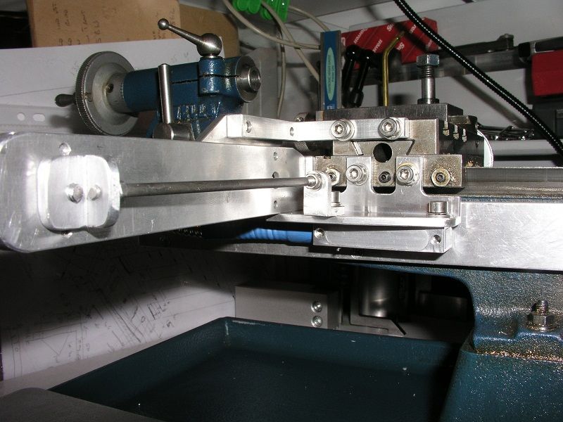

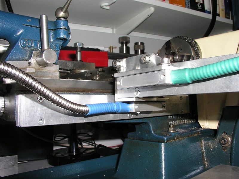

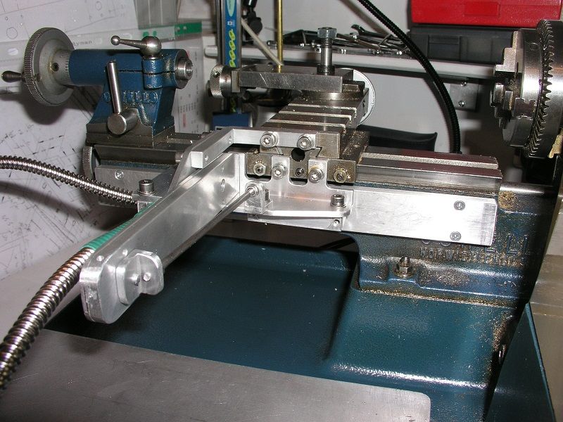

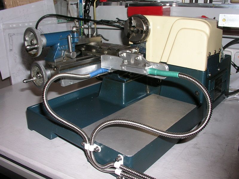

                                          Finally finished adding DRO's to my Cowell's ME90 lathe. I am using YuriysToys android app (TouchDRO) and his controller design. Just need to calibrate them and build another controller box. The current one is running the DRO's on Cowells mill.
                                          Fun job with not too much space to attach the various brackets on the carriage and cross-slide.
                                          Quite pleased with the result.
                                          Colin

                                                      Posted by Colin Heseltine on 08/12/2015 13:27:45:
                                                      Colin
                                                      Colin,
                                                      It looks good. I saw that you also have this set-up on another machine. I am curious about a few things, and wondered if it is possible for you to explain:
                                                      1. I am presuming that the magnetic tape is behind the aluminium plate?. Did you stick it on or did you buy a pre-fabricated track/bar with the tape pre-mounted?
                                                      2. There is a small gap in between the reading head and the bar. Your picture shows that the reading head and bar are 'exposed' for want of word. So, from your experience so far, have you had any issues – problems resulting from swarf/grinding/machining dust getting in between the reading head and the bar? Also, do you use any coolant?. If so, any related problem?
                                                      Ketan at ARC.
