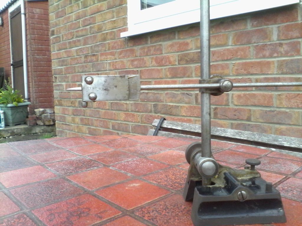

      Going through more of my inheritance I discovered an odd looking little tool called "The Unique" Pat No 234947/11. I could not find the original patent but found a related one that mentioned it and what it was for.
      Came as a great surprise that it was a 0 – 15 thou DTI to fit on a scriber block.

              AdrianR
                @adrianr18614
                I checked mine, it is accurate within 1/2 thou which is impressive as it has been in the bottom of a bits box for ages.
                Wish I knew how it worked, an indicator like that would be great for setting lathe tool height.

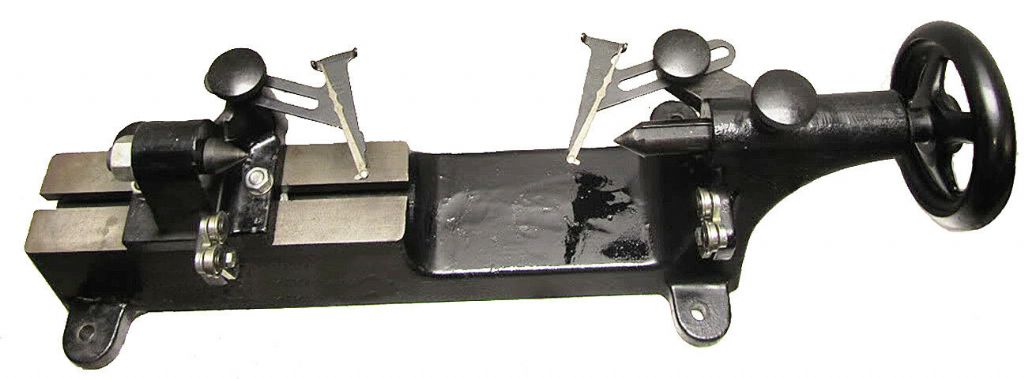

                    Hopper
                      @hopper
                      Harley-Davidson sold a similar – but even cruder – tool for truing up flywheel crankshaft assemblies in vintage days. Countless thousands of cranks must have been set up within the specified total runout of .001" or less using them, so they must work better than they look.
                      Used in a truing stand with the small right-angle tang rubbing on the crank mainshaft, so the long end of the pointer amplifies the movement to a readable level. Crude but effective!
                      The Unique looks downright sophisticated by comparison. I also vaguely remember seeing gauges like the Unique with with a small finger like a DTI sticking out the end rather than the button, and the body was made of brass with fine graduations on it. Can't remember where though. Some machine shop in a previous millenium!

                        Hi Hopper,
                        i thought most of those HD type truing stands just used centres, but in that pic of yours above, it has small rollers or bearings adjacent.
                        What gives?

                            Posted by thaiguzzi on 31/05/2019 05:59:44:
                            Hi Hopper,
                            What gives?
                            Hey Guzzi
                            Good spot. I think the pic – just grabbed off the net – may in fact be a later model Rowe product. Rollers to do Brit and Jap bike cranks that either had no centre holes, or had a large hole down the mainshaft, or had centres but had been centreless ground to finish. But the stand and finger gauges are otherwise copied from the old HD product.
