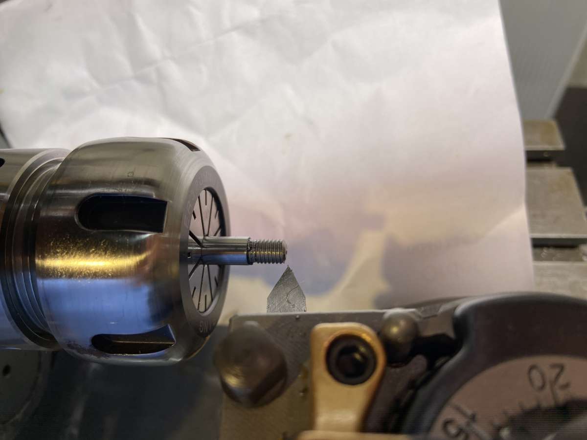

      Guys,
      I have a question about [ being able to ] test a small, custom, single point thread for fitment.
      The question;
      How can I, ” pick up the thread” after having removed the male threadded work piece from the chuck, test it for fitment, and replace it back into the chuck for further single point thread cutting if needed?
      Project;
      Making and or modifying a new percussion nipple, to fit an old, unusual, early 1800’s Birmingham-gunsmith percussion cup thread form. As you know…. percussion nipples are tiny little beasties, and there are no commercially available nipples in this 30 TPI threadform. Further, it is of BSF 55 degree angle with rounded roots and thread flats, so yep, it has to be a custiom-made one-off nipple, made by me, fitted to the female threads in the percussion cup.
      I have ground and honed the hss threading tool to fit as perfectly to the original nipple thread rounded root, as I could. I have made a “test” thread from brass, just to see if in fact the pitch actually is, 30 tpi [ or .0847mm ] and it is. I matched the major diameter of the brass test piece to the original nipple major, and made a test piece [ plug gauge ] to insert into the female percussion cap threads to determine the minor.
      The theaded brass test piece was almost a perfect fit, no wobble, but only scewed in two threads with finger / thumb torque. It’s close but not perfect.. I have not used more than finger torque in attempt to swage the threads to possible better mate. Not yet anyway.
      Now, to complicate matters, the original nipple is not truly round and I suspect neither are the percussion cap iron female threads truly round. It is .001-.0017 “out of round”, used, and has the expected corrosion and pitting that old gun iron has.
      This is the very first thread that I have cut. So with my inexperience in single point threading, and any lathe-screw cutting, I don’t know if the fitment issue with this test piece is of major diameter origin, minor diameter origin, or because my thread was round and true, but the cup female threads were not.  Also, I am not 100 percent sure that my thread depth was cut deep enough on this test piece, thus my need to remove the next attempt [nipple] from the chuck to test for fitment. Can it be done? Can the thread be “picked back up” once the nipple has be removed and replaced in the chuck? I don’t dare attempt to test fit a nipple whilest still in the chuck and me holding the gun barrel up to the nipple thread, due to likely missalignment and to the “lack of feel”.
      Major thread diameter; .215″-.216″
      Minor thread diameter .195″-.196″
      Thread depth approx .010″
      ML7, hand Crank threading technique, 3 jaw, 4 jaw, 2 MT drill chuck, ER 32 collet [ the cap on the collet holder causes interference nipple / hss tool clearance and thus cannot be used ].
      Thank you for your thoughts.

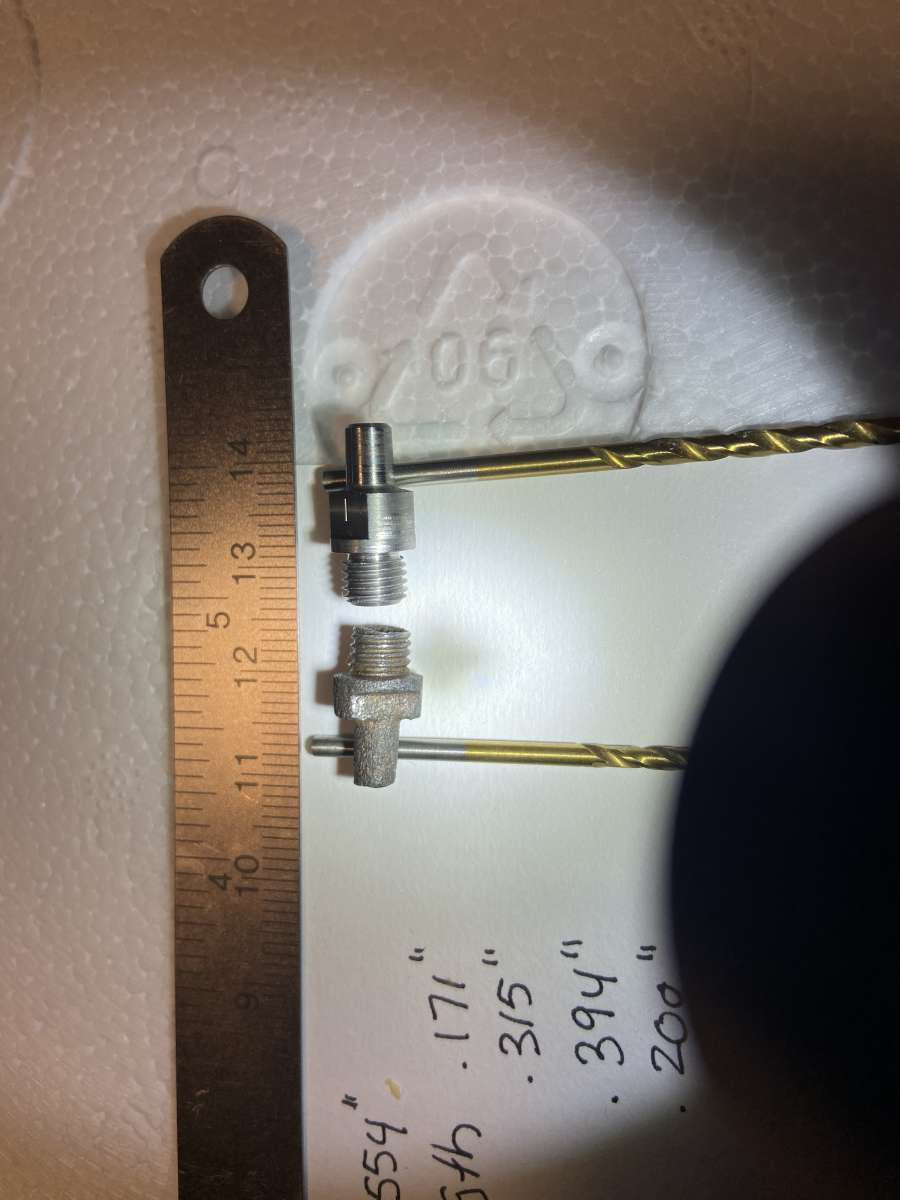

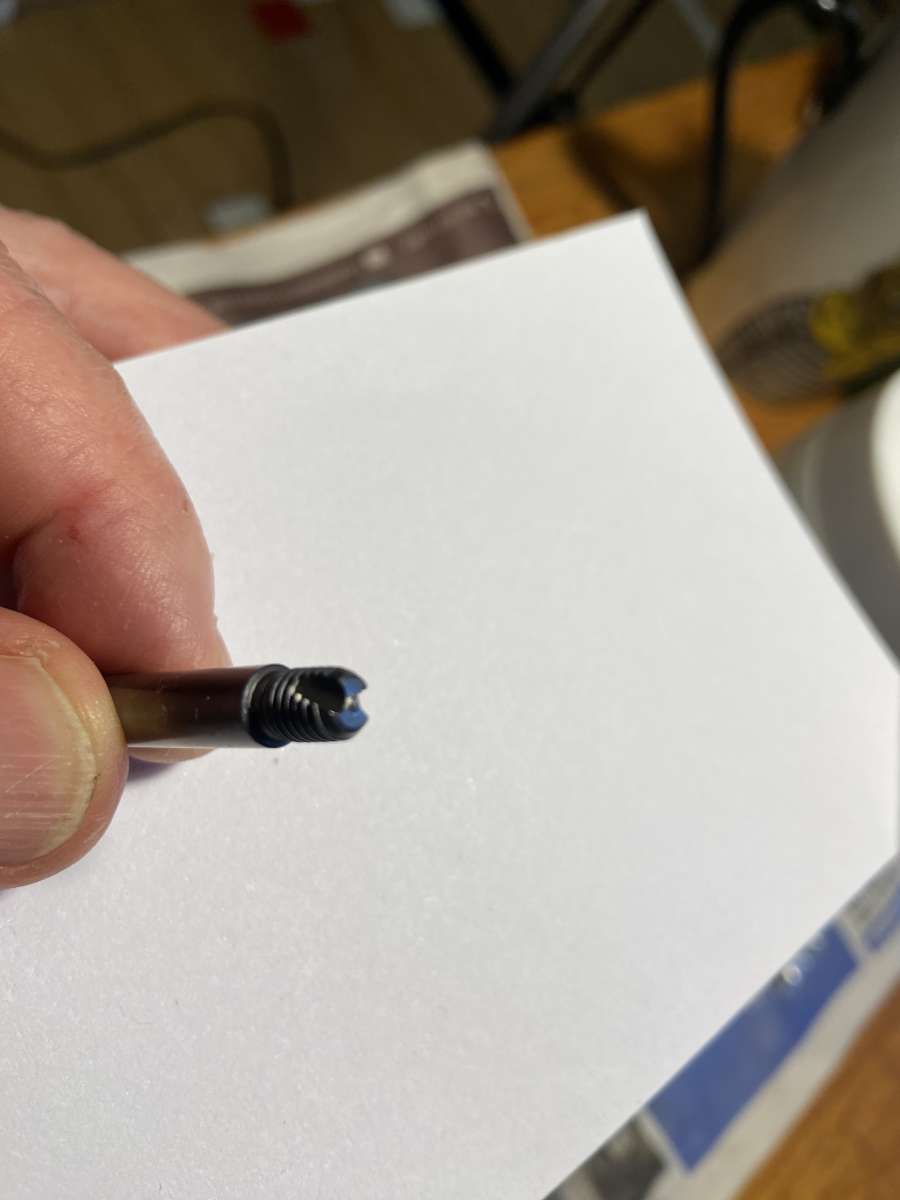

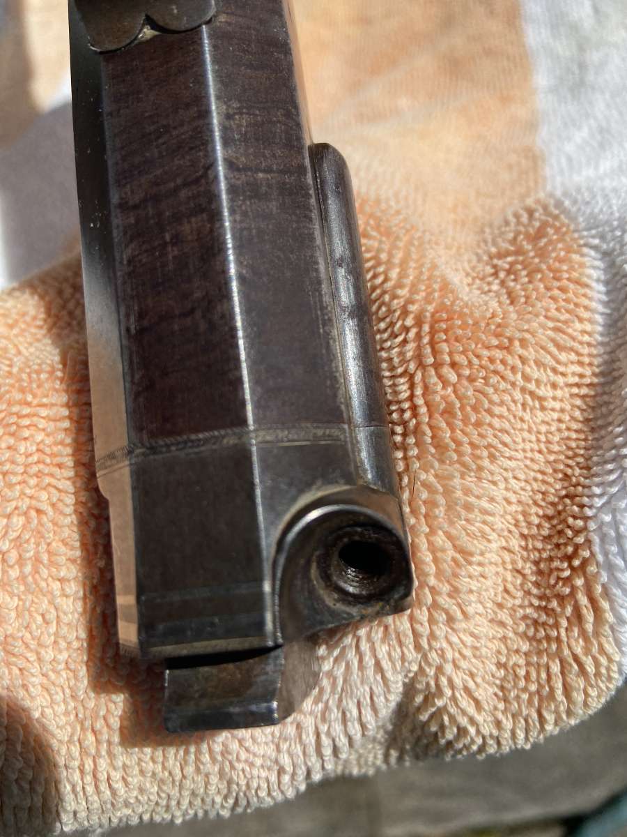

                                    berwick
                                      @berwick
                                      Thank you EVERYBODY, for your kind and comprehensive explanations and advice, to my questions. It has helped me turn a thread chasing tool that will be used to clean up the old, corroded non-standard female threads in the percussion cup.
                                      Upon thinking about things…. the fact that I do not know for sure if the thread pitch is exactly 30 tpi, depth of threads, or even IF the thread form is a 55 degree angle as I have assumed that it would be, secondary to inspection of the nipple’s tiny old threads with rounded roots and crests, under magnification.
                                      So, i thought it best to make a thread chasing tool / crude tap to clean up the gun threads, and to tap a small brass round “nipple holder” that will serve two purposes, the first being, because its female threads will match the cleaned-up threads in the gun, it will serve as a test fitting piece for when cutting custom male threads on a nipple. Secondly, it will serve as a nipple holder to be used in a ER 32 collet, when turning the cone-end of the nipple.
                                      I am at the stage where I need to determine how much smaller the nipple threads need to be made to hopefully make a Class II fitment of the nipple and gun.
                                      Is there a simple way of cutting this male thread to fit….. say…… starting with a smaller major? Or??
                                      I will be able to use the “test piece” nipple holder tapped with the crude tap, to test the nipple threads as the cutting is progressing. I just need to know what the starting major / minor ought to be. The exact same tooling used to make the chaser tool will be used for the nipple thread cutting.
                                      Yes, I know the calculation info can be found in the MH bible, but i don’t have one, nor do i have thread wires or a thread micrometer.  Also, this nipple will be the third thread that i have ever cut, and trying to figure different class fitments based upon measurements of thread diameter makes my head spin. Because this is a custom thread form, there are no published charts that tell me what the nipple major / minor dimensions need to be.
                                      Thank you guys. You are inspirational.
                                      Pics of my efforts to date:
                                      IMG_1656IMG_1652IMG_1664IMG_1650IMG_1646
                                      #853180
                                      alecs
                                        @alecs
                                        Well done you!
                                        Yes starting with a slightly smaller OD should work. Then keep test fitting with your female thread as you get close to full thread depth, taking fine cuts of one thou at a time until you get a nice fit.
                                        #853184
                                        Diogenes
                                          @diogenes
                                          I don’t know whether it’s my eyes, but the threads on the old nipple look coarser than the new one.
                                          #853264
                                          berwick
                                            @berwick
                                            No, your vision is not deceiving you…..
                                            The pic with two nipples shows the original one, and a new one that i had bought. It was 6mm x .75
                                            Because it was “close” to the major diameter of the original nipple, i had hoped that it might fit, but no love. I should have mentioned this detail in my post, but it was already getting long and wordy.
                                            I still need to make a nipple.
