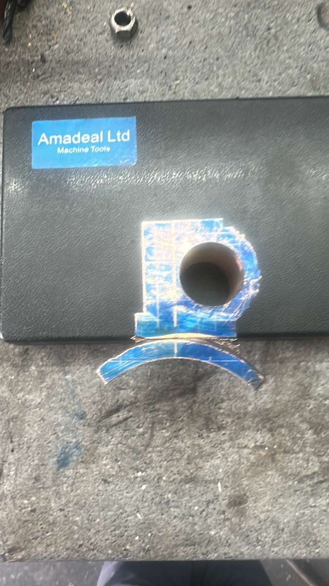

                      #853905
                      Nick Welburn
                        @nickwelburn
                        Hmm it’s been a slow process! But I got myself a new casting and set about it a couple of weeks back.
                        5C339470-D94D-4058-BB25-38C62F1B2D49

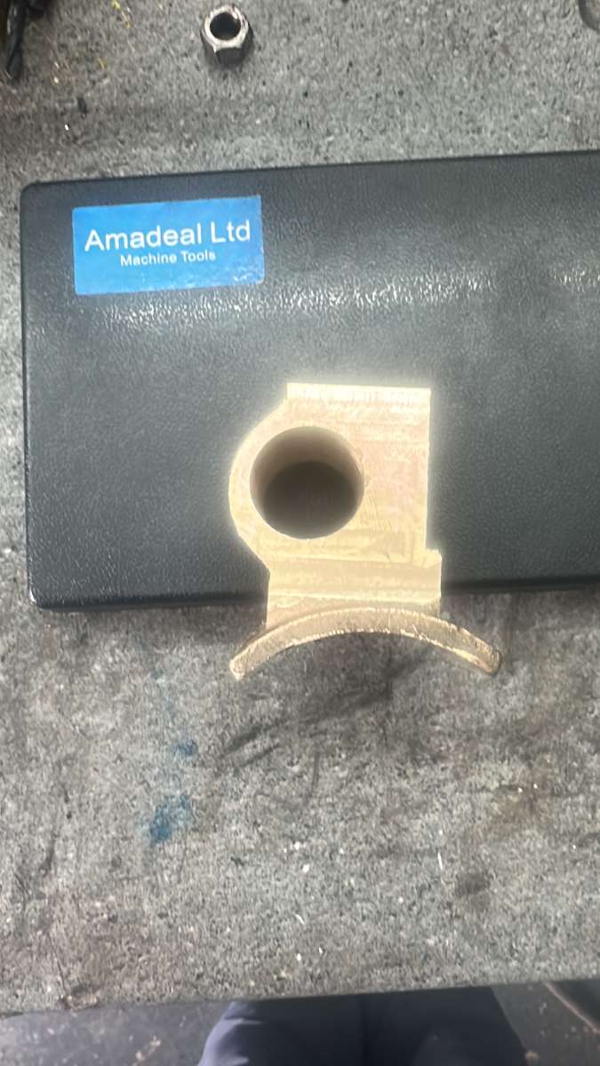

                        #853907
                        Nick Welburn
                          @nickwelburn
                          That looks pretty sorted… sits well on the boiler and it’s all pretty good and square.
                          Then I turned it over…. That wall is too thin… so I think I’m going to buy a block of brass and CNC out the top cylinder block and I’ll split this off the boiler mounting element of the casting.
                          That’ll save buying another £100 quid casting 🙁
                          Thiughts and advice welcome! 522D802B-6C63-42C8-A2F3-53EDC622F173
