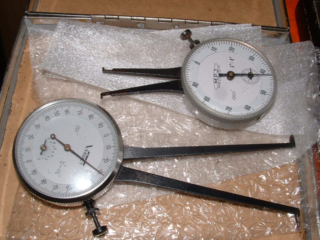

                                                  As well as Telescopic bore gauges I find these very useful for checking bore sizes by measuring over the ends at the displayed reading when inserted in the bore, also clearly show any taper in the bore.
