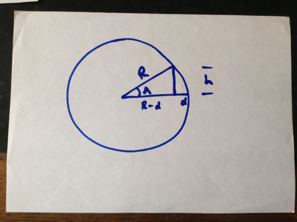

          I think that this is a case where everyone can be right about the effect of measurement height on the taper – it depends on the accuracy you require.
          To put it into perspective here are some numbers and the justification:
          R is the radius of the taper at the chosen section.
          h is the vertical error in positioning the measuring device.
          d is the horizontal error caused by h.
          A is the angle between sides R and R-d.
          h will remain constant for all measurements.
          What we want is d, the difference caused by h
          R sin A = h
          Sin A = h/R
          A = Inv Sin h/R
          R cos A = R-d
          (R cos A) – R = R-d-R
          d = R – (R cos A)
          So to put some numbers in, for a sharp taper and large height error:
          R = 10mm
          h = 5 mm
          A = inv sin 0.5 = 30 deg
          d = 10 – (10 cos 30)
          d = 1.339 mm
          Now at the larger end of the taper
          R = 20 mm
          h still = 5 mm
          A = 14.47 deg
          d now = 0.635mm
          So there is a radius difference of 0.704 mm, or 1.4 mm on the diameter.
          This is just to show that an error will occur.
          Now for MT2.
          Small dia = 15.3 mm R = 7.65mm
          Say h = 1mm
          A = inv sin 1/7.65 = 7.51 deg
          d= 0.065mm
          Large dia = 17.7mm R = 8.85mm
          A = 6.488 deg
          d = 0.0566mm
          Difference = 0.0083 mm on radius, or 0.016mm on diameter
          That’s 6 tenths of a thou!
          So measurement height does make a difference – whether it is significant depends on what you are doing!

            John – that's a pretty EXTREME case – 5mm tool height error on a 20mm diameter shaft!
            The figures that Geo Thomas was using were a tool height setting error of between 10 and 30 thou inch, on a 2MT shank. The 10 thou error causes an end to end diameter error of 6 hundredths of a thou on and a hollow on the shank of 1.3 millionths of an inch. The 30 thou tool height error causes about half a thou end to end and 12 millionths of an inch hollow – pretty negligable and probably within tolerance anyway – if you can measure it in the home shop.
            The point being made was that RELATIVELY SMALL errors in tool height or measuring height on a taper don't have very much effect at all – at the level of millionths of an inch, surface finish is probably as significant.

                  Keith – yes, it is an extreme case – but it was to show that there is an error. Your results may differ….
