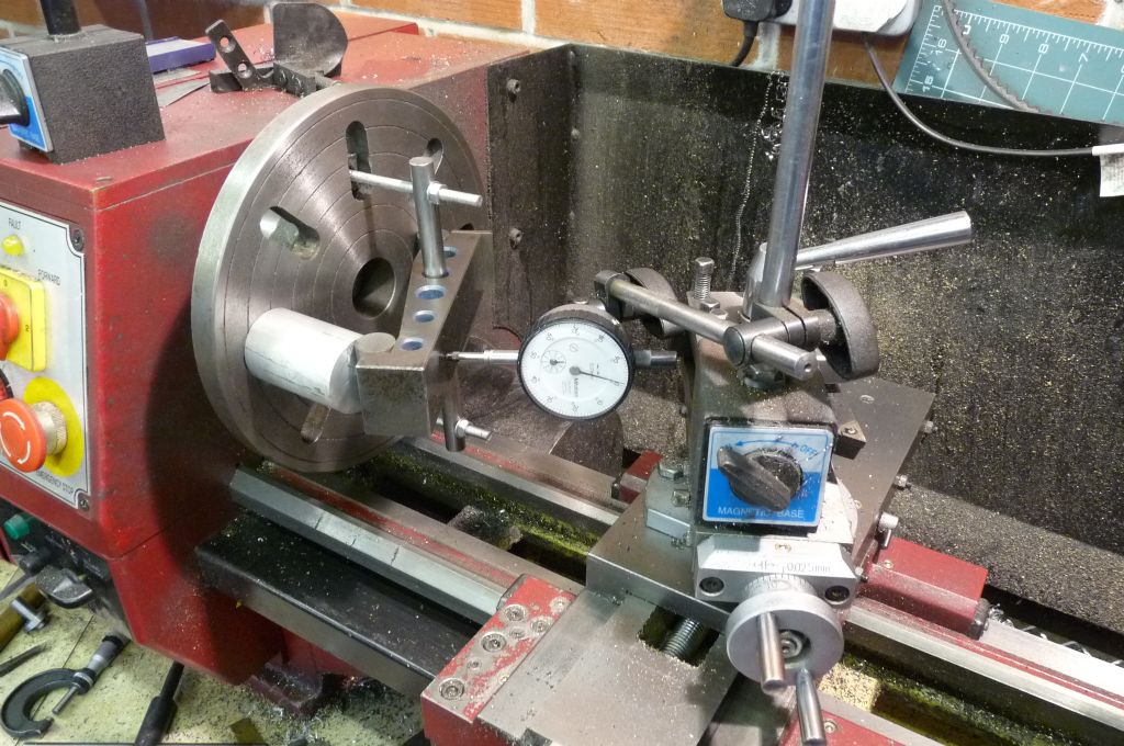

                        Not sure if this is the correct way of using a sine bar to set up the compound to a precise angle, but it is the way I did it and it did work:
                        The aluminium barstock was turned to the precise length for the sine bar to do its job. The clock is being used to set the compound to the same angle as the sine bar.
