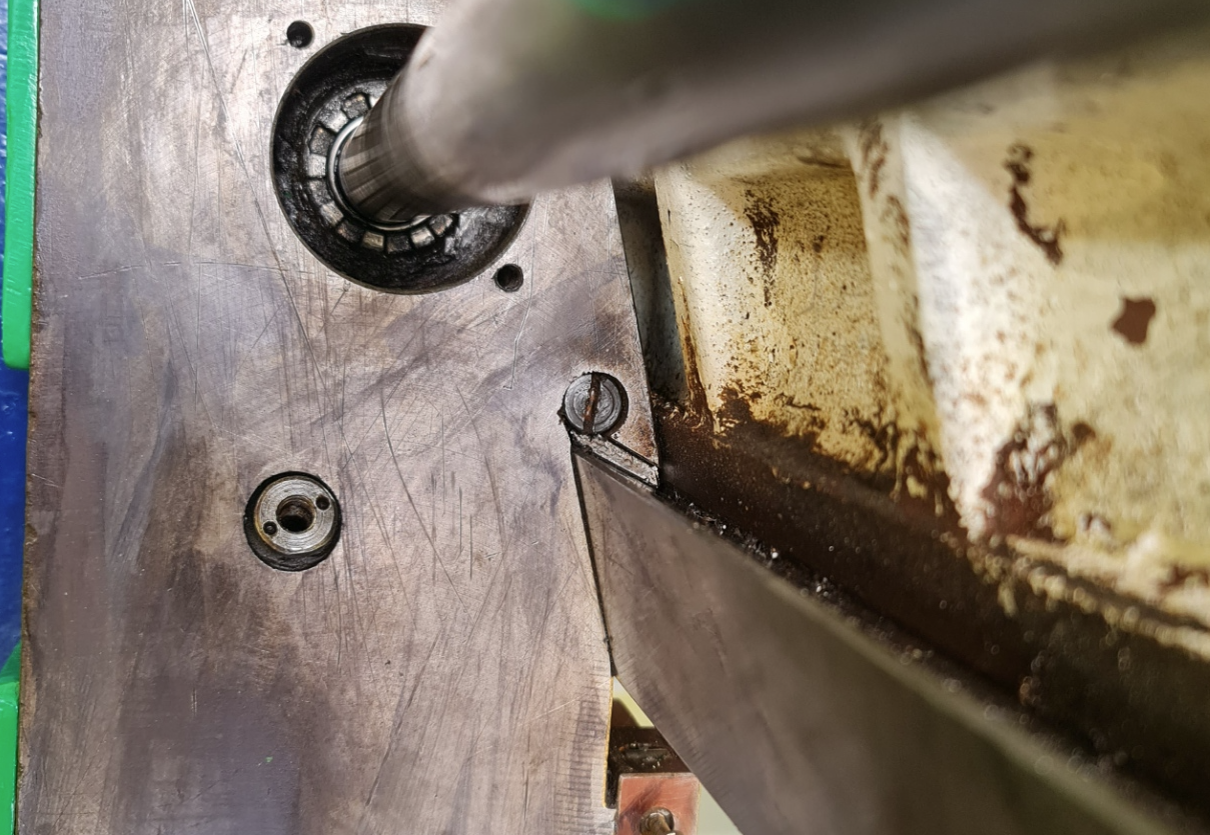

      I think I made a big mistake with my mill. It has tapered gibs that can be adjusted at both ends with screws. For X axis I forgot to mount the screws. Yesterday I was milling something and the handwheel was turning harder and harder. Instead of stopping I continued to turn it because I was close to finish. Now the X axis is completely blocked.
      I added the screw but it is not able to push back the gib. I tried to push the gib back with a hammer and a long piece of steel but is too stuck. Also I don’t want to hit it too hard.
      As a last resort with the screw pressing the gib I tried again to turn the handwheel. The gib pushed the top of the screw and bent it a little. Now I can’t unscrew it and I’m afraid it will snap if I try harder. That would be even worst!
      I’m running out of ideas. Any advice is welcomed!

        That looks like it could be the ‘thin’ end ?
        – if that is so, and the strip is bending the screw here, you are trying to take it off the wrong way and jamming it harder; take the other screw (the far end) out and try to run the saddle / table off the ‘small’ end of the gib towards the camera.
        – if that is the ‘thick’ end, then you need to remove that screw and drive the saddle/table away from the camera.
        Make sure you remove any lock screws for this axis, just in case they are fouling the back of the strip.!

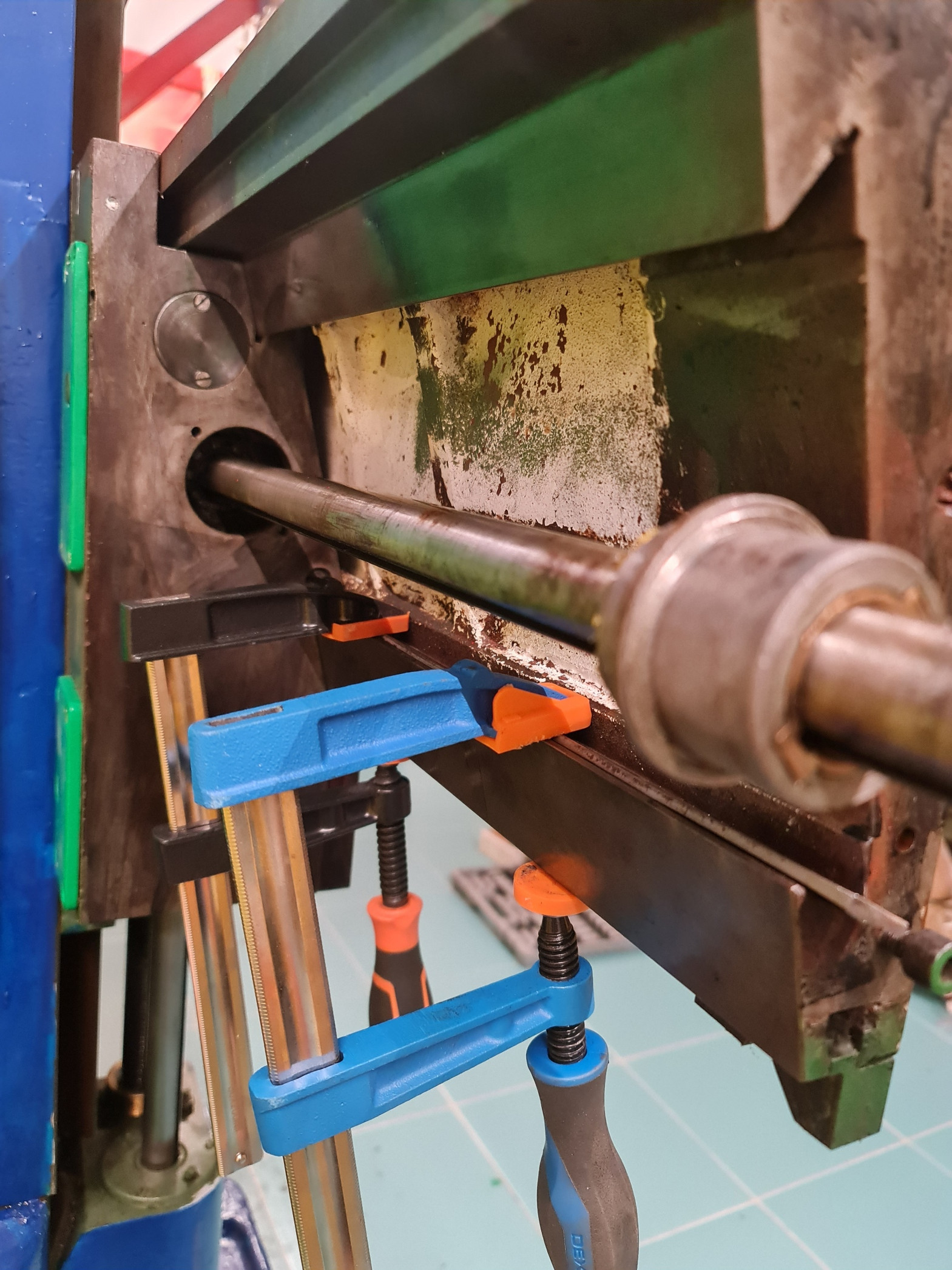

            The saddle is completely jammed. I don’t want to force the handwheel. It doesn’t turn at all and I don’t know how solid is the nut. But I found a piece of flat steel that is perfect for pushing the gib. I fixed it with two c-clamps so it doesn’t bend when I hit it with the hammer. In this way finally I was able to remove the gib!
            The bent lock screw was still there and even with the largest screwdriver it doesn’t rotate. But I was able to straighten it with the hammer. Just enough to remove it.
            I was worried that it might be a more serious issue. And using the hammer on a precision machine didn’t feel right. But in the end the problem was solved.

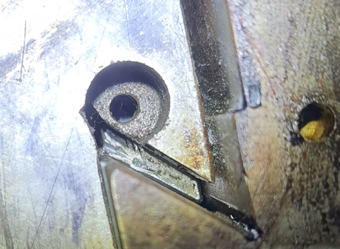

                    Now I have another problem. The thin end of the gib doesn’t reach the lock screw. It is not very visible in the photo but there are 7mm between the end of the gib and the closest possible screw position. If I push the gib harder the table gets stuck. And still the tip of the gib doesn’t touch the screw. This is weird.
                    I removed twice the gib and I cleaned it and put again some ISO 68 way oil on both sides. And I check with a flash light if there is no swarf in the channel but everything is fine. I can add a piece of metal at the tip of the gib to reach the screw. But I wonder how this machine ever worked?

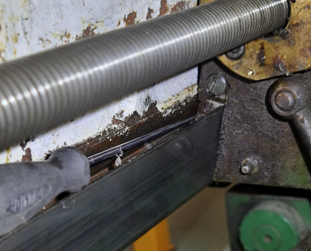

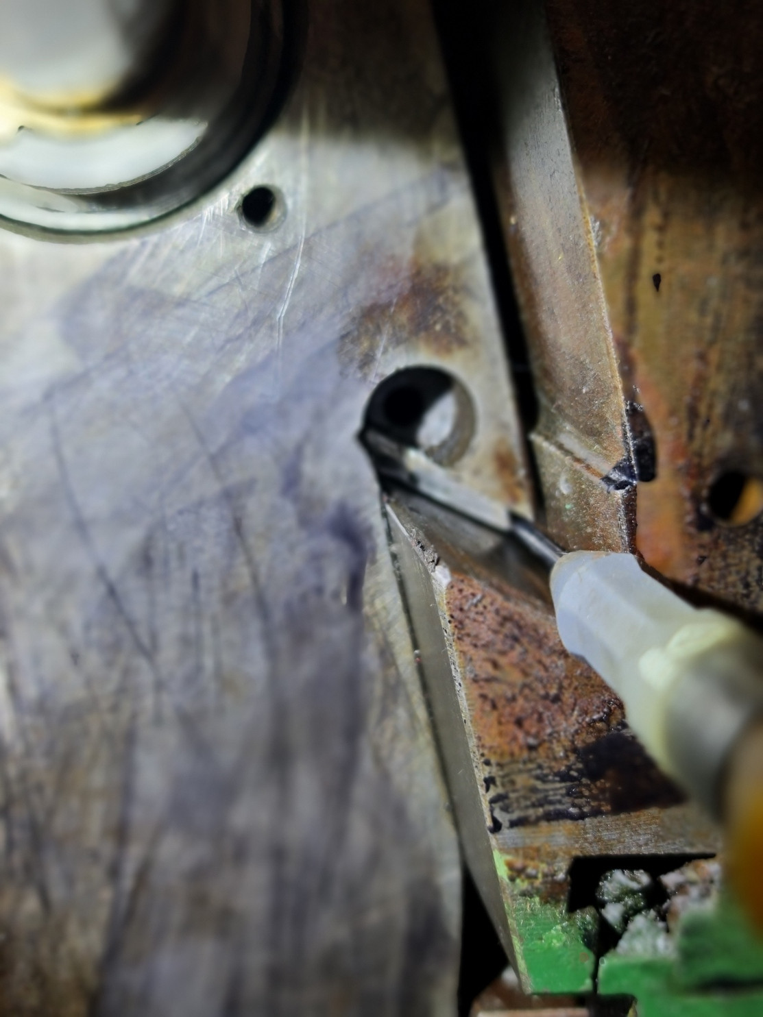

                      It seems that sometimes it is enough to describe here the problem and the solution becomes obvious. After writing the previous message I went to the garage and I put two screwdrivers at both ends to push the gib up. Or diagonally. Like in the photos. This created a lot of space and I was able to push more the gib toward the thin end. Now both lock screws are pushing the gib so I was able to adjust it. The table moves easily and there is no play.

                        Did the machine work OK before you started touching the gib and screws? Did the gib strip go all the way to the screw at that time?
                        It could also be swarf or burr etc on the other dovetail slide way on the other side moving the whole casting to one side and not allowing enough room for the gib strip.

                          Yes, that could be a reason indeed. But in my case the solution was to push the gib up with two screwdrivers at both ends. Now the gib is well within the adjusting range of both lock screws.
