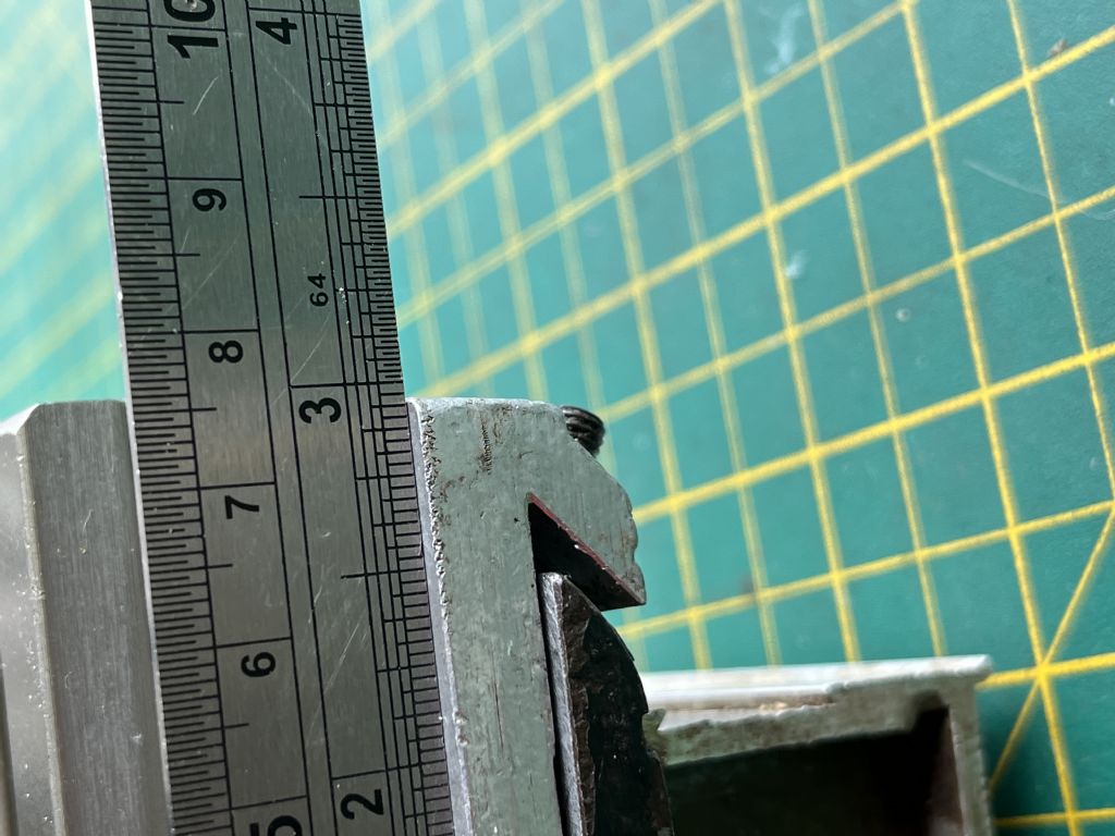

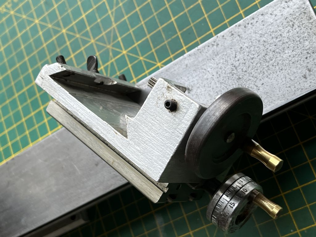

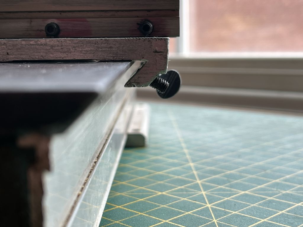

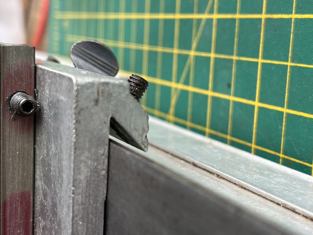

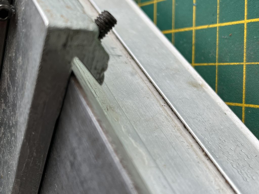

              e753d88d-858e-408e-a235-b9cab70c615d.jpeg552f842c-6f5c-4c42-9e3a-7d3675727eb6.jpeg8e163d3b-c747-45f9-b210-8c0084d6a390.jpegThank you for taking the time to reply.
              I would appear my carriage maybe a different model.
              looking at these pictures.
              On the Taig website the exploded diagram of the lath shows a different shape to the gib.
              thoughts on how best to proceed.

                  Posted by bernard towers on 16/04/2023 09:25:48:
                  looking at mine and measuring in situ its brass and 1/4' x 3/16 with the dovetail angle machined on one of the 3/16 edges. when you say you have spoken to the uk supplier, which one?. As far as I know there is the original man who came to the shows but I believe rotagrip are now involved and there is an educational company that sells them to schools in the cnc versions.
                  It’s the Rotagrip company I contacted.

                        That looks pretty simple to me, just a bit of brass strip with an angle filled on to it!

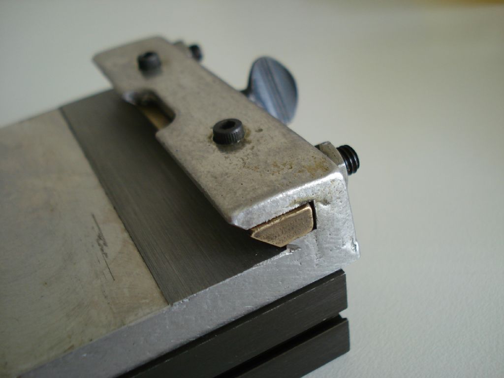

                          This is my type of Gib in my Taig lathes. I replaced it with Turcite and it made it so much smoother than the original brass. There is a guy who make cue lathes based on the Taig system, and he offers a Delrin gib, that I am told makes them alot smoother too. The Delrin does wear, and makes the bed last alot longer. Which is usually Hard annodised Aluminium extrusion.
