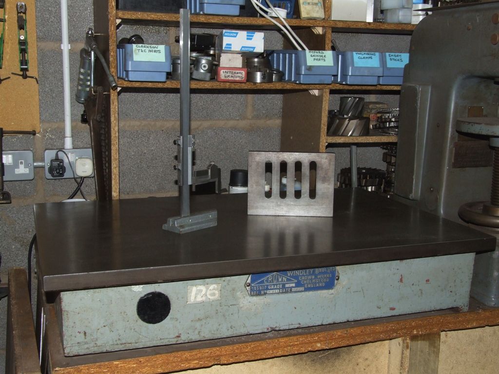

                                          I chose to buy the following, all from Ebay at a total cost of less than £150 including delivery of the 3ft x 2 ft surface plate from Nottingham to Cambridge for £40:
                                          The vernier height gauge is dual scale and was made by Etalon and the surface plate is Crown Windley.
                                          Andrew

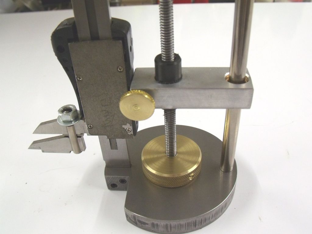

                                                    When I wanted a height gauge I made one ! I used a digital vernier, one of the cheap Aldi one that they sell for about £8. A few bits of scrap, a couple of salvaged bearings from an old hard drive. More than accurate enough. My surface plate is a piece of broken granite headstone.
                                                    Here is a picture, I did a build log for this a couple or so years ago.
                                                    That brass knob drives the M6 leadscrew. A nice fine 1 mm per turn which you can actually measure on the readout.
                                                    A close up view.
                                                    More pictures in my album.
