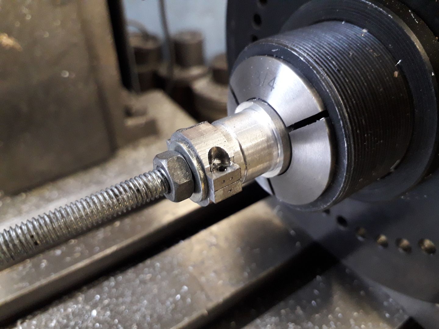

                          #606053
                            Machining the pedestal and caps
                            Now that we have some easy to hold blocks of known size it will be quicker and easier to do the remaining work.
                            Add the vice stop and grip the base material while packed up on parallels and locate it's centre. I do this by locating opposite faces and halving the reading on the DRO, if you have an all singing one do this on the absolute.
                            Spot and drill sufficiently deep for the 3BA clearance holes
                            Remove, deburr and then rotate 180deg keeping the same face to you and spot, drill and tap 5BA (I'm using M3 for this demo)
                            If you have a handwheel or basic DRO then relocate the caps centre, if a better DRO move 0.375" towards the stop and switch to incremental and zero X at that position. You can then keep the stop in the same place to locate the cap while toy drill the two 5BA clearance holes and a 1.5mm oil hole right through
                            No pic of that
                            Change to a 1/4" milling cutter and zero it's height on the parallel packing, raise up 0.250 and then take full height cuts to produce the two flats that stop 0.319 from the middle so 0.444" to spindle ctr
                            Without altering the height come in from each side on Y0 to a spindle position of 0.375 which will gibe the "spot face" around the hole. repeat for opposite side
                            raise the cutter, position spindle at 0,0 and plunge down to a height of 0.350 which forms the pocket for the threaded boss.
                            You can then deburr all the holes and assemble with a couple of screws while holding the two parts down on a flat surface to keep then sitting true
                            The assembly can now be treated as one for some time. Hold with the bottom against the fixed jaw and on parallels then drill a small ctr drill hole 0.625" up and on the centre line for length.
                            That will do for now.
                            Edited By JasonB on 16/07/2022 14:51:57

                                  ROUNDING THE CAP
                                  A simple way to round the cal is to make a series of cuts at angular increments and then just blend the cuts with a file.
                                  Rest the cap on a pivot, in this case a 3mm spot drill and bring the cutting tool down onto the top. Lock Z.
                                  Bring the vice towards you and then reposition the cap at a slight angle while still supported by the pivot. Approx 5deg will do
                                  Feed the cap into the cutter and then back out and you will have a slightly angled cut
                                  keep doing this until you can't cat any further without hitting the flat area where the nut sits, you will have to move the work sideways as to get the best position.
                                  Now repeat for the other side of the arc which will give you a part like this.
                                  A quick swipe with a file will blend the facets into a single curve
                                  The bearing can now be assembled into the pedestal and the oil hole extended down through the bearing and right into the bottom half. A short length of brass rod is loctited into the hole in the bottom half of the pedestal so just a small amount sticks out which will act as a peg to stop the bearing rotating.
                                  All that remains is to drill and thread a bit of 1/4" material to take the oil cups and then part off two short lengths that can be bonded into the top of the cap. Use a needle file to take off all external corners and fillet internal ones if you want but there is not much room for a 3BA nut on the foot.
                                  here it is up against an overtall Stuart one that I had knocking about a sit did not get used from a part built engine I was given

                                              Made some washers and bolted the halves together tonight:
                                              Planned to do more, but thwarted by other mundane tasks again.
                                              I’ve got a 6mm, 1mm corner radius cutter. At full depth, the shank would touch the edge of the cap. I was wondering if this might be a good thing as a kind of gauge to prevent cutting into the cap side – they are already right on the edge of being too small. I’d increment in until the shank just scraped the cap end?
                                              #606387
                                                I did think of a 1R cutter but the fillet would have encroached on the 3BA washers I have so just went with a square internal corner that a fillet could be added to if desired. It's also a long stick out for a 6mm cutter to clear the cap and reach down to the foot.
                                                Just put a sharpie mark on the side of the cap and creep up to the final cut.
                                                EDIT Flute length is 12mm so won't do 1/2" full depth
                                                Edited By JasonB on 19/07/2022 09:05:14

                                                    Dr_GMJN
                                                      @dr_gmjn
                                                      So I made a bit of progress, but paused to evaluate: This is current state of play with the first one after centre drilling, mating marking and side milling:
                                                      But unfortunately I went a bit far with the side milling on one side, damaging the washer. It means the bolt head points are right on the edge of the spot face, which doesn’t look right:
                                                      Trouble is, turns out it needs to be like that in order to fit the mounting bolts (nuts):
                                                      The other side cap looks ok:
                                                      …but the mounting nut doesn’t fit:
                                                      So it needs milling back to be like the other side.
                                                      I guess I could make the cap washers even smaller, and turn the nuts down to shave the points off, but would that look right?
