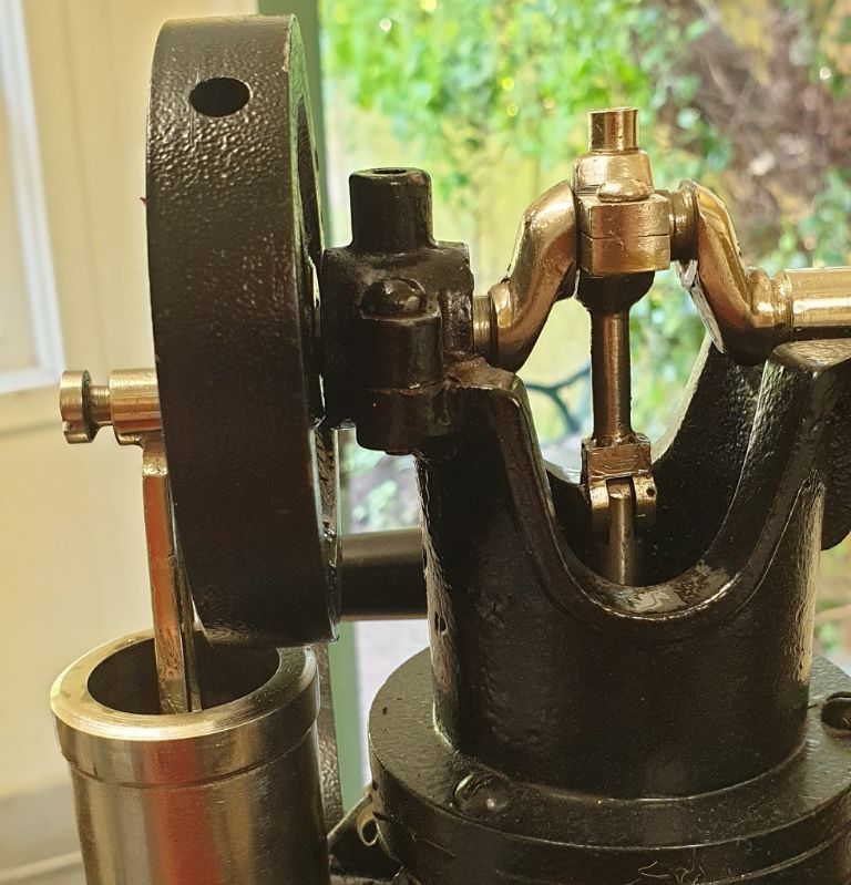

      Good evening,
      This afternoon I have been trying to sort out an Indian made Stirling engine fan. When it arrived it was clear there were issues and so far I have sorted the main (?) one which was a bronze bearing was out of place causing binding. Its now pretty free running, I am aware Stirling engines in general can be quite sensitive in this regard. However the engine is not yet running. The flywheel is attached to the crankshaft by a socket grub-screw through its rim but there is no indication as to where on the crankshafts circumference it should be secured. I have photographs showing the crank is in the uppermost position and the flywheel, which I have tried at various points, so I could really do with some advise as to how to align the engine parts in question as this affects the piston position.
      I should add that at one point it felt like it wanted to run but did not quite, but backwards. Any help would be much appreciated.
      Chris.

          Try adjusting 180° out and note the change.
          #466877
          Hopper
            @hopper
            Usually the crankpins are set 90 degrees apart. Looks in your last pic like the displacer crank is at TDC but the power pistons crankpin is at about 4 or 5 o'clock, so a little bit out. Maybe try moving the flywheel so the central displacer crank is at top dead centre and the flywheel crankpin is at 3 o'clock.
            From memory – which is vague – the displacer (centre in this case) crank leads the power piston by 90 degrees. So if it runs the wrong way, as Mark says above, move the flywheel 180 degrees to reverse the direction.
            Two things stop Stirlings from running mostly: Friction that absorbs the little available power. And leakage around the displacer con rod seal or around the power piston or at some point in the connecting ports etc.tini
            The fan looks like a beauty. More pics would be much appreciated. Let us know how you go getting it running.

              As hopper says 90 deg would be a good starting point and the displacer leads

                Is the fan well balanced? I see it has a large flywheel to smooth out the running, but that looks to be a large fan. Even the flywheel may not be too well balanced either. Every little bit helps with Stirling engines.

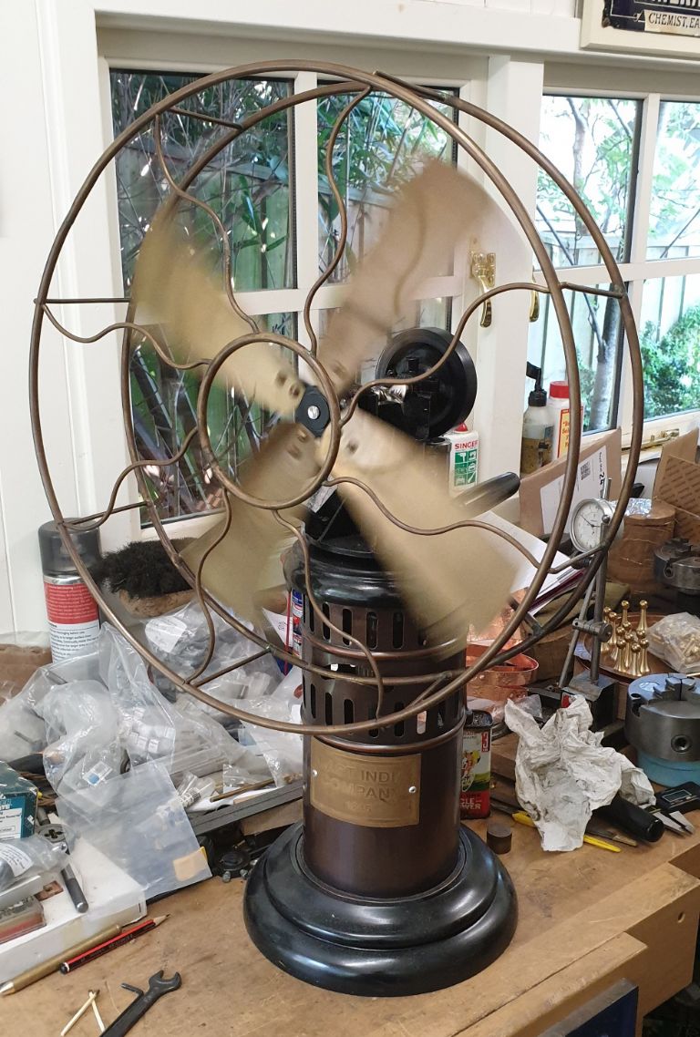

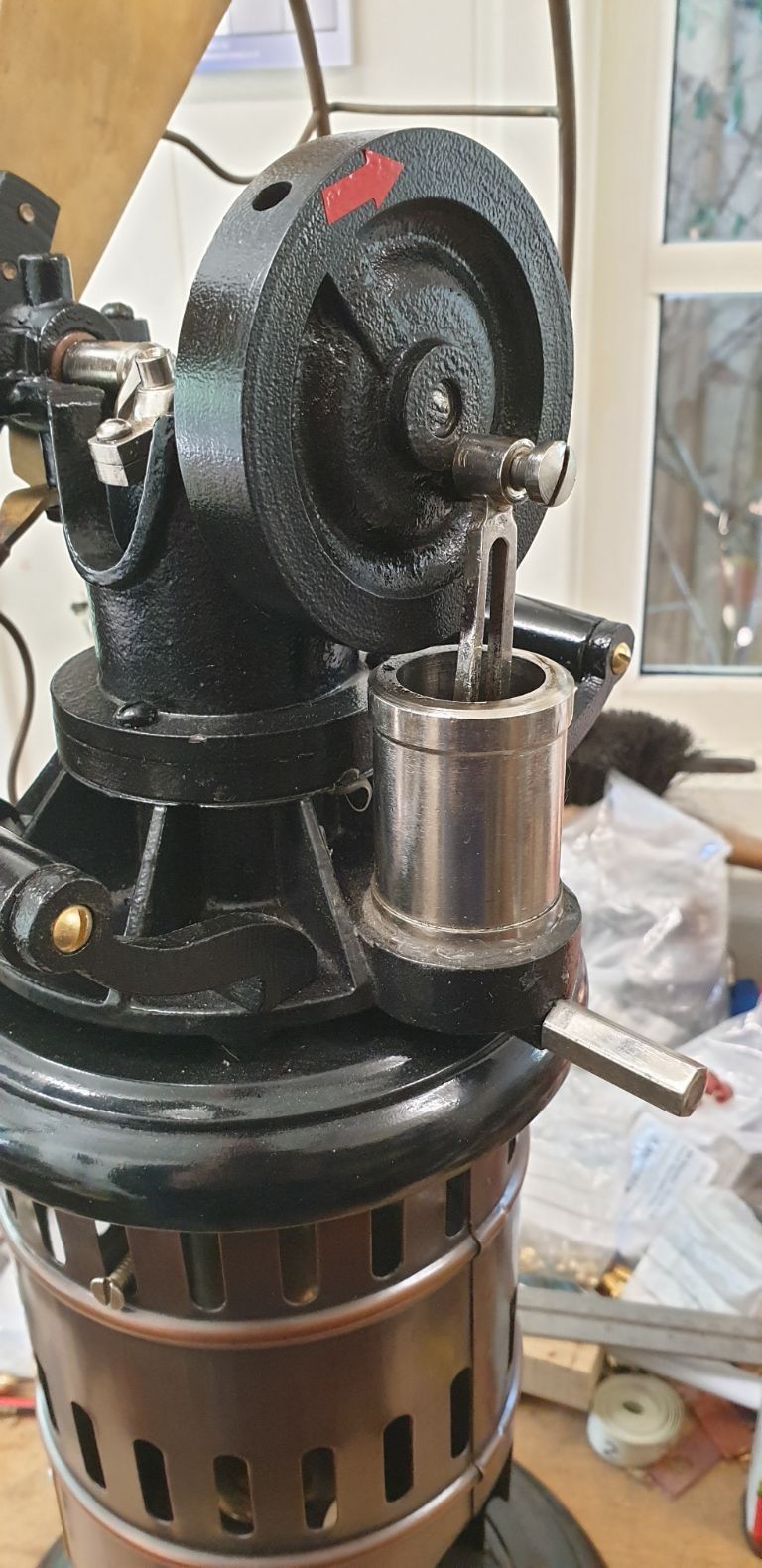

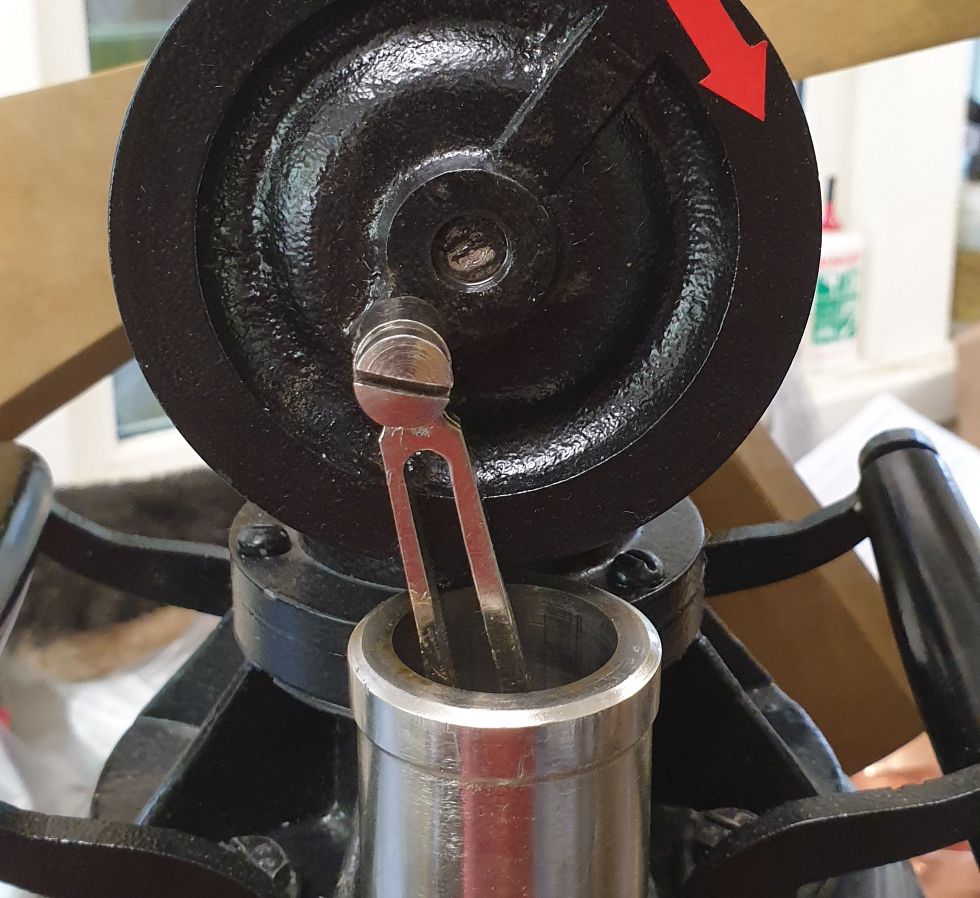

                    Ok Progress! (-: Thanks again to all so far, especially Hopper for going into detail, as a novice engineer spelling it out to me is what I needed!
                    This morning I set it at TDC & 3 o'clock and off it went…backwards. Re-set at 9 o'clock it ran forwards for maybe 5 mins…happy as a happy person can be (me, not the fan). I tinkered with the positioning and got a second run of similar time. Then I could not get it going again. Even though there seemed to be a decent flame still I tried putting more meths in and then I got a good run of maybe 15 mins, then it stopped. After lunch I will try with the remaining fuel, if it doesn't start I will refill the burner in case its fuel hungry.
                    Ok its now after lunch and restarted it ran for 15mins, so it wasn't low on fuel. Inside the vented body there is a funnel which you can adjust up and down, as it was at its lowest I raised it but could not get it to run. So lowered it again and topped up the Meths and it ran for about 45mins.
                    Seems quite temperamental!
                    More photos as requested, I took a video but don’t see how I can upload it??

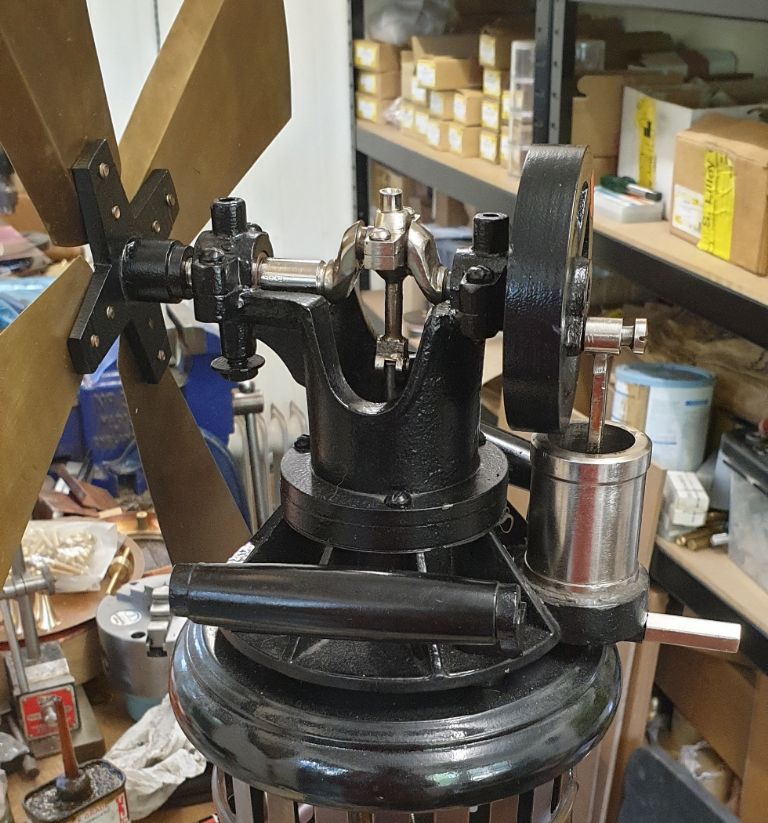

                    Two more questions, the hexagonal bar horizontal to the power cylinder, any ideas what that is?

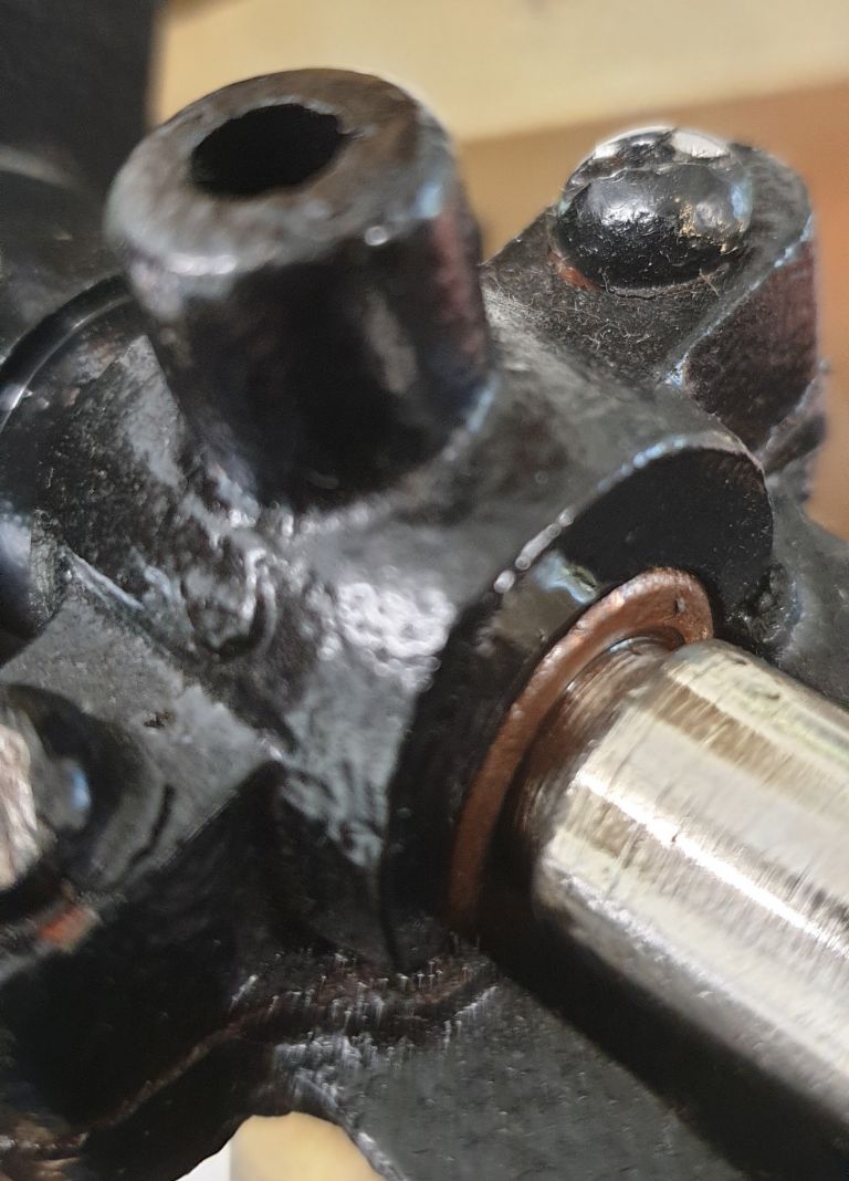

                    As mentioned one of the bronze bearings was out of alignment, when I removed the clamping plate that secures it (does that part have a name?) I noticed that whilst it has an oiling hole cast into it there is no corresponding hole through the bronze bearing.
                    To my mind there should be, otherwise the oil will mostly only travel down to the outside of the bronze bearing bush, not to the crank. If I should drill the bronze bearings what sort of size hole please?

                      It looks like a sintered bearing (oilite type), so no problem?

                        Very nice fan you have there, Chris.
                        I think that the hex. bar is just a plug. Take it out and you would find a hole connecting the power cylinder to the displacer. Unless you are desperate to find out if I'm correct (or not), I would leave it in place, especially now you seem to have it running well.

                          As Hopper says, Stirling engines seem to be very sensitive to friction and leakage.
                          Really, the power is provided by atmospheric pressure acting on the underside of the power piston as the air on the other side cools, so not a huge pressure differential.
                          If the engine comes to a halt after running fro a time, maybe heat soak is taking place and the temperature differential is decreasing. Although the increasing times suggest that maybe it is running in and friction is decreasing?

                            Thanks Not done it yet & Dave,……My understanding is sintered bronze(?)/ oilite is oil impregnated bronze, so no need to drill through, but still add oil which will seep through the bearings to lubricate the shaft?

                                    I wonder if the hex fitting is a speed control that you screw out to let a bit of pressure out of the system to slow it down? If not, then just a plug for the drilled passage as suggested.
                                    Sounds like typical Stirling engine running for a period until the heat from the hot end of the displacer cylinder creeps up and heats up the cool end. The engine runs on the temperature difference between the two ends of that cylinder. So sometimes, the smallest flame possible will run it for the longest becuase it takes longer for the cool end to get overheated. The cone you mentioned may be for the purpose of keeping hot combustion gasses away from the cool end so some adjustment there might help?
                                    She looks like a beauty! Is it an antique or are they still available in India?
                                    I think they work on the principal that in the humid tropics a bit of extra heat from the burner is more than offset by the breeze from the fan that helps the sweat on one's brow evaporate and cool the body.

                                          Thank you Hopper, I took a look to check this morning at the hex part and although it appears to be screwed in place it doesn't want to move by finger pressure alone so I will leave it as is at least for now. It may well be a plug as suggested but seems to me odd that its so large, and the shape does not suggest to me its a knob as such for adjusting.It continues to the other centre cylinder as far as I can see, but as I say appears to be a separate part ie screwed to the rest of it.
