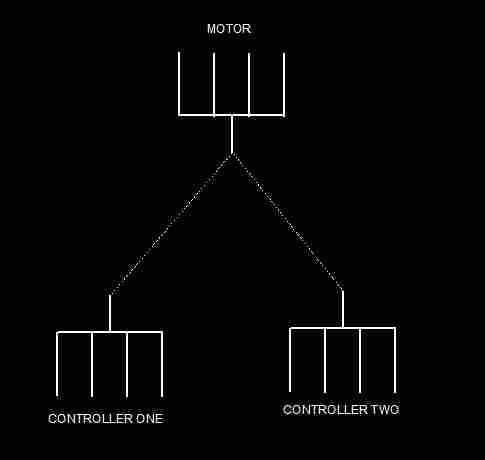

                              Thanks for all the comments. I don't think lost steps are a problem. I've reduced the speed to about 60rpm to reduce the acceleration when starting each step and the registration pin on the head engaged the built in indexing plate at 0 degrees before and after 40 steps of 9 degrees each.
                              If I was confident of programming the Arduino I think I'd follow Duncan's approach and calculate the number of cumulative pulses for each tooth as the gear is cut, subtract the total for the previous tooth and round it to the nearest integer.
                              Alas I'm not. I have tried for years to get my head around programming the Arduino but I've got a teflon brain that nothing computer oriented will stick to. I'm in the frustrating position of understanding enough to see what can be done but not being able to do it.
                              That's one of the reasons I'm keen to stick with the simple solution I outlined in my last post. I take the point that it's probably not wise to do all the residual pulse correction on consecutive teeth but rather spread them out over the whole tooth. I can do that by using the two outputs from the Stepduino as I outlined earlier. I need some way of easily swapping between the two outputs as the gear is cut. My first thought was to have a plug from each of the outputs and switch the motor plug between the two at regular intervals throughout the cutting operation. It would be better however to have a rotary switch between the controller and a single plug. The operation of the switch would need to carry out the operation shown in the photo.
                              It would need to switch the 4 wires of the motor between the 4 outlets from controller one and the 4 outlets of controller two. I don't know what the name of such a switch is which makes it hard to find out where to get one. Can anyone tell me?
                              Regards,
                              Alan

                                Alan, I'm afraid that won't work, for two reasons. First, stepper drivers do not like having their outputs disconnected when energised and may just retire from the fray. Second, when you disconnect the stepper it will jump to the nearest whole step from whatever microstep state it was in so you will lose the accuracy you are trying to achieve.
                                I suggest that you should look at the software that was written for the Arduino divider controller described in MEW. I'm sure someone here can point you to it. If that works anything like my Ward indexer, you just configure it with the number of (micro)steps per full rev of the divider head spindle, than tell it on the mmi how many divisions you want and it does all the rest for you. Or you could just go to **LINK** and buy one of his controllers as I did. You would need to buy a stepper driver but as I pointed out those are very cheap and easy to get.

                                  Posted by John Haine on 28/10/2018 09:42:29:
                                  Agreed. Also, as I know to my cost, there's a third reason! My stepper-controller connects the motor via a 5-pin DIN connector. If the motor is plugged after the unit is powered on the resulting electrical misbehaviour is enough to corrupt the Arduino's memory, and the Arduino has to be reloaded from scratch.
                                  The MEW Article is based on Gary Liming's original and it was widely discussed on the forum. I think I'm correct in saying that Gary's code doesn't correct for rounding error, no doubt because usually it doesn't matter. (See my earlier post showing how the error is distributed.)
                                  An alternative is my stepper which uses a keypad rather than nested menus. As a result of your question I will modify it to minimise rounding error later this week. Unfortunately the hardware build instructions aren't newbie friendly because they're out of date.
                                  Neither my effort or Gary's would transfer easily to the StepDuino hardware because they both use input buttons.
                                  If I were you, I'd write some simple code to drive the StepDuino and try it. There's a good chance rounding error won't matter in practice.

                                        I'm not worried about plugging and unplugging the motor as the way I have it set up is that the power to the stepduino and motor is only on when the button is pressed i.e. the power is off, the button is pressed which supplies power, the motor advances the set number of steps, the button is released and the power is off again. I like this way of working as I can do as many teeth as I want then leave it and come back again the next day and continue where I left off. I'm not sure if that applies to the other programmes that are around.
                                        I wasn't aware that each time I put the power to the system that it will restart at the beginning of a full step. I'm not sure that this matters however. As long as each pulse produces the expected rotation, and the number of pulses are correct to give the rotation required, I don't think it matters whether the new rotation restarts from the same stage during a step or from the beginning of a step.

                                          Alan, I think you are not aware of some of the fundamentals of steppers and what you are doing in your last post is not viable.
                                          I am also confused as to how you are driving the stepper – in your earlier posts you intimated you had set the controller to 4800 steps/stepper revolution and later in the same post you state 1600 steps/revolution, so not sure what it actually is. Nevertheless, it appears you are microstepping. In such a mode a specific index position, eg, tooth number 111 of your 127 tooth gear, may place the stepper rotor between the full step magnetic detent ( what you feel when you rotate the motor by hand..) of the motor. At this point the RMS current flowing in the two stepper windings is balanced such that the resulting electromagnetic field keeps the rotor in that place. Turning off the power removes that field, and the rotor will wish to rotate to the nearest magnetic FULL STEP detent position, In other words you have lost the microstep position FOREVER. The next time you power on the driver, the rotor will just stay put, or move to the nearest detent if not there, and you have lost your microstep position – you will never keep accurate index positions this way. You CANNOT turn off the power to the system while indexing with a stepper, which is not an absolute reference device.
                                          This has been pointed out as you acknowledge it in your second paragraph, but you seem to think the misplaced position will not have any deleterious effect..It sure will! If the rotor was say midway between full steps when you turned off power, and the rotor naturally moved to a full step detent, say the one just before the current half position. The next time you turn on and do the Nsteps for the next tooth, it will step Nsteps from the CURRENT detent position, not from the desired midpoint position where it was when you removed power previously. You will end up in the wrong position.
                                          ' As long as each pulse produces the expected rotation, and the number of pulses are correct to give the rotation required, I don't think it matters whether the new rotation restarts from the same stage during a step or from the beginning of a step.'
                                          The last part of your sentence does not make sense..the rotor position is ALL that matters, and it has to be at the correct start position for it to end up at the correct NEXT index position after N steps..starting at a random position will set the rotor at a new position that is the correct number of steps away, but it is still the incorrect position!
                                          With regard to slowing the stepper down – you did it by increasing the length of the pulse on time – normally the stepper drivers require a pulse period of 1us to 10us – some controllers go into a 'low-current' hold mode if the pulse on time is excessive, or if the time between pulses is long ( normally seconds..). To slow things down, it is normal to add a delay between step pulses..
                                          Joe

                                            As Joe explained, I'm afraid your switch-off plan won't work. Top marks for cunning though!
