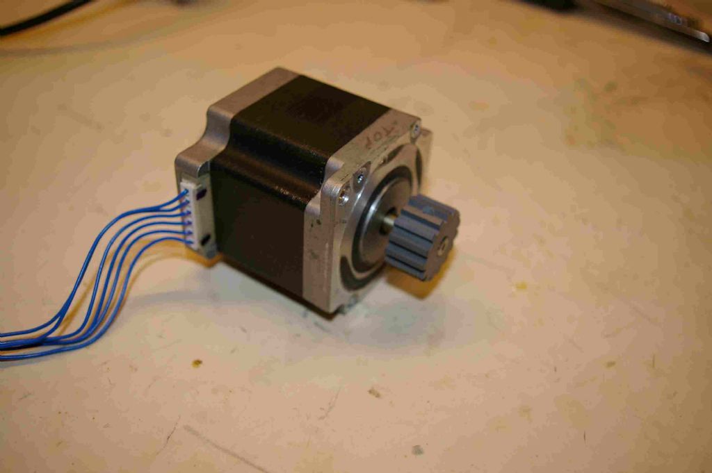

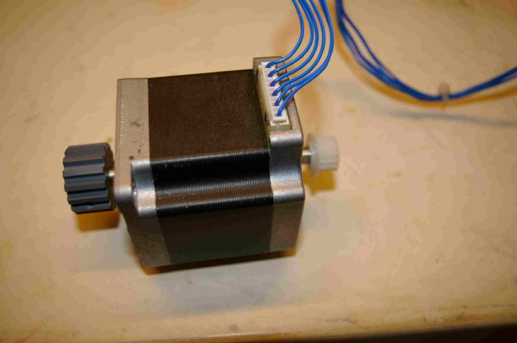

      Hi,
      A couple of years ago I bought a second hand stepper motor with the intention of using it to position my vertex dividing head and speed up cutting gears. I have a StepDuino to control it. It is a KH56 series motor with the first part of the serial number being KH56KM2. I have found a spec. sheet on line for this model but the last three numbers quoted are -911, -912 and -913 whereas the last part of the serial number on the motor is U037. I presume the U stands for Uni-Polar (there are 6 wires coming out) but the 037 doesn't correspond to what's on the spec sheet. The difference between the last three digits seems to be the motor voltage which changes from 2.3V (3.0A) to 3.6V (2.0A) and 6.71V(1.0A) with the power being about 7 watts for the three options.
      Can anyone help me determine what voltage I should be applying to the motor? I'm a complete novice with these so don't assume I can see the obvious.

          The first thing is to use a multimeter to check the windings. I would guess that it has two centre tapped windings, which can be used with unipolar or bipolar drives. You want to use the latter nowadays. For this you need to find the centre taps, and then not connect them but use the ends of the windings as a1, a2, b1 and b2 as in the stepduino guide.
          The motor voltage is a red herring, what matters is the current. If you use a modern driver it will typically need around 24 volts upwards and will allow you to set the drive current to what your motor needs. The Stepduino has two such drivers installed. I assume it has a facility to set the maximum current. If you start at 1 amp you can't go wrong. If you don't get enough torque and the motor isn't getting too hot then turn it up. Forget the voltage, that will be taken care of by the driver.
          Can you post a photo of the motor?

                That's a NEMA 23 motor – 2.3 inches.
                Looking at the Stepduino schematic and the driver IC datasheet the current is set by two sensing resistors on the board and a potentiometer which allows adjustment. It doesn't say anything about what that should be adjusted to, but from the component values and the driver datasheet the maximum current is about 2.5 amps. So if you could find VR3 on the PCB and adjust it to about half-way the current would be ~1.25A which would be about right.

                  Thanks John. I've measured the resistance across the coils and figured out the configuration which happily coincides with the data sheet. Now for the bit I'm not looking forward to – relearning how to use the arduino. I wish people wouldn't keep on about how easy it is to use – it's not.

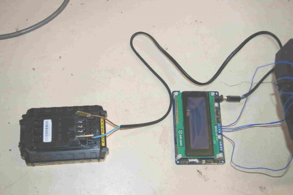

                            Thanks John. I think I'll try hooking up the battery and using the sample sketch on the Freetronics website. If it works I'll have at least managed to get a stepper motor shaft to turn which will be a great leap forward. After that I think I'll use my standard Arduino and follow the multiple tutorials around on how to run stepper motors.

                                I've managed to get the shaft of the stepper motor to spin using the example sketch shown on the Freetronics website!
                                The sketch wouldn't compile but I think the problem was at the end of the sketch where there was a section which froze the shaft in one position. I deleted that part of the sketch and the bit that was left which turned the shaft one revolution forward followed by one revolution in reverse compiled OK.
                                I had a bit of a hiccup when connecting the motor to the controller. There are six wires coming from the motor so it can be used as a unipolar motor. The controller has only four connectors so the motor needs to be connected in bipolar mode. I assumed that the centre tap wires would be ignored but the motor data sheet showed the connections to be from the centre taps to one end of each of the windings for bipolar operation. I tried this and the motor just buzzed so I connected the ends of the windings and left the centre tap wires loose. The motor then did what it was supposed to and rotated back and forth. I had a bit of a play with the sketch and changed the speeds.
                                Anyway, at least I've got the motor to turn, I know the motor works and how to connect it to a controller so I'm making progress. I think I'll take John's advice and revert to using a standard Arduino for the time being. When I get more proficient I may be able to make use of the Stepduino.

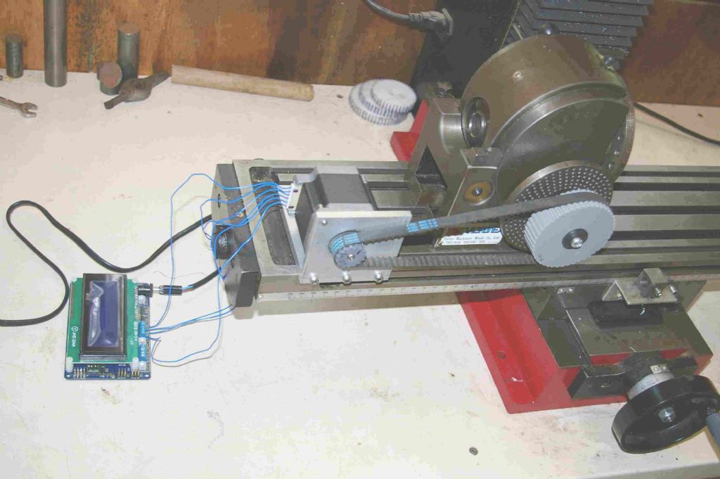

                                      I think I've come up with a working digital dividing head. I stripped out most of the Freetronics example sketch, leaving me with only the instructions required to run one motor a specified number of steps in one direction. The modified sketch is:

                                      I slowed it down by increasing the pulse duration to 500 uS and set the motor to rotate 3 revolutions by setting the steps/revolution to 4800. I disconnected the USB connection to my PC and the external 18V supply to the controller. I found that when the external power supply was reconnected, the stepper motor rotated three revolutions and stopped. This is what is needed to turn my dividing head.
                                      I connected the motor to the dividing head using a toothed belt and a 15 tooth pulley on the motor and a 45 tooth pulley on the dividing head. The gearing in the dividing head is 40X so the three revolutions of the stepper motor resulted in the dividing head rotating 9 degrees. I've included a couple of photos of the setup.
                                      There is a indexing plate on the head with holes every 10 degrees which can be engaged by a pin on the main body. After setting the dividing head to 0 degrees, I applied the power to the controller from the battery 10 times and found the pin engaged the indexing plate perfectly at 90 degrees. The same thing happened at 180, 270 and back to 0 degrees again so the stepper motor is as accurate as the indexing plate.
                                      This setting enables a 40 tooth gear to be cut. I can of course change that to any number of teeth I want by connecting the Stepduino to my PC and changing the number of Steps/Revolution in the sketch. This is probably not much more time consuming than setting it using the LCD screen with all the complications with the sketch and the hardware this would entail.
                                      One thing worries me a bit. Given that it takes 1600 pulses to rotate the stepper motor 1 revolution and the gearing between the stepper motor and the business end of the dividing head (120:1) it requires 192,000 pulses to rotate the work one complete revolution. If, for example, I wanted to cut the ever popular 127 tooth gear, the number of steps/tooth required would be 1511.8 pulses. As the input to the sketch needs to be an integer, the StepsPerRev would need to be set at 1512. 1512 X 127 = 192,024pulses which is 24 pulses too many. This doesn't sound much but is 1.6% of the 1512 pulses/tooth. In other words, the final tooth will have 1.6% of its thickness removed and this will be worse if multiple passes are made when cutting a gear or if the decimal is closer to 0.5 rather than the .8 in this example.
                                      One way around this would be to cut 103 teeth at 1512 StepsPerRevolution, then cut the remaining 24 teeth at 1511 StepsPerRevolution which would reduce the error to 0.07% for the last 24 teeth which is probably negligible. This can be done by reprogramming the sketch after cutting 103 teeth or, since I have the dual output stepduino, reactivate the Stepper Two output with the StepsPerRevolution set at 1511. After cutting 103 teeth the motor would be unplugged from output one and plugged into output two.
                                      I hope this crude way of doing things doesn't cause too much offence.

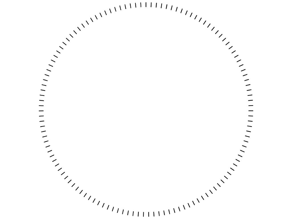

                                            First, I wouldn't be too quick to discard the StepDuino. Looking at it, it seems to be no more than a board consisting of an Arduino Uno clone with two built-in stepper drivers, an SD-Card slot, and an LCD Display. You could assemble the equivalent from an actual Uno and the equivalent modules, but StepDuino does all that for you.
                                            The SD-Card, second stepper driver, and LCD display are all features. If you don't write code to explicitly use them, they will be ignored.
                                            Given that Alan started with an unknown motor, I suspect his problems are more to do with wiring it up and getting its parameters right in the code than a fundamental problem with Stepduino, especially as he has made progress with it. May not be a good idea to hack lumps out of Freetronics examples. Generally with computers you have to proceed logically. It's not like fault finding a mechanical problem where poking about often flushes out what's wrong.
                                            Secondly, dividing error. Joseph's suggestions are most interesting. I have my own stepper software, and am up for improving it if it's worth the effort. But is it?
                                            Here's a perfect 127 'toothed' 100mm diameter circle:

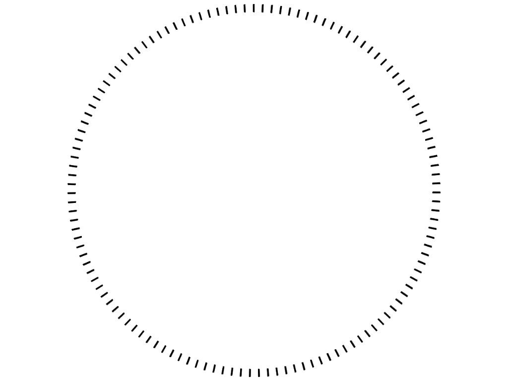

                                            This is the same 127 'teeth' generated from 8 turns with Alan's rounding error (1512 for 1511.8)
                                            In the second image there are still 127 'teeth' but the lines are thicker because the 'cut' is displaced slightly each time the wheel is rotated. Zooming in shows that the effect of the error is to turn the whole gear in a negative direction.
                                            Whilst the gear isn't perfect, the error doesn't accumulate at one end! Rather it is distributed around the entire gear wheel. My question is, does this matter in practice? Also, are the errors due to step rounding any worse than the errors that occur during cutting with a conventional dividing head?

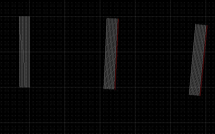

                                                That is true in part; the error is added to each subsequent tooth, not just to the end, but the net effect is as Alan describes – Imagine cutting 100 teeth of 1mm pitch onto the periphery of a blank 100mm in circumference. If you rotate the blank precisely 1 circumferential mm all the teeth fit fine, and start and end are in place. But step , to exaggerate, 1.1 mm, and the Final Cut ( Floyd, again..) will destroy the first few teeth.
                                                The first tooth is in place – zero steps, the second is at 1.1mm from that, the third 1.1mm from the second and so on. The hundredth ( 100 teeth worth of stepper steps..) tooth is 100*1.1mm from tooth zero – 110 mm, instead of at 100mm, ie, back at tooth zero . So we just destroyed the first 10 teeth..
                                                Obviously I have exaggerated the step per tooth error grossly to illustrate the point, and that is the effect of Alan's current integer problem – pedantic perhaps, since thinning the last tooth ( remember its opposite flank was cut in the first cut and so fixed in place) by 1.6 percent is probably irrelevant for the intended use. I have not checked the math to see if the 1.6% is correct – seems low at first , but if correct, ignore it perhaps.
                                                The spread of the CONSTANT error is not the (only) problem – the final end point is – all the errors have added to themselves along the way.
                                                The effect is made worse if the blank does more than one rotation – the error simply adds the integer excess onto the last position so it will accumulate all the way, thinning every tooth as it goes, UNLESS Alan's software can reset the pulse generator count accumulator back to zero at the zero tooth position, in which case the errors remain the same for each blank rotation.
                                                Interpolation such as with Bresenham's still spreads the error, but adds or subtracts it from the pulse stream so that it does not accumulate sequentially on itself. At some point the count error with be fractionally ahead, then behind, and occasionally spot on.

                                                      Thanks Joe, that makes sense.
                                                      While I was aware rounding can cause errors, I'd persuaded myself not to compensate for them on the basis that the effect would always be trivial in practice. Now I'm not so sure, particularly now you've pointed out that blanks may be cut with several rotations. If Alan's example were continued indefinitely, his teeth would be removed entirely, never a happy event!
                                                      While there are plenty of times when rounding error wouldn't matter, I think this is worth fixing. Once the algorithm is decided the Arduino doing a bit more arithmetic to compensate is neither here nor there, and far better that the user doesn't have to worry about the possibility of having his gears seriously thinned.
                                                      Not quite sure how best to go about it. Bresenham can't be applied directly as I understand it. I shall have to get my thinking cap on.
                                                      Problem:
                                                      Given a stepper motor, micro-step and gear ratio combination, and the requirement to divide by 'n', what is the best way of compensating for rounding error by finessing the number of microsteps taken to move a blank to the next division such that any error cannot accumulate. Hmmm.
                                                      This is why I never finish anything. I'm easily distracted and my 'to do' list is already 3 pages long…
