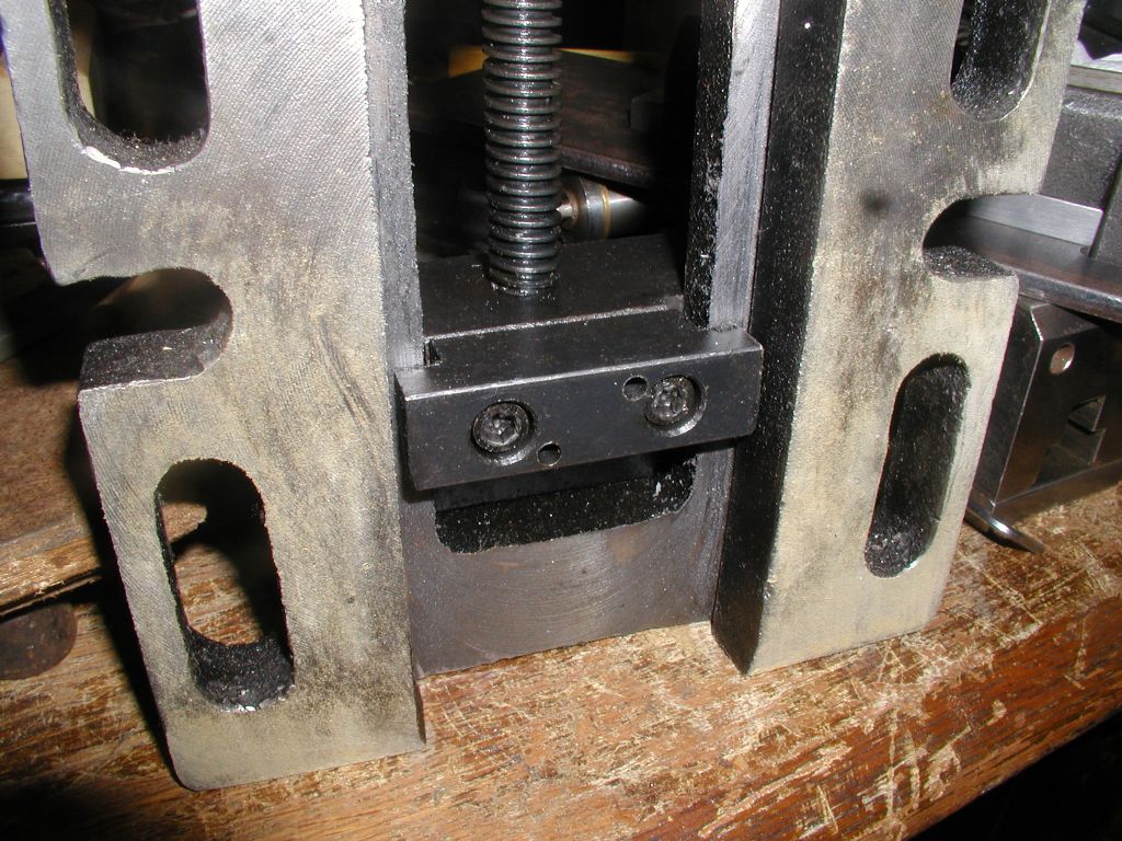

                                              Hi Ed, I have one of these, it is not perfect but it is not nearly as bad as yours.
                                              Below is a photo of the underside of mine showing the block that holds the movable jaw down onto the vice bed to prevent the lift that yours looks as if it is doing. Yours may or may not the same, but you will notice in the photo two small holes diagonally to each other between the two cap head bolts. In these holes are two socket grub screws, which can be adjusted against the cap head bolts to give a minimum amount of lift in the movable jaw.
                                              I've found the best way to adjust these, is to first back off the two grub screws and then nip the two cap head screws so there is no movement in the jaw. You can then back off the two cap head screws, say one flat at a time on each screw and then tighten the two grub screws. Continue this sequence until the jaw moves without binding and without to much slop either.
                                              Mill/Drill Vice
                                              The underside of mine needs to be dressed on the mill, because the front end measures 15.11 mm while the back end is 14.9 and as it is adjusted at the moment, the movable jaw gets too tight at about 13 mm from closing. I have filed off the high points but it really needs milling parallel. When! I get round to doing that, I'll probably make a new block to cover a wider area of the underside.
                                              I've only every used this for drilling, which it seems to be OK with, I didn't buy it with any intention of using it for milling.
                                              Regards Nick.

                                                  Thanks Neil, Nick and Robert, I must admit I didn't notice the two small grub screws and will investigate over the weekend.
