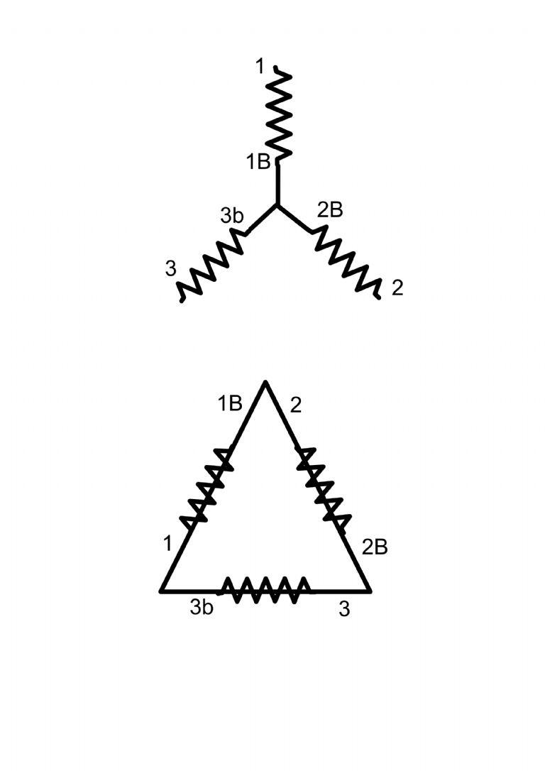

      Judging from what you've written in the above posts I think you're right, I will need some help with the wiring.
      I've just checked the coils and I get 3.2 ohms for each of the coils.
      #206765
      Mark C
        @markc
        That sounds to be ball park to me. More important is that they are all the same.

                    I now have 6 wires appearing out of the connection box, all the new wiring connected, sleeved and tied in. The connection box itself has three terminal posts, and I have labelled the three original wires 1, 2 and 3. The other ends of each of the coils are labelled 1B, 2B and 3B respectively, and these are the ends which were originally connected together to form the star point.
                    Presumably I can now connect the wires up to the three terminal posts as follows: 1 and 3B together, 3 and 2B together and 2 and 1B together, my thinking being that if one or two of the coils are reversed there won't be 120º between the phases.
                    As to the inverter Neil, I have yet to buy one. I keep looking on eBay and see models by Huanyuang at around £100, compared to around the £250 mark for a known name like Hitachi or Mitsubishi. I have no idea which to go for.
                    #206858
                    Mark C
                      @markc
                      Steve,
                      Sounds good to me!
