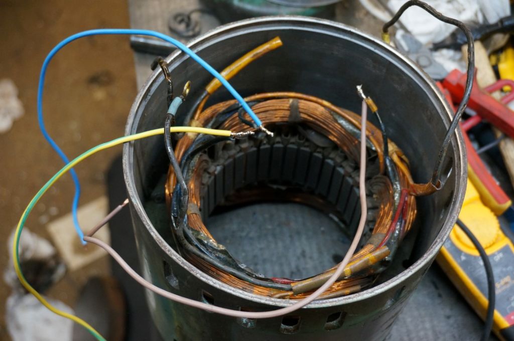

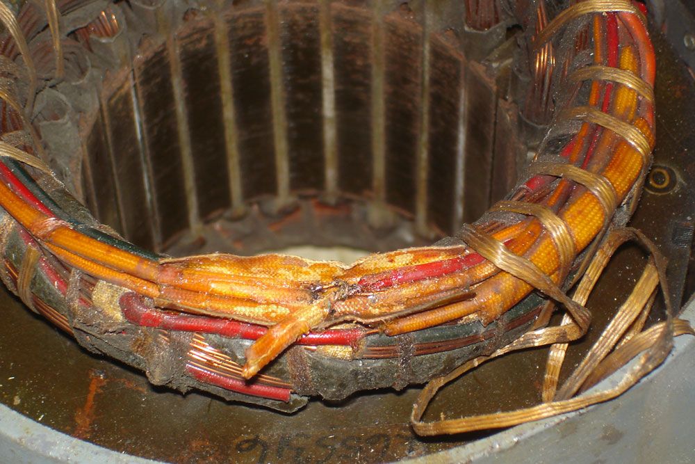

      Help needed to locate the star point
      #206637
      Steve Pavey
        @stevepavey65865

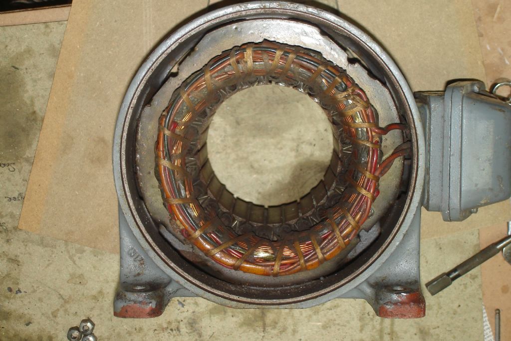

        Just dismantled the 2.2kW 3 phase motor from my lathe as the first step in re-commisioning it. Rather than just snip away I wondered if anyone out there could hazard a guess as to where best to start to locate the star point.
        The lacing looks like a waxed cotton thread to me – similar to carpet thread, and I happen to have a small amount – do you think that is suitable when it comes to lacing it up again (assuming I get that far of course).
        The photo in my album appears much larger than it seems to in this post.
        Edited By Steve Pavey on 04/10/2015 20:58:03
        #206640
        Ian Parkin
          @ianparkin39383
          Just carefully cut the strapping away and it will tease away from the windings and pull out
          then tease the wires out and you should easily see the star point
          cut and solder on new wires and then use your strapping or small tie wraps to tidy up

            Is the Star point located to the left the termination box? I see some Grey wires……

              hi steve, before you hack into the windings, how many wires are there in the connector box on the motor? if there are six, you don't need to touch the wihdings
              phil

                That blob at 6 o'clock, could it be that? My theory says that it should be close to the first set of coils (not where the lead out wire are). this is based on the first wire goes around coil #1, then coil #4. . . the second wire goes to coil #2, then coil #5. . . wire number three goes to coil #3, then coil #6. So the ends of the wire must at the last coil, the last but one and the last but two. This should be close to coil #1, or where we came in.
                Try picking out one lead out with a sharpi type marker, perhaps you can identify the start or ends of the sets of coils. A colour code would help, black, red and green or blue could be used for the input wires, then any sleeved long wire must go to aq coil or the star point.
                If you consider the service of the motor, hot with vibrations, the leads must be supported really well, I am not confident that stripping away all the lacing then trying to replace it all would add to the reliability of the motor, so minimum modifications must be the way to go. Just remembered of some incidents at work, because of the internal temperature rise, the actual coils change shape and move about, just something else to fret about.
                Frank

                  Oh how I wish there were six. Unfortunately not
                  John – The grey seems to be something like a piece of tape, rather than wires or sheathing. There does seem to be a couple of likely looking bits of sleeving at the 5 to 7 o'clock position – I didn't say so in the original post because I didn't want to colour anyone's thinking and I wasn't at all confident anyway.
                  I'm definitely all in favour of creating minimal disturbance Frank – it's a Brook Crompton motor, and everything looks so neatly laced I want to keep as much as possible intact.
                  I have some shrink sleeving at the ready to make the three new connections once I locate the star point – presumably soft solder is ok?

                    hi steve, ok its not a problem, and this may sound obvious, but you are looking for the biggest lump in the windings, find where the tails that go to the connector block are solered to the windings, and look at the same place on the other side of the windings, and also at the other end of the motor, you cen cut the string binding and remove the taping, but keep bending of the wires to a minimum. when you find the star point, unsolder the connections, solder on some tails of similar size or larger, and route them into the connector box, then tape up the connections and tie them back to the windings with cotton string, and varnish them up to stop them moving , job done!
                    phil

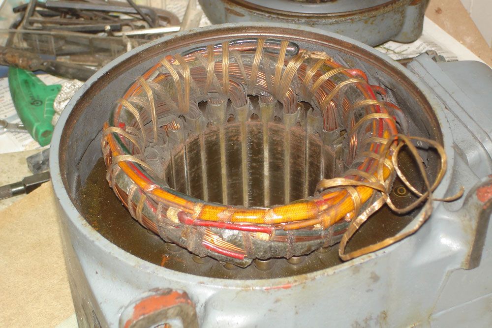

                                      Heres a series of pics I did to illustrate an article on how to change from star to delta
                                      its a brook motor so very similar to yours

                                      Ian Parkin
                                        @ianparkin39383
                                        Then after checking continuity heat shrink the connections twice and wrap or tie wrap all the wires back into place
                                        colour code or mark each pair and bring the wires out to the connection box and reconnect as delta

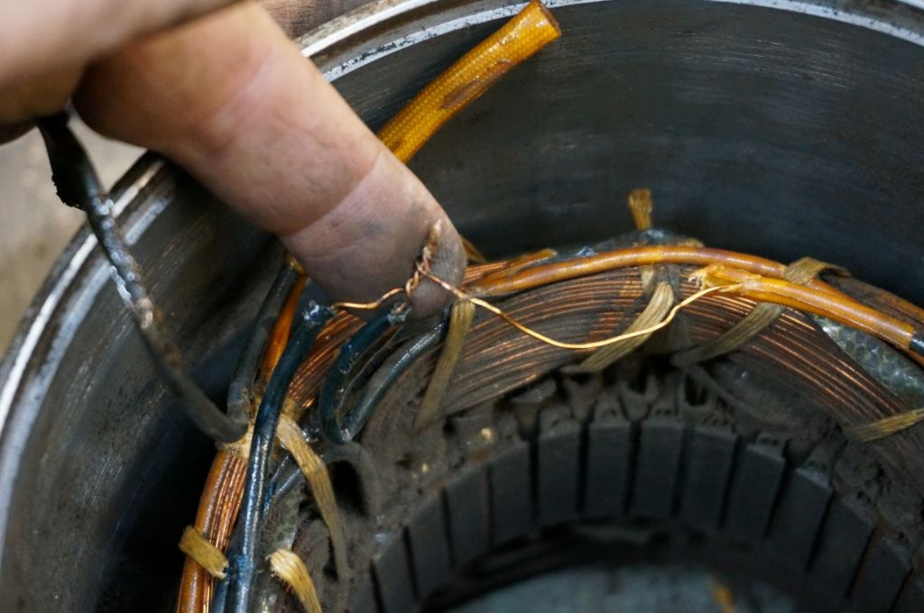

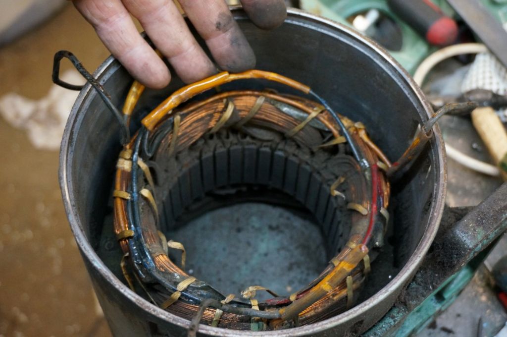

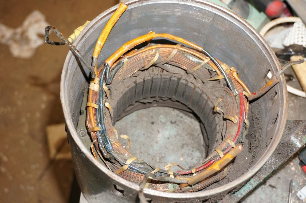

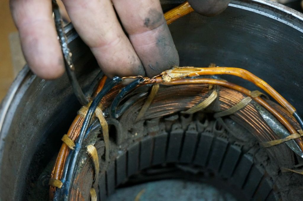

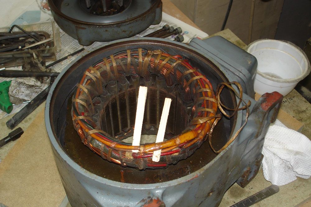

                                              A scalpel and some blunt softwood wedges later, and I have this – (1) undoing the lacing, (2) separating the wires with softwood wedges, and (3) opening up the sleeve to reveal what is hopefully the star point:
                                              There is only one other place where three wires come together, but two of them are clearly the original wires leading out to the connection box, so this is the one I chose to dissect. I'm fairly happy that the 3 wire connection in the last photo is the star point, but if anyone knows different I would think now is a good time to shout!
                                              I have some glass fibre type heat resistant sleeving but I'm waiting for some coloured heat shrink sleeving and numbered collars to arrive courtesy of eBay (hopefully tomorrow). I think there is enough room for crimp connections if I want to use them.
                                              All the information above has been really helpful, especially Ian's photos and the info on the coolant pump motor etc from Mark – I think John Mills (Doubleboost on Youtube) converted his coolant pump to single phase with a capacitor so I need to have a dig through his videos and find some info on capacitor sizes.
                                              Have yet to choose and buy a suitable vfd – presumably they all cater for wiring in external control switches (???). I'm not sure what you mean by '2 wire control' Mark, but perhaps that will become clear when it comes to wiring up the vfd.
