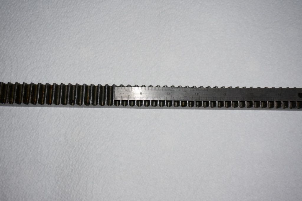

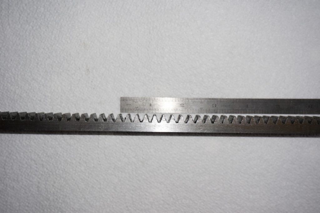

      How do I specify this rack
      its off a large Fobco drill press and i'd like it to be double the length
      Its 3/4 " wide and 1/2" deep
      is this likely to be off the shelf anywhere?
      is anyone on here able to make me a length
      even 12 inches or so i can join it then to existing
      I have a vertical mill is there a end mill made to cut those teeth profiles?

          You need to know the pressure angle and diametric pitch. Given that a rack has straight sided teeth, at the pressure angle, the PA is easy to measure. It is likely to be 14.5º or 20º. Assuming that the rack engages with a gear with integer diametric pitch the pitch of the rack will be irrational since pi is a factor going from diameter to circumference.
          There may well be an appropriate rack available off the shelf. I doubt you'll find an endmill to create the rack directly. However, given that the teeth are straightsided, and if you're not worried about a radius at the bottom of the teeth, then you can cut the rack using an ordianry endmill or slot drill in three passes. One pass is full depth with the head vertical and the other two with the head set over at the pressure angle for each side.
          Alternatively use a shaper or slotter with a ground HSS form tool.
          The biggest issue will be keeping track of the irrational pitch of the teeth.

            Hello Ian,
            Better measurement will confirm it but at first sight it looks very close to 12 DP.
            That has a theoretical tooth pitch of Pi divided by 12 which is 0.2618 inches [6.65 mm] Check it out accurately over say 10 pitch widths to be sure The matching gear dimensions will help also in confirmation; diameter in inches is T + 2 divided by DP, where T is the tooth count.
            I imagine , if this is an old machine, the pressure angle will be 14.5 degrees—modern gears and racks are made to 20 degrees
            I'm sure there will be suppliers if you Google for information, HPC gears in Chesterfield come to mind as a possible source http://www.hpc.co.uk
            Regards
            Brian

              Thanks to Andrew and Brian
              I'll try hpc on monday or have a go at making my own
              Given that its purpose is to raise and lower the table on a drill press will a 20 pa work over a 14.5 pa
              Ian

                Hello Ian,
                Indeed it will, that thought had just come to me over a cup of tea. The meshing will not be that critical and in any case it will be intermittent in nature and I imagine you lock the table to the column having moved it, in which case those little niceties don't matter at all,
                Good luck with the search or better still the making it yourself

                  If you do go in for a PA "mixed marriage" it might pay you to make the rack from something softer than the meshing gear – aluminium, say.
                  You could cut the long rack you want in your vertical mill using a shop-made D bit type cutter. Alternatively, you might be able to use the B&S type with the cutter on an arbor between centres on the lathe and the workpiece on the cross slide, re-indexing the work as necessary; Martin Cleeve made his racks this way.

                                  The rack is carried at its bottom end on a large bearing that rotates around a locking collar
                                  the rack then fits snuggly against the column untill it goes into the table casting collar its a good fit into this over about 4 inches
                                  The rack i want to be about 18inches long I had apiece of stock the right size
                                  Set it up in the mill but bottled out after the first cut with a 2mm end mill cutting in steps down to 6mm depth
                                  This is going to take me ages to do !!! and cost a bit in broken cutters
                                  Rang a local co to see if they could do it but they quoted of the top of his head £200 ish
                                  I ordered a sealey rack off one of their floor standing pillar drills for £35 delivered
                                  it may be easier to modify that !!!
