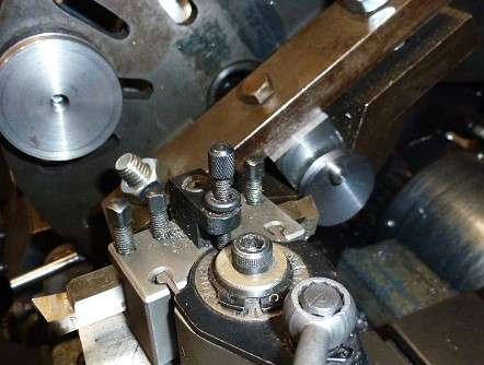

      I’m making the 5cc Sparey Diesel to Hemingway’s plans. The crankshaft is specified as from 1.25″ dia steel bar. In particular, the overhung crank-pin looks to be an awkward machining operation. I’m wondering if a press-fit or loctite assembly might be OK. Perhaps also even for the crank web onto the shaft itself.
      Any thoughts or experience of such construction?

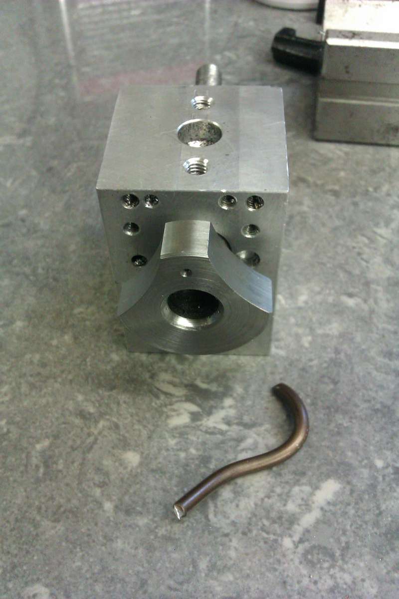

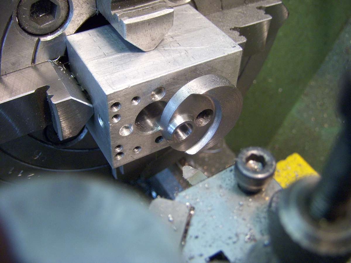

      #747361

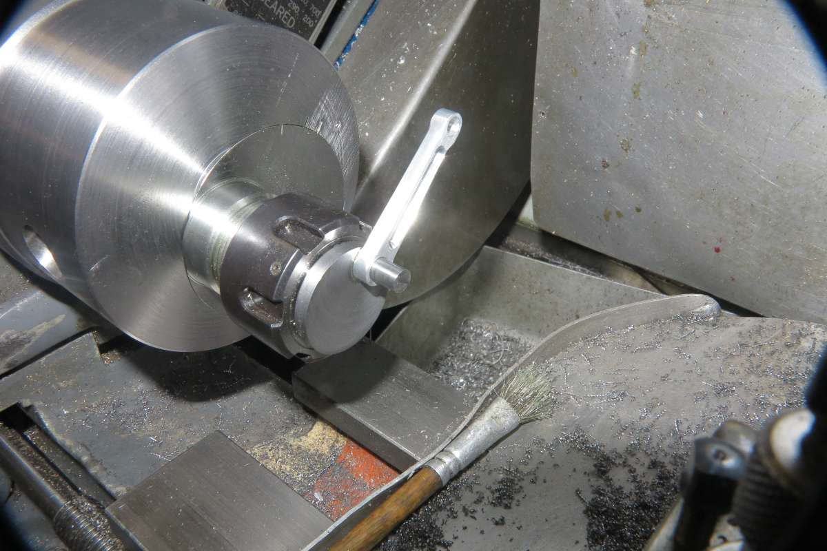

        machining is not too hard, you can either use  a keats type angle plate or bore  a block of aluminium to clamp the shaft in then the block can be held in the 4 Jaw. If going for an integral pin then you can mill a lot of the waste away to leave a small square that can be easily turned and a clean up facing cut to the web.
        HPIM1458
        IMAG0684
        IMAG0694
        I have also done pressed in silver steel pins, a hand reamer not run all the way through will leave a taper that grips the pin more the further it is pressed in.

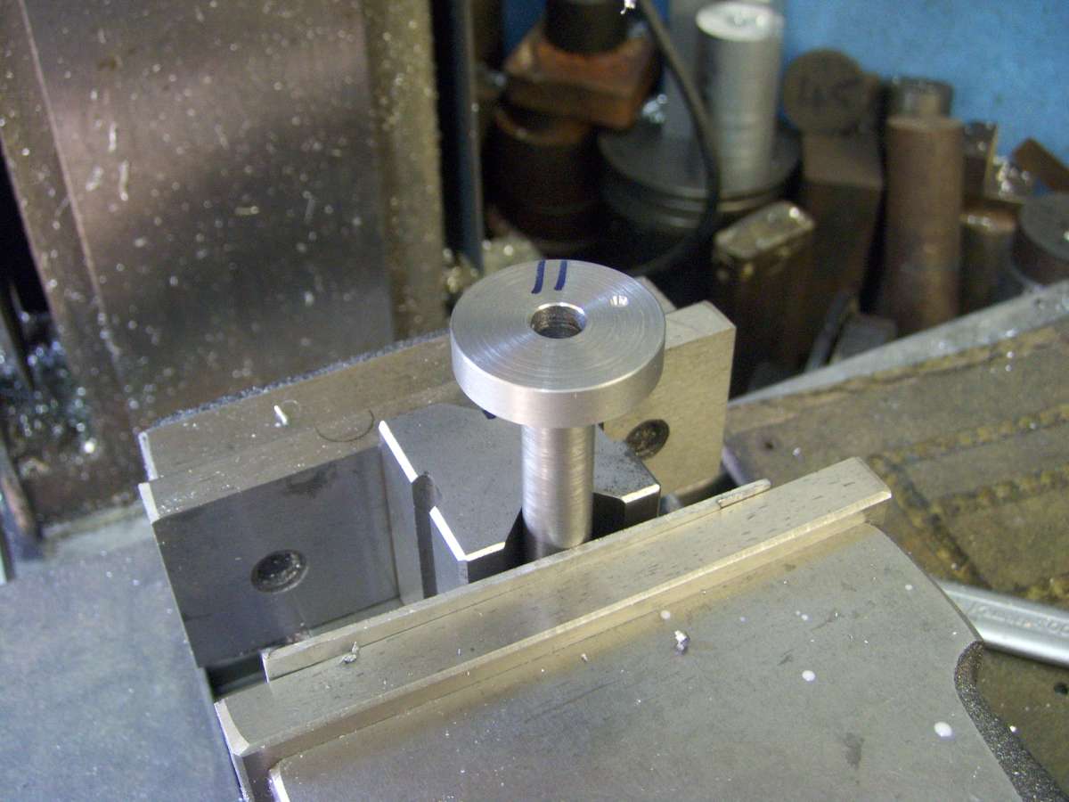

                        Just a couple of questions though, how did you clamp or hold the crankshaft in the block?, and I assume you bored out or drilled and reamed a hole for the crankshaft, but how did you then set up the block and crankshaft to centre the crank pin to get the required offset?

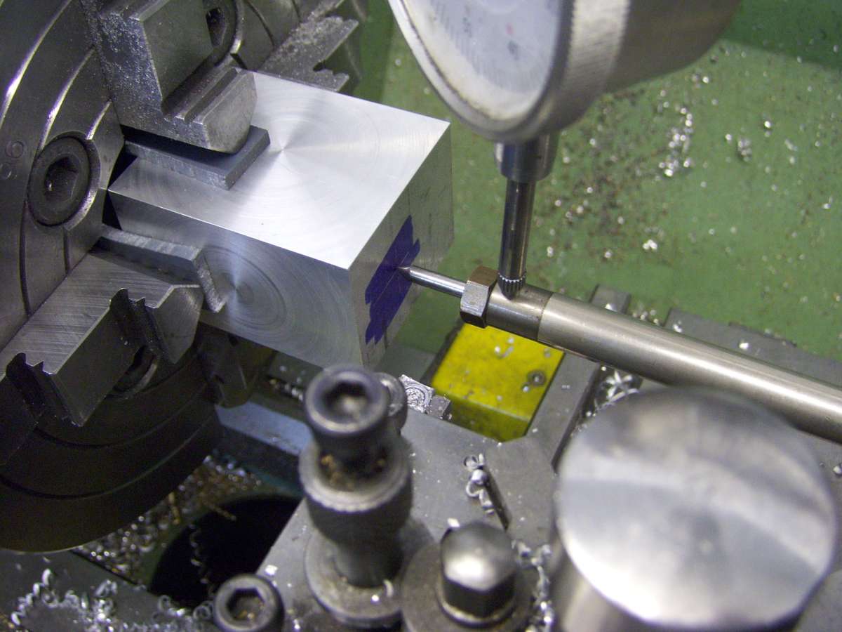

                        #748111
                          The block is drilled and tapped for two grub screws, M5 from memory. I  put a small piece of soft aluminium wire into the hole before the screw and this saves the screw damaging the shaft.
                          IMAG0683
                          Held the shaft vertical in the mill, located ctr and then moved the axis by the crank throw and spotted the pins position.
                          HPIM1456
                          It is then just a case of using te h4-jaw to position th eblock so the spot runs true, similar to this setup for a crankcase.
                          HPIM1298

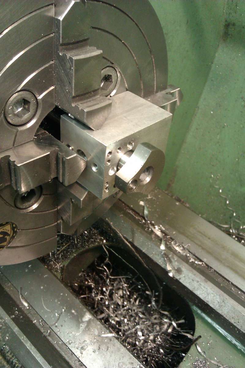

                            #748302
                            Clive Brown 1
                              @clivebrown1
                              As a follow-up; after anguishing about a loctited crank pin, I finally decided to use my Keats angle plate after making a modified clamp for it. I had been concerned about the job shifting under the interrupted cut, but the set-up proved as solid as a rock.P1030264

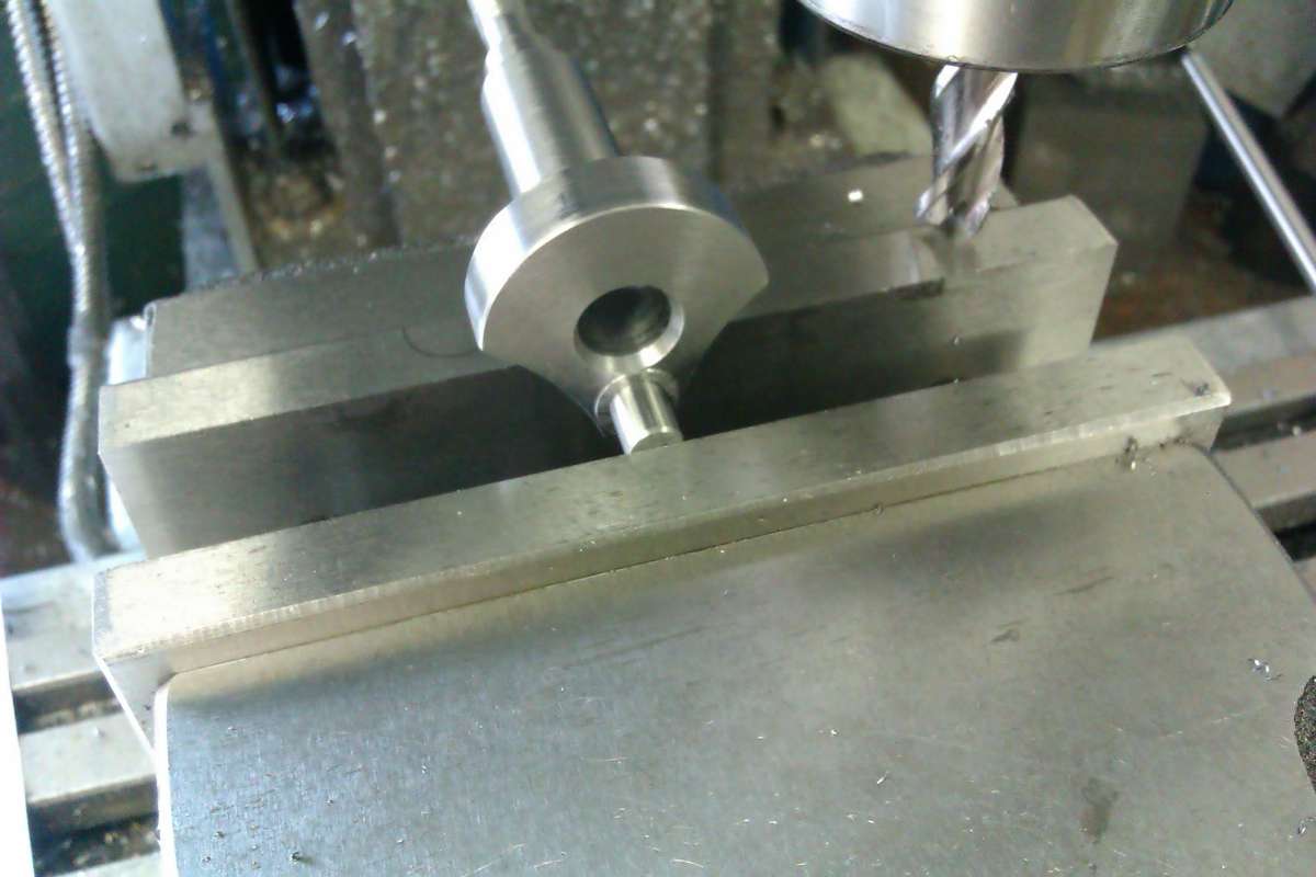

                              #748360
                              KEITH BEAUMONT
                                @keithbeaumont45476
                                Although I have used pressed in crank pins  for the last 4 of the engines I have made, when I do machine it from solid I have found using a Stevensons square collet block in the 4 jaw chuck,a simple way of setting it up. Just centre it in your favourite way, then offset it using one direction. When you are happy with the position, it is a good idea to drill a small centre point before any interupted cutting. This acts as a visual check that nothing has moved and if it has ,makes it easy to re position.
                                I am,in fact ,making a crankshaft by this method at the moment ,for a 1cc Diesel, but have not got to the crank pin yet.
