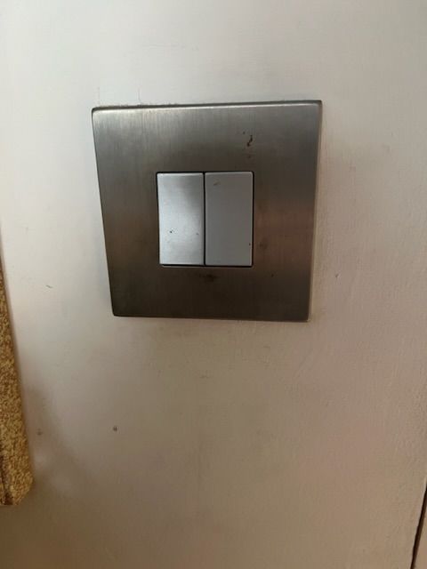

      A neighbour asked me to sort his electric sky lights one of which had stuck open…it was the wall switch which has fallen to bits
      its a single wall plate with 2 momentary rocker switches on it one way for open and the other for close.
      so its s 2 gang 2 way momentary?
      can i find one online?
      any one able to help?

          Make sure you get a switch suitable for the voltage and current taken by the vent motor.
          A DPDT or perhaps SPDT with centre off biased return may suit your needs.

            Well i wanted to get one to replace what’s there now…i have lots of switches to suit but they are a bit industrial in style. The neighbours house is a bit homes and garden…

                The one that is there looks like this
                But it has rocker switches centre off …up and down momentary.
                i cant believe that the manufacturer of the roof vents have a switch specially made
                but looking online (as its Sunday) i cant find a single wall plate with momentary switches (other than bell pushes)

                            I often find that unusual switches use a custom mechanical housing with the actual switch behind being a common off the shelf part. Take a photo of the back, and if here is any numbers printed anywhere note those down. I wouldn't be at all surprised if it was a couple of bog standard parts.

                              It just looks like a standard wall switch with modules…but not like a grid switch.
                              i think the modules i linked to above will do it

                                332RF will do what you need.
                                When I look at it, 27120 also comes up as an alternative. Comments on 27120 from 'ProGuy' say "Great for controlling roller shutters where you need it to be normally off, then be able to switch it up or down to higher or lower the shutter."
                                I think what he says is equivalent to your desired appllication.

                                      If you pop the screw less cover off you may see the 2-gang grid plate.
                                      Think this should do it always returns to the central off position and they give operation of a blind as an example

                                        Domestic switches usually use compressed springs between the outside switch part and the inside metal part that actually does the switching. The springs produce a very quick switching action, to prevent arcs, and they also 'lock' the switch contacts into the on or off position,
                                        Momentary action switches will not have this, since the terminals don't need to be 'locked' off or on. So they will have a different mechanism and won't be a normal switch with a bit of internal plastic added or removed or whatever.
                                        Unfortunately, manufacturers, designers and suppliers seem to be very conservative and only produce or stock what 95% of installers need. So your quest is likely to be frustrating. I suspect you will have to do some detective work to find and contact the makers of the broken switch – assuming you cannot fix that one, of course. Some can be taken apart, and you might find that a good clean out and reassembly will fix the old switch.

                                          As Jason says or the screwfix 2 way one may be what you need if opening and closing commands required. From a review of it on screwfix
                                          "I like these. They're nice looking switches and grid plates and one of the few ranges with a retractive switch available.
                                          For those who've not tried it, retractive 2-way switches are ideal with automation systems. A standard switch can be "the wrong way up" if the system turns off the light rather than the switch, which confuses people. Connect L1 to L2 on a retractive, set the control module to handle retractive and pressing either end of the switch simply toggles the light.
                                          Perfect. Wish Screwfix stocked more of the varilight grid range; I've had to go elsewhere to buy other colours for a couple of rooms."
                                          You can probably use one two way switch where they have used 2 single way. Or get 2 two way and you'll cover all bases
