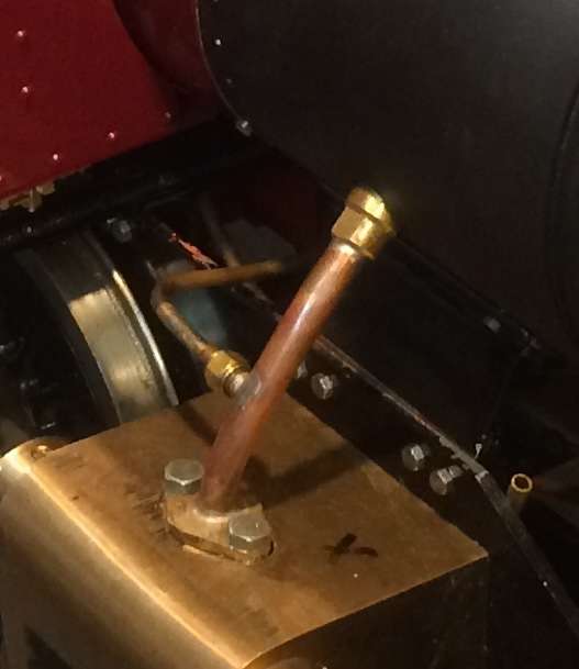

                                            I had a similar problem on my SPEEDY 5″ loco, so I modified an 8mm compression joint as the pipe exited the smokebox.  The small tube on the steam pipe is the steam oil feed.
                                            Cylinder steam pipe
