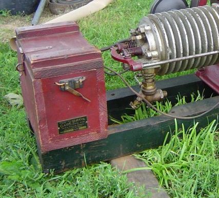

      Does anybody have a UK source for a small single pole knife switch? The older looking the better and about 40-50mm long. A double pole would do if it could be butchered.
      There seem to be quite a few available in the US which I may end up going for or making my own.
      Its for the Hit and Miss engine that I'm working on at the moment which had the knife switch on teh outside of the wooden battery box so something modern won't look right. 6 volts max.
      Thanks, J

                          What the switch build or the whole engine & cart? with 150+ photos of the engine build I could get accused of packing things out.
                          This is an original switch, I think the fact it needs to pivot the other way to mast of teh commercial switches is going to be the deal breaker and mean its made from scratch.

                                      Thanks Phil but job is done.
                                      You will all have to wait if you want a full write up but here are a few highlights.
                                      Flycutting Corian gives a very nice finish
                                      Mill a couple of pockets and drill a few holes
                                      Press in some knurled inserts
                                      Mill a couple of brass block and add a slot
                                      Twist up a bit of brass sheet
                                      Bang in a rivit
                                      Job done
                                      Just got to screw it to the side of this, Coke can for scale
                                      Once again thanks for the help and suggestions, J
