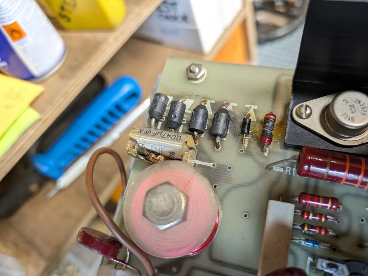

      Hi guys. I bought a Cowells CW90 a few months ago which I have been slowly restoring. Got it all back together yesterday and noticed that the speed controller has some issues. It works, but when the potentiometer is in certain positions the motor rpm fluctuates and it is unstable.
      I assume it’s likely that the potentiometer is faulty and I am going to replace it. However upon opening the controller up I have noticed a few other components that have clearly gone kaput. (Two capacitors and a resistor).
      I need some help with identifying and sourcing the parts needed.

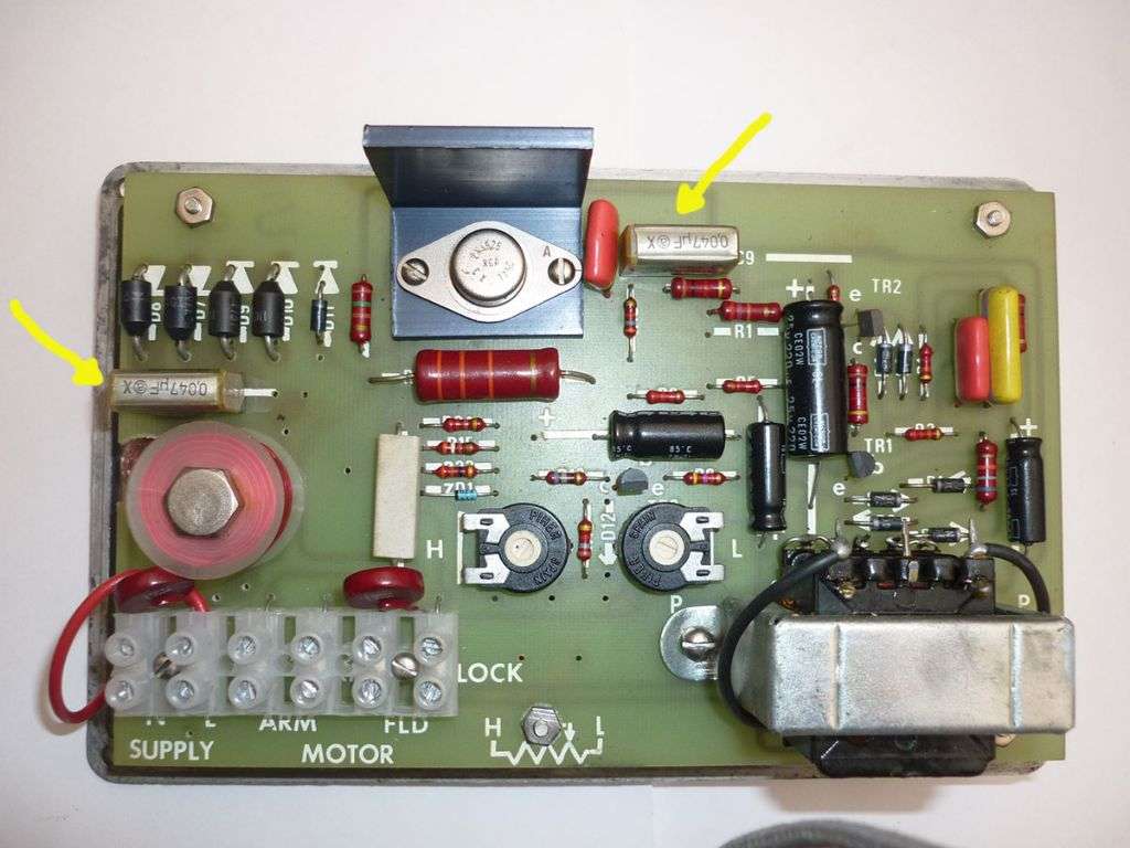

      Coincidentally a search lead to some useful information from in an old thread. Pictures below.
      Image found online of a better condition controller.

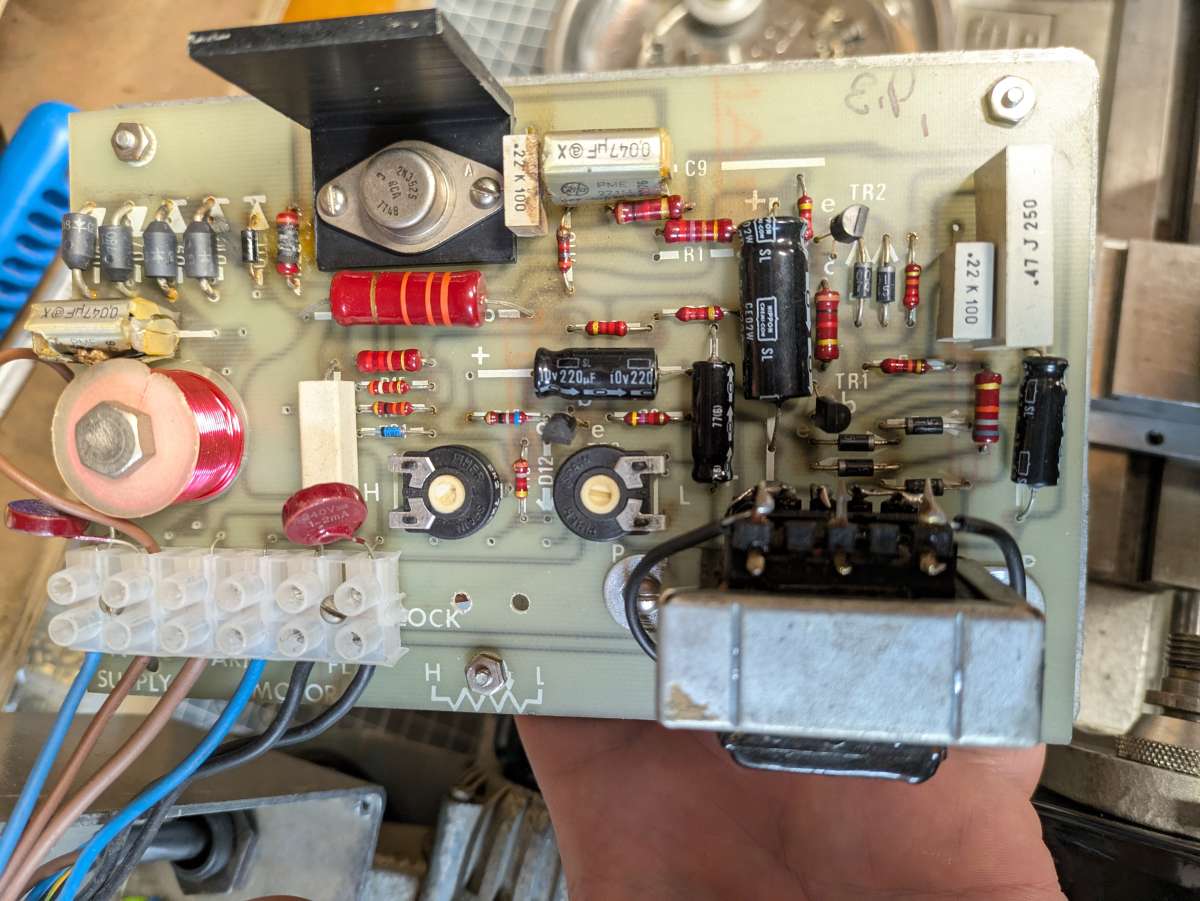

        My controller
        PXL_20250426_105039947

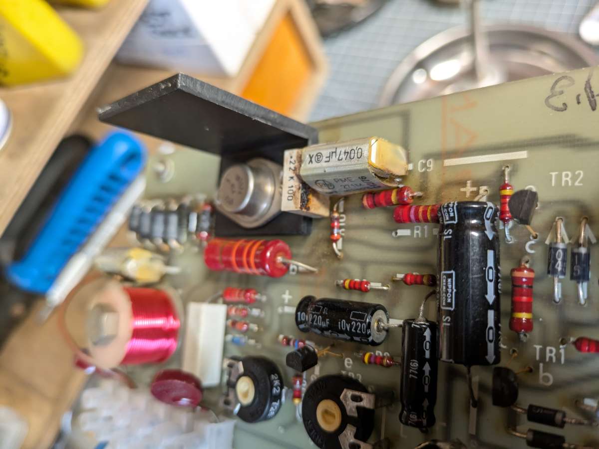

        Clearly blown components
        PXL_20250426_105053001
        PXL_20250426_105106280

          Hi,
          It looks repairable.
          Capacitors, probably mains voltage.
          Resistor looks like 150 ohms quarter watt.
          The T03 2n…… transistor could be short circuit.
          All the diodes will need checking.
          Good luck……….
          #795309
          Robert Atkinson 2
            @robertatkinson2
            The capacitors are RIFA X type paper capacitors often used in EMC filters. Thay have suffered a common internal failure mode. There is probably a nasty smell about them. Replace with 47nF / 0.047uF “X” or X2″ plastic film capacitors. Thes will have a rating of about 275 V AC.
            The “transistor” isn’t. It’a a 2N3525 Sillicon Controlled Rectifier or SCR.  One of the diodes has been changed to what is almost certainly one with two low a current rating. It the part number is not visible on the original 3 I’d suggest replacing all 4 with 1N5408 diodes.
            If you are getting some speed control it’s likely that the SCR is OK.
            The burnt resistor is 150 Ohm 1/2 W.
            Robert.
