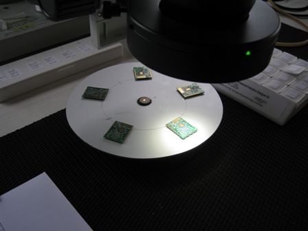

      Components Assembly with a microscope, rotating carousel for the PCB, and a Vacuum pencil to pick up the tiny components.

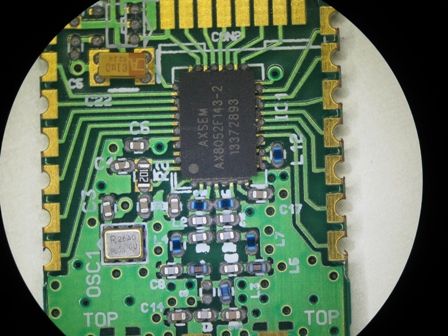

      Solder paste is applied to the PCB using a brass shim stock stencil and squeegee- holes are drilled in the stencil on my CNC Router at each of the component pads. The hole diameter dictates the amount of paste deposited.
      angled view with some idea of paste thickness – about 0.15mm

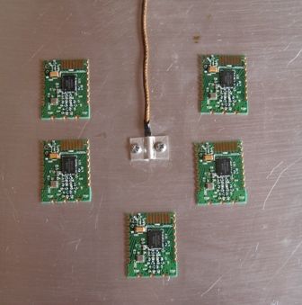

      SMD parts placed onto the pasted positions.
      Reflowing ( melting) the solder paste on a temp controlled hotplate.
      Thermocouple in the center..
      Solder reflowed..

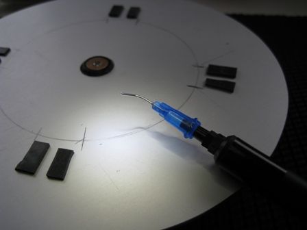

      The Vacuum Pencil – DIY using a plastic pen as the hand device, an adhesive dispenser tip as the sucker tip, and a fish tank air pump, with the pump reversed, as the vacuum source. A foot operated solenoid connects vacuum to the pen tip, or vents to ambient air to drop the part
      Here is a small inductor vacuum attached to the pen tip.
      Same view through the microscope..
      That part, as is all the others on this board, is 0.9mm long x 0.3mm wide…
