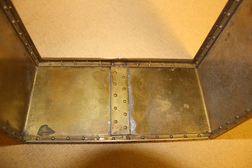

                            #440270
                            Phil H1
                              @philh196021
                              Folk,

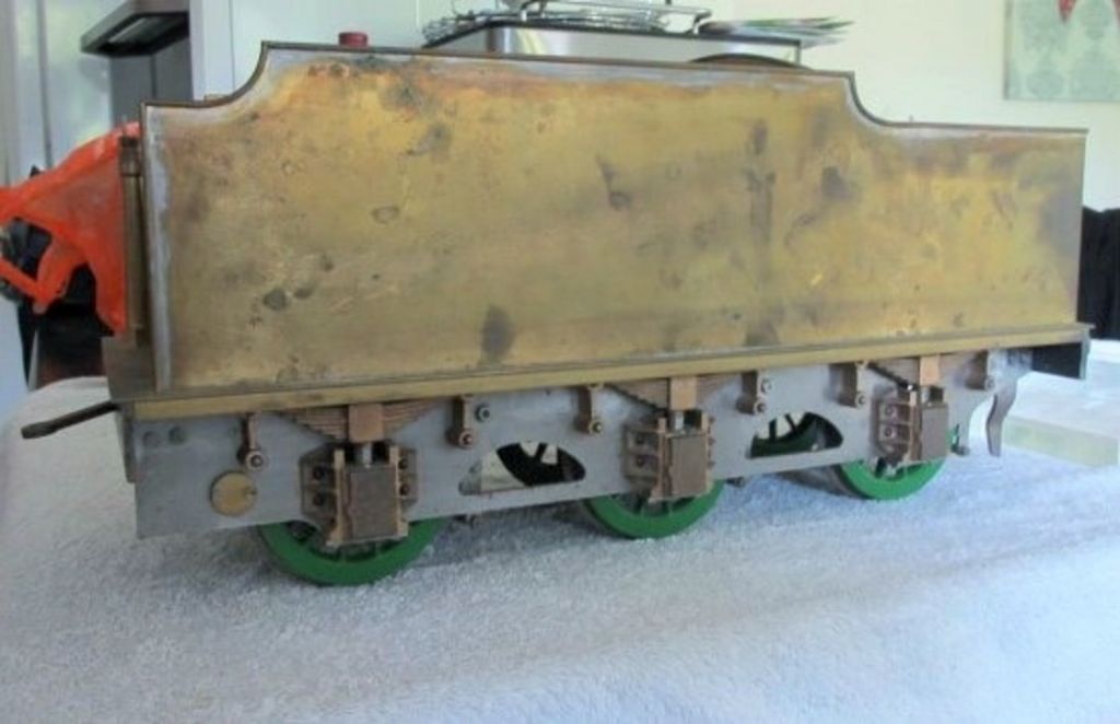

                              The pictures as promised.
                              This is the tender as I received it. You can see that it is virtually complete (90% ish) but has a few minor issues such as the rust on the frames and the body of the tank work needs to be sealed – possibly with solder – hence this post.no4.jpg

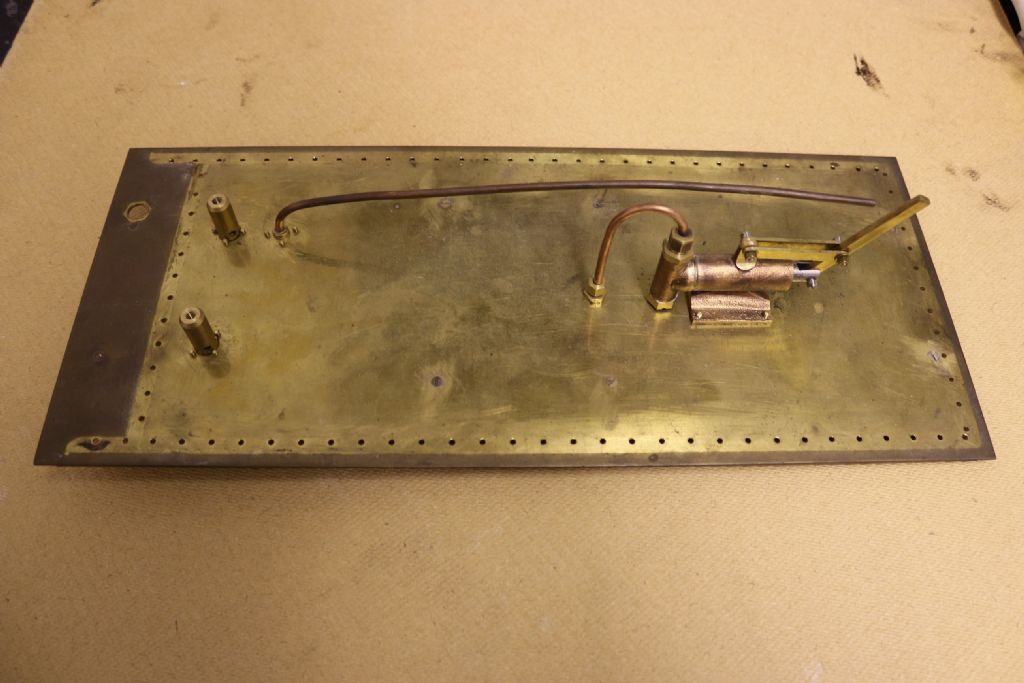

                              #440273
                              Phil H1
                                @philh196021

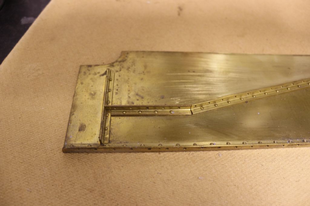

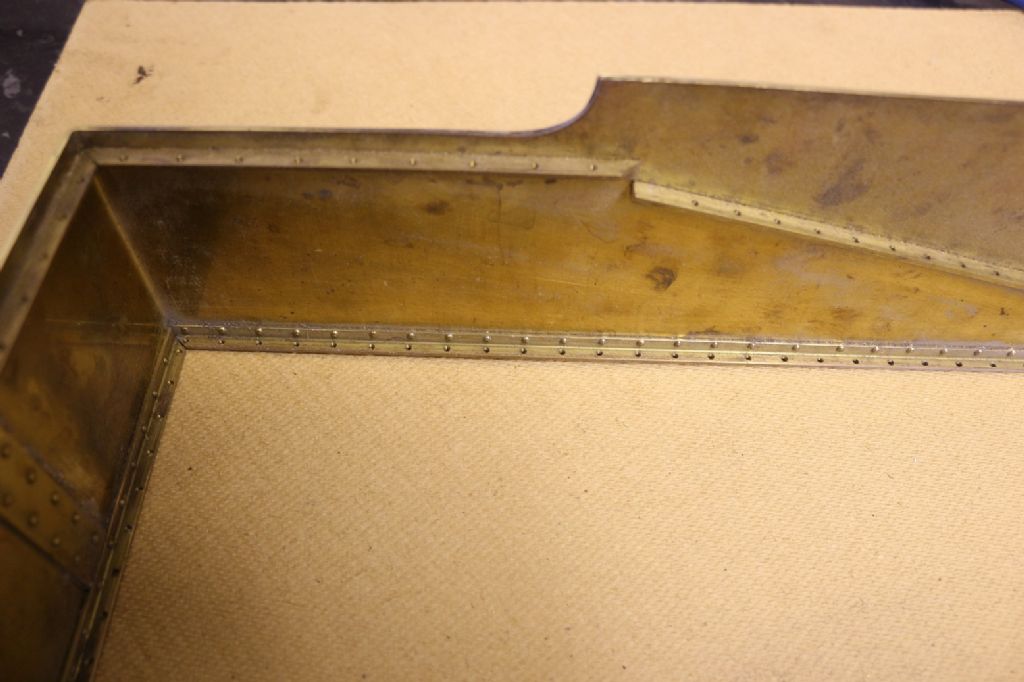

                                A few more pictures of the platework showing the internal riveted angles, the sole plate with a huge number of countersunk holes and the removable top section. The platework has been put together quite nicely in my opinion. It just needs a little bit of tidying. Note that any soldering will need to be done with care to prevent loss of the already soldered half round beading.
                                I will experiment with the removable top to see how it goes. It might not be so clear from the pictures but the pump access hole surround is a little bit twisted. I know that I am being a bit pedantic because you can hardly notice the twist but I think trying to straighten it out will be a good starting exercise.tender 1 - copy.jpgtender 2 - copy.jpgtender 3 - copy.jpgtender 4 - copy.jpgtender 5 - copy.jpg

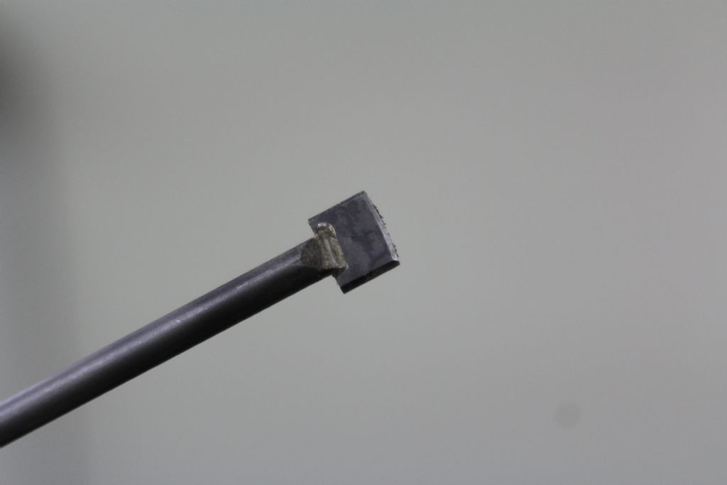

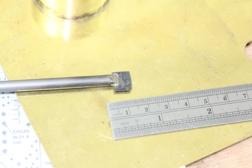

                                    Here is is the little tool i use to clean up after soldering. Its a little mini scraper made from a piece of 12mm wide x1.5mm thick carbide scraper blade silver soldered to a steel rod. A flat edge is put on it just like any other scraper with a diamond wheel and then run it along the joints. It works very well on flat and in corners. The solder comes off as easy as anything in nice little curls and as it's so small it leaves very clean corner joints. img_5750.jpgimg_5758.jpg

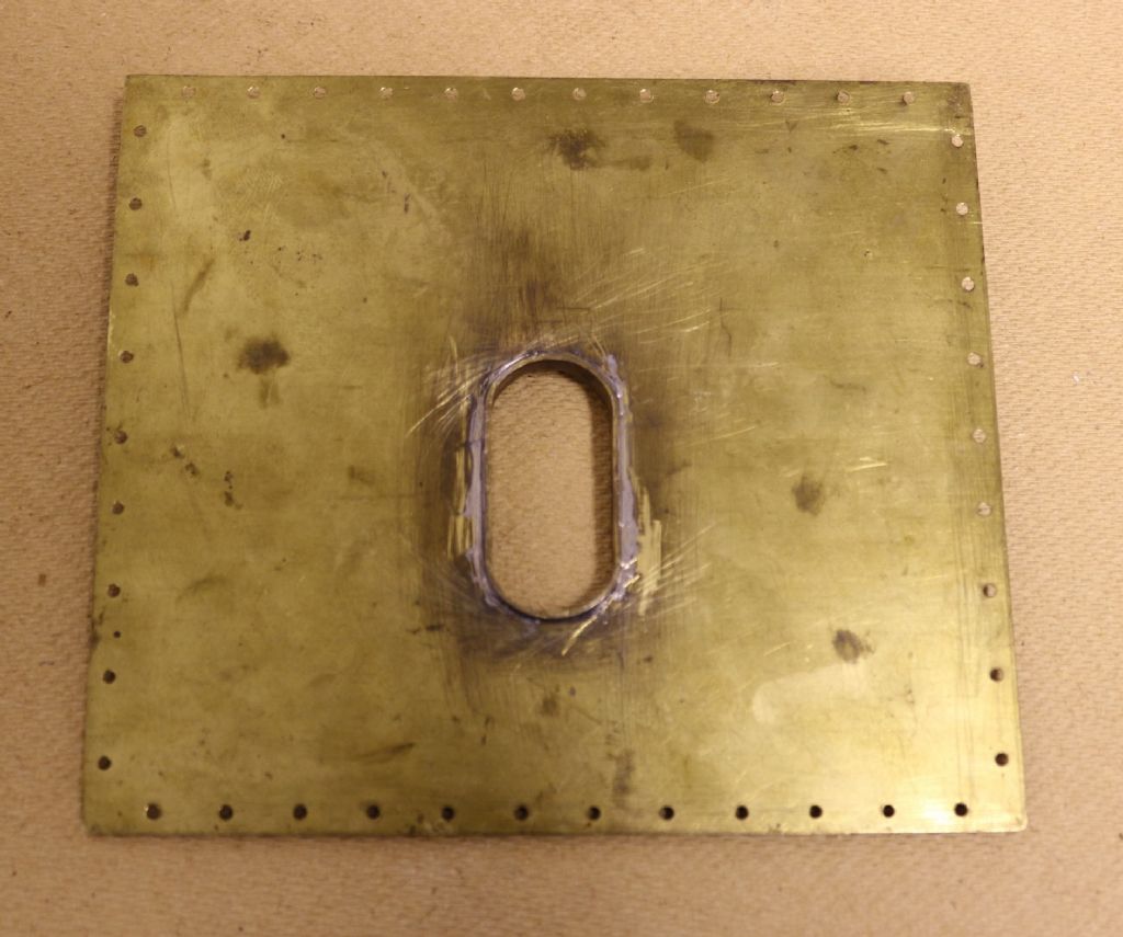

                                    #440503
                                    Phil H1
                                      @philh196021
                                      Richard, nice scraper. I might grind up an old screw driver or a piece of HSS to do the same job.
                                      Latest – if anybody is interested?…..;

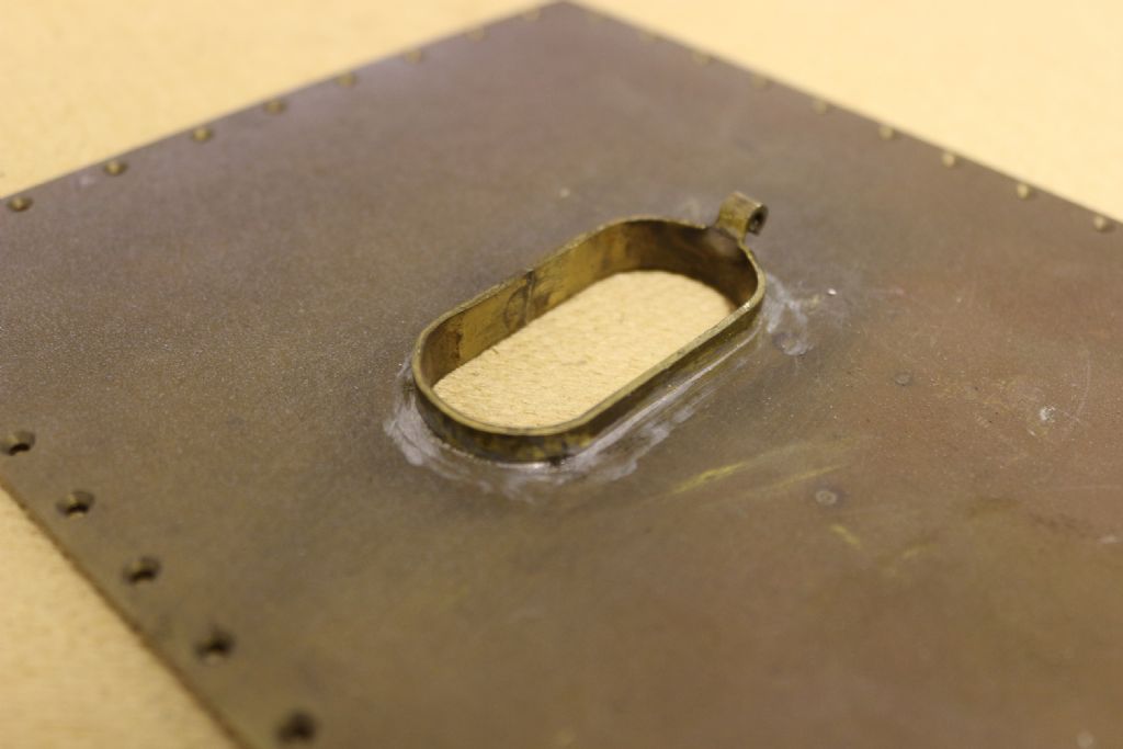

                                      I decided to leave the access hole to the emergency pump alone. After cleaning with emery cloth etc, the existing soldered joint is quite nice so I levelled the top of the hole surround with a file and polished the plate. It now looks quite nice.
                                      I did try some lead solder (180 degC stuff) on the front plate of the tender tank using a DIY, central heating type flame torch on a small flame. The good news is that my technique to clean the rivet heads and angle using emery and a Dremel went well because the solder formed nice fillets. The bad news is that even with very careful heating, the plate did distort significantly. Luckily, this particular plate is only about 61/2" wide X 3" and it was quite easy to straighten it back out using wood and a few taps from a mallet.
                                      So, for my next trial, I will ditch the small torch, buy some lower temperature solder and a big soldering iron and try again. I was lucky with the front plate. If I distort the tender sides, I doubt if I will be able to retrieve them.
                                      Phil H
