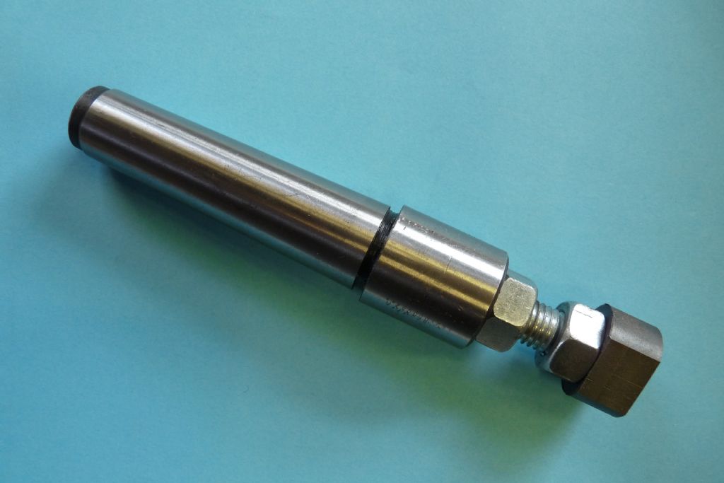

      Hi,
      I'm going to build a lathe backstop for my Boxford and want to use a shop-bought MT3 soft end mandrel for the nose piece.
      I've found apparently suitable types at Arc Eurotrade but need to know whether they're just surface hardened on the taper, or whether that part is hardened all the way through ? I will need to bore right through the mandrel to take the stop rod and also thread the end for a drawbar so if they are hardened through the body that's a no go for my application.
      Anyone drilled through one of Arc's MT soft end mandrels and know the answer ?

                Just got a new ARC one out the drawer.
                Soft in the core, up to a point.
                1/4" went thru OK as did the 5/16" follow up drill but the 3/8" drill in the picture went thru but was starting to hit hard spots at the small end of the taper.

                  Hi John, sounds like my idea of threading the small end M14 x 1.5 to suit some M16/M10 hydraulic pipe I have is a non-starter then. I'll have to revert to Plan B which is to use an M12 stud in the end of the pipe and drill through it 8mm. Shame as 10mm would have made for a sturdier stop rod and I want it for locking screws when turning them down.

                          I'm afraid so Mike. I was machining one yesterday and found that the shank is through hardened and the hardness protrudes a bit into the soft head and gradually fades out.
                          They're good for making a bit holder but not much else. You cannot drill through with normal drills.
                          If you could find an old morse shank drill it would be the other way around. You could part off the hard flutes and have a soft shank.

                              John Stevenson 1
                                @johnstevenson1
                                Posted by Capstan Speaking on 18/06/2015 16:17:36:
                                Capstan,
                                See my picture above, this is one I did today to test the current batch that ARC has.
                                All the drill were normal HSS drills but long series.

                                    Mine destroyed the edge of an HSS toolbit with 10mm of the soft end still to go. It wouldn't surprise me if they vary.
                                    I still recommend that Mike uses the shank of an old drill.
                                    Don't get me wrong though. These blanks are a godsend and I still have a morse 2 one I'm going to drill just deep enough to be a boring tool holder.

                                                I've used a number of these soft end mandrels from ARC over a period of time the first use:
                                                All I did with this one was drill and tap a 12mm hole 50mm deep to create a backstop for my lathe chucks. I didn't have any issue at all with using 'normal' drills or taps.
                                                Another application was to make a mandrel for holding slitting saws (or "Shitting Saw" as an ex- boss's PA once titled a business investment proposal), but I probably didn't drill close to the shank for that application.
                                                I have noticed that some are not as "nice" to machine as others, so maybe they are not consistently 'soft' from batch to batch.
