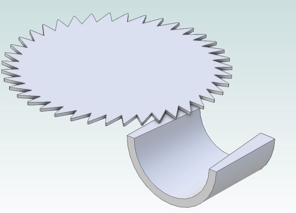

                      What is the wall thickness of your tube and how are you cutting it ? slices off or along it's length

                        #498781
                        Roger Benson
                          @rogerbenson45349
                          Posted by JasonB on 30/09/2020 18:13:04:
                          It is a tapered hole 2mm to 4mm over a 20mm length.

                              So assuming you are cutting along the 20mm length then the 40T will be OK as you will have at least 2 teeth in the cut. I would set it up so the blade cuts right through in one go, if the mill bogs down then do it in two passes say 1.5mm and then the rest.
                              Have those suggesting 100rpm noted that this is a small 50mm dia cutter so can be run faster than the more commonly use 10mm blades hence my 190rpm suggestion. [ 30 / (0.05 x 3.142)] Also though It may not apply with the 50mm saw but on the variable speed direct drive machines they may not have the torque at 100rpm to drive a 100mm saw so need to be run a bit faster than the optimum for an HSS saw I have found this to be the case on the SX2.7 with a 80mm saw.
