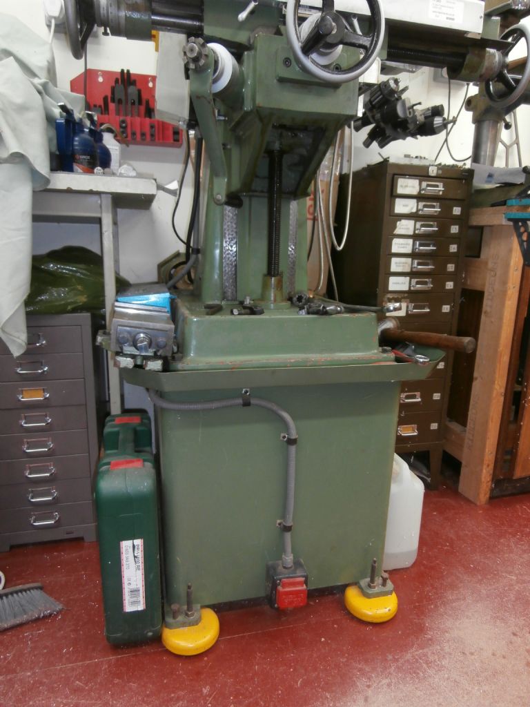

        I'm adding an emergency stop button and trying to tidy up the wiring around my milling machine, at present it looks like an explosion in a spaghetti factory. I have a 0.75 kW three phase motor driven off a vfd, so I'm guessing about 4.5 amps. (750/230/0.75 efficiency)
        I have some flex which is 24 strands 0.2mm diameter, which I make to be 0.75 sq mm. It's in free air clipped to the wall, not buried in insulation
        According to the interweb this is good for 6 amps. Does this sound sensible? Bigger means larger bend radii, which is what I'm trying to avoid

                    The motor plate says 1.8/3.3 As I'm connected in delta I assume the 3.3 is appropriate, but as it's a 3 phase motor on a single phase VFD the single phase current must be higher? Sqrt 3 comes into it I think
                    It's not speaker cable, definitely mains. Whatever is moulded into it is illegible. I've just checked my kettle lead, that is 1.25 sqmm and 10 A
                    I'm putting the estop between the plug and the vfd. It is rated AC15 230V 6A, and is intended to be very much emergency only, ie not regularly switching. I've managed for years with just the vfd stop button, but this relies on software and electronics, it just seems better to have a mechanical switch, am I being overcautious? If so it will be a lot easier to just leave well alone. I suppose in extremis I can pull the plug out!

                                                Emgee: yes there are terminals referred to as 'safety stop', but you need a 2 pole switch, and that wouldn't stop the independent table drive anyway
                                                Robert's point about 5A fuse for 0.75 sqmm cable is well made, I suspect a 5A fuse might go on inrush current. I'll get some 1.25 sqmm
                                                Finally I've tried just switching it off at the mains when going full tilt. It stops very quickly, almost as if it uses the last gasp in the capacitors to brake. This made me realise that the switch on the socket it's all fed from is easily within reach, so why am I bothering? I suppose hitting a big red button is more intuitive, and I've got it now.
